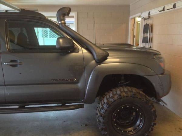

    OKAY I PULLED THE TRIGGER AND DID THE INSTALL MYSELF HOW EVER IM 50% DONE I HAVE A 2013 TACOMA SO I WENT WITH AIRFLOW AFTER I DRILLED THE 4" HOLE THERE IS A BRACKET ON THE BODY RIGHT WERE THE 90 WOULD CONNECT WITH THE SNORKEL SO IT WONT LET THE 90 SIT FLUSH IT WONT EVEN CONNECT THE INSTRUCTIONS SAY SOME TACOMAS COME WITH THE BRACKET AND NEEDS TO BE MODIFIED THE BRACKET IS A LIL THINNER THAN 3/4 ANY IDEAS ON HOW TO CUT IT. I WAS THINKING OF TAKING IT TO A MUFFLER SHOP AND HAVE THAT BRACKET TORCHED OFF?

    Airflow? As in their snorkel? If so this thread is for Safari snorkels and you may want to hit up one of their threads :notsure:
    No bracket issues with Safari snorkels. 4 bangers have a bracket in the way but it simply unbolts.
    I'd just cut it off with my dremmel or a grinder.

    Take a Dremel and a cutoff wheel and cut it out through the wheel well. If you look in my build thread (1st page is linked) I have a pic of it removed.

    i see how you cut it, mine looks to look diffrent its about 12" long and welded on to the frame i will post pictures later thanks for the info guys

    If you don't mount it I'll gladly take it off you hands like I've said before :D

    Did you ever install it? I would be interested in doing this myself since the first gen safari is a little cheaper and in a better location for me mainly because of my solenoid relocation spot.

    It looks like it's mounted on his live pics :notsure:
