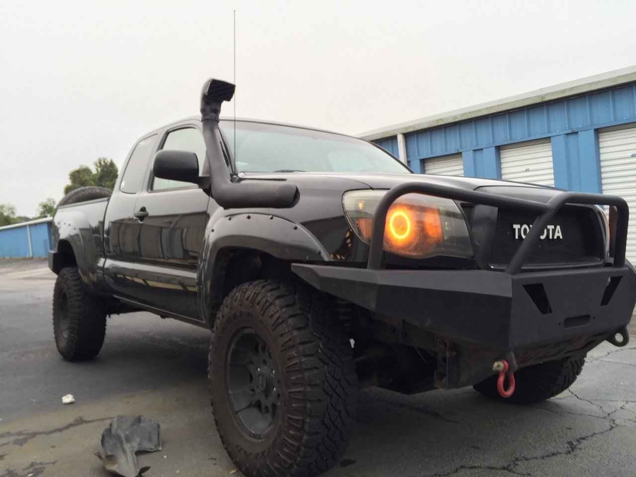

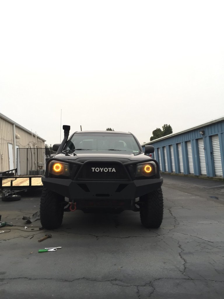

    I got the Amazon one for 130$ shipped. Install tomorrow

  10. Nov 4, 2015 at 3:31 PM

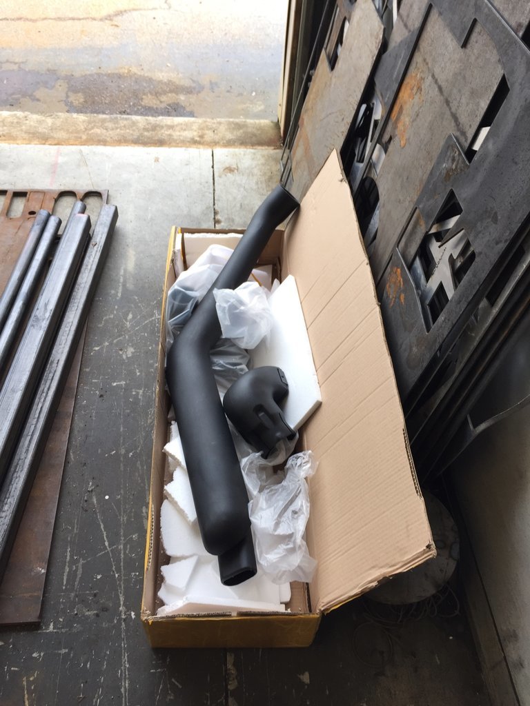

    Should be installing my Ebay china model this weekend. I'm running mine into my TRD CAI, but I actually used the same 4" to 3" fitter and was able to seal it tightly around the oval of my CAI with some minor trimming.
    This is how it's sitting in my truck right now. Like I said, I'll install probably this weekend. Reading through every thread I can find

    Dang man. I got myself a pipe bent yesterday. Get this too.
