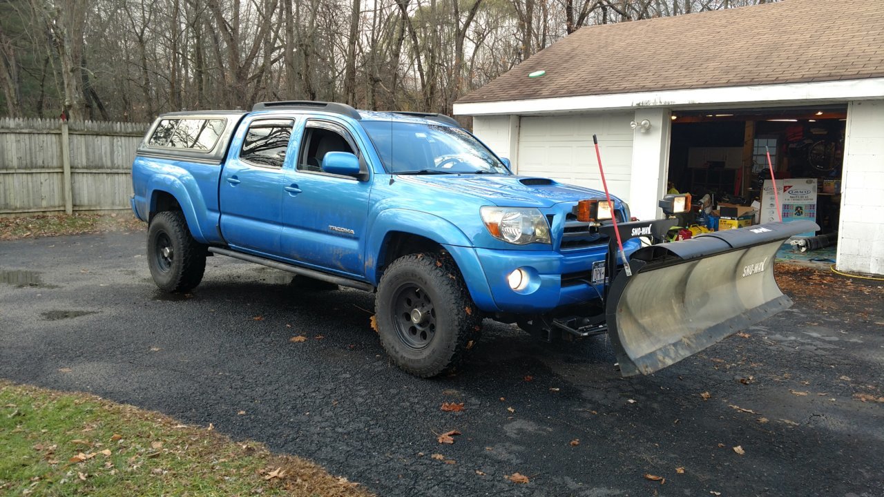

    I have a second Gen with a sno-way plow. The only one with down pressure that I know of. I've used it for 5 or so years now. Love it and it's done awesome and the truck has done just fine. I make sure to stay ahead of large snow drops, especially because I used to plow up hill. I have a lift and 285's so I have since run stock size snows for the winter to keep the plow mount low enough. I don't know about 3rd gens, but you'd probably want to add something like timbrens to be able to take the extra weight. The plow is 285# + the weight of the frame.

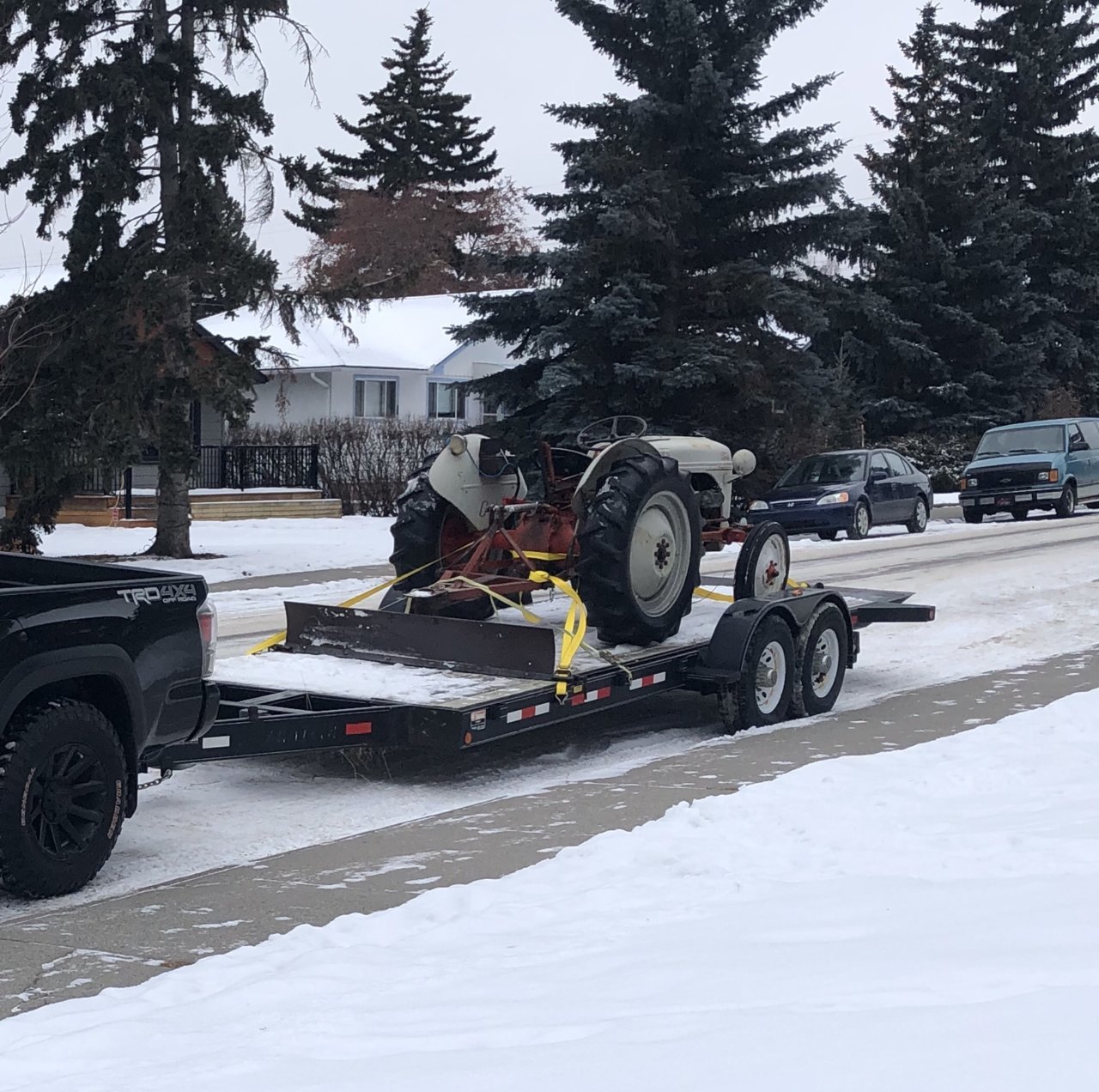

    Everyone should have an old ford 8N with a plow on the back. Works great with a 100metre drive way in Canada as well in the city. You can drive around the neighbourhood and plow the side walks. also easy to get parts, easy to work on if need to. In 10 years of owning this, I have change fluids. Starts every time 6v and all.
