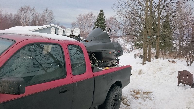

    couple years ago i made a sled deck to get up above the humps outa 4x4 2x4 and a 4'x8' sheet of plywood.
    i cant be bothered with it anymore so i just let one ski ride up on the hump.
    sorry this is the only pic i could find.

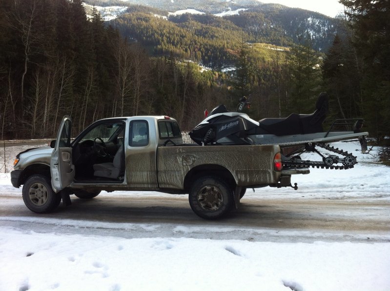

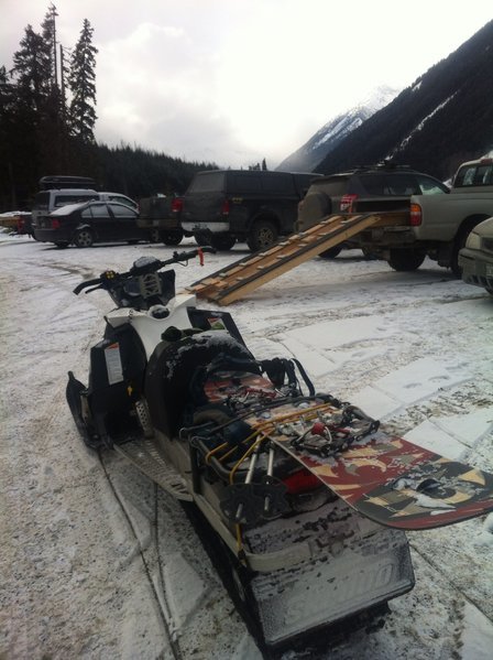

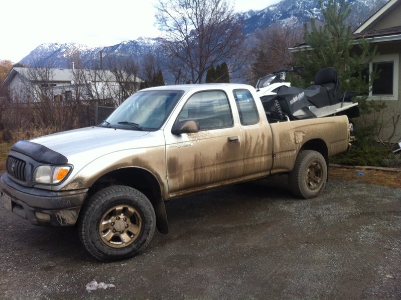

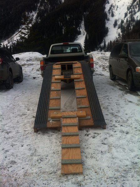

    Well thought I would follow up a bit on this. I didn't build a cantelever style deck. I just built a box for it with a few mods to make it a little better for me.
    Main difference is I can't fit my sled between the wheels, so I changed the design slightly. Sled is a skidoo expedition. Basically, I built a simple plywood deck, but it sits level with my wheel wells or just slightly below. I built the box in a "T" shape with the back half being wider to fit the ski width, and the front fitting between wheels. I wanted it this way as opposed to building it higher overtop to keep the sled lower in the truck. I didn't want it sitting super high.
    I also made the ramps quite long, about the same length as the truck box plus the tailgate. This way I can crawl up the ramp slowly. Ramp is held to the box with a 1/2" length of barstock which was heated and bent on one end for easier use. The wide gap between the ramps hasn't been an issue. It's just what I had to do to accomadate the lower deck height and wide ski stance. I am going to add two wood cross pieces that drop into slats on the ramp to prevent any issues with ramps kicking out or sled sliding between the ramps.
    I have loaded and unloaded about 12 times so far and it has been super easy. I can basically crawl up and down the ramp with very little throttle. When the sled is loaded and ramps are stowed underneath I secure them with straps hooked from the sled.
    I used an old truck bed liner for the skis, being careful to fully cover any wood that could catch the ski carbides.
    One disadvantage that's fixable but I overlooked is when you line the bar up with the holes in the ramp and deck, it won't line up unless the ramps are sitting on fairly level ground. So if you wanted to lay the ramp ends on say a snow bank, it won't work. So I need to address that, but it's a minor issue where I go.
    Attached a few pics. I use this sled as an access sled, so I still end up ski touring up the steep areas. But it's been a helpful tool for my ski trips.

  13. Mar 10, 2017 at 8:20 AM
    KGN
    KGN [OP] Well-Known Member
    Sep 14, 2015
    #164243
    62
    2001 Tacoma 2.7L 4x4
    I added a little kicker to the ramp it makes loading easy on iced parking lots ect, and keeps the ramps from kicking out. So far so good with the ramp. Easy build. See how long it lasts.
