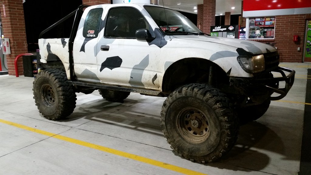

    After that, Jimmy bought the truck and it got a bed back and turned snow camo

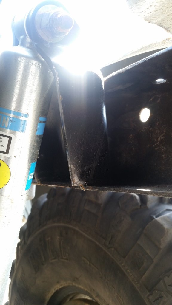

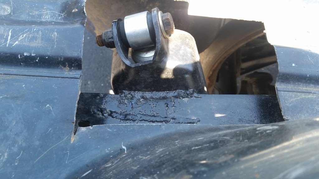

    So my previous upper shock mounts were setup to just be temporary after f250 towers went on backorder. But much like many things on many people's rigs it became semi permanent...until my frame finally cracked at the mount and I gave in with the f250 towers.
    I chopped them down to the appopiate height and angle to not bind things up. Really not a difficult job and the versatility of the f250's is awesome. I'd gauge it about a 3 hour and 6 beer job.
    Don't mind my shitty repair job where the frame was cracked :luvya:

    Sweet, nice job on angling them. We didnt on mine and realized it after we burned them it and my shock body hits the mount. That what we get for drunken fabbing! Love those shock towers, people can take their Artec and ballistic fab towers and shove em LOL!

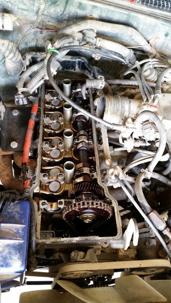

    Before I take the bed off and do some major surgery to it I took care of some little things that were bugging me from day to day.
    First was fixing the wiper transmission. It had always been crazy sloppy since I bought the truck and had gotten to the point that the arm would fall off the motor if you went up a steep hill. $50 on a doorman trans and its as good as new.
    On my week long wheeling vacation I figured out that my newly restored AC would make the truck overheat when stopped on a trail with it running. New Aisin fan clutch and all is well again.
    The truck had developed a cold start miss over the last month or two and was not idling super smooth. I thought it may be a hg but everything checked out there. Decided to check the valve lash and found 2 exhaust valves with zero lash and the rest under spec. Bingo. Ordered up new shims from Toyota to bring things into spec and solved everything. Only about a 3 hour job aside from waiting for parts. Scared the hell out of myself after I went to start it and forgot the breaker bar on the crank bolt :rolleyes:

    Im jealous of your timing chain!! How much dirt did you get in the engine?

    Stock-ish
    I'm jealous of your 40 extra hp!
    Not as much as you'd think, plus it's got like 320k on it so I'm sure the tolerances are loose enough now to deal with it :D

    I cant even take the oil cap off without crap falling in the engine. Mud sucks.
