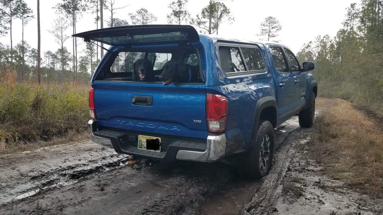

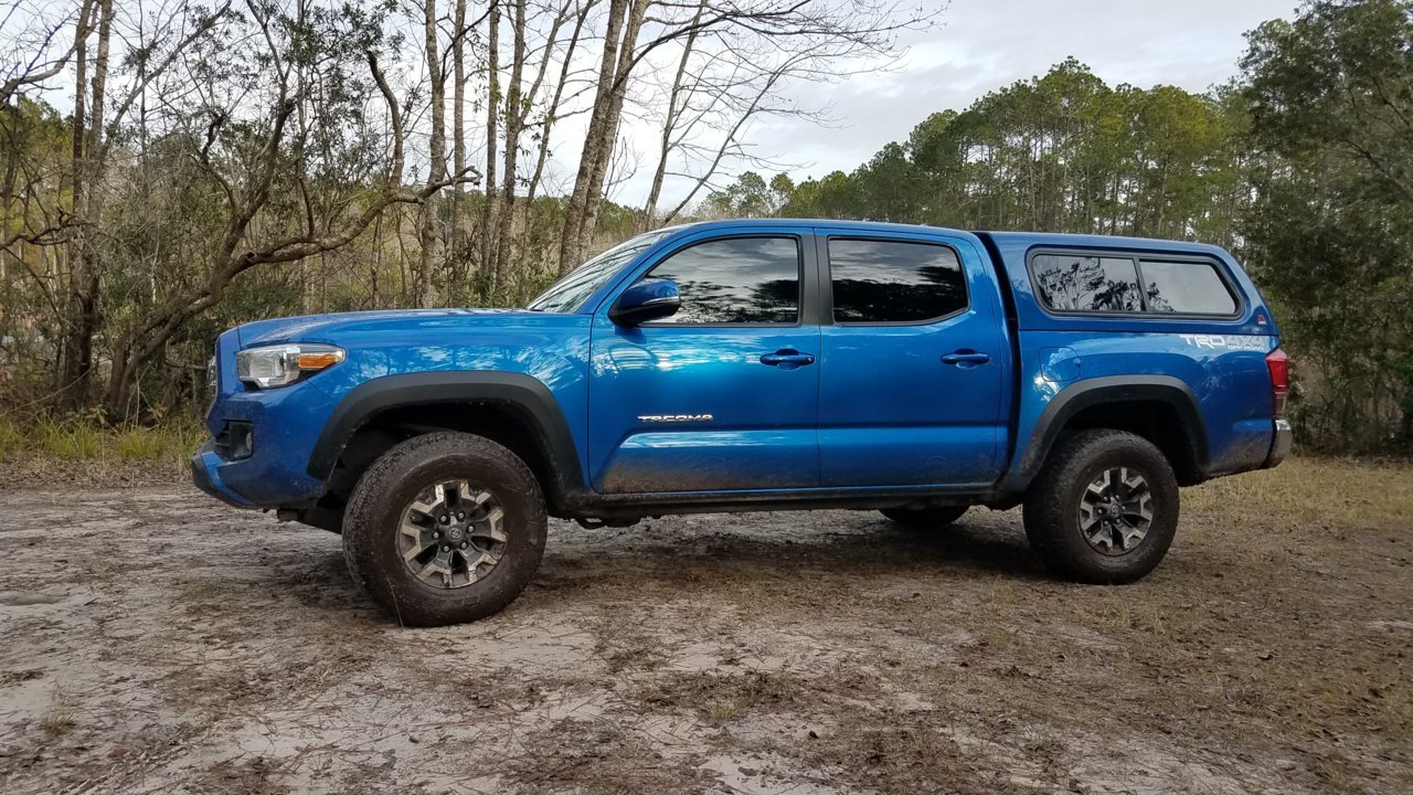

    Leer 100xr here, no mods (have duratracs now though) and everything is fine. No squatting that I have noticed.
    Make sure you get the special dog screens if you plan on keeping the pooches back there. I also went for the removeable window but its been 3 years and have not had to clean it yet. My biggest regret was not having a roof rack installed from the factory.
