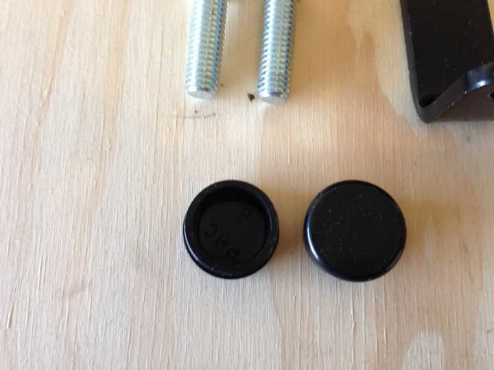

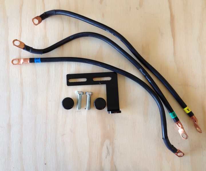

    I have no idea what these caps are for and the instructions do not address them at all. If you know what they are for, please let me know.
    first off the truck looks awesome! and i believe these are grommets so if you cut a hole to run wire these will fill the hole suppossed to make a clean install but not many people cut holes and use them..

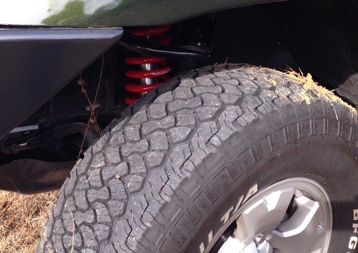

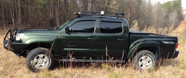

    Hello everyone, this is an update on my vehicle:

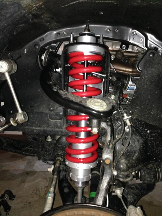

    After the installation of the ARB bumper and the Warn Winch, I immediately noticed the 200 added pounds to the front end. When I touched the breaks, the nose of the truck dived down. Taking curves, the springs loaded heavier and recovered later. A considerable amount of sway was detected when shifting the steering wheel left to right quickly. All of these things were expected. I later discussed with several members of TW what options I should look at for a lift kit that would provide very little lift but stabilize the front end. Overwhelmingly, I was recommended the ToyTec Coil Over (TTAFCS-6005).
    I purchased this lift from Toyteclifts.com at $819.99 ($859.65 w/ shipping).
    http://toyteclifts.3dcartstores.com/ToyTec-Coil-Overs-FJ-03-UP-4Run-05-UP-Tacoma_p_13.html

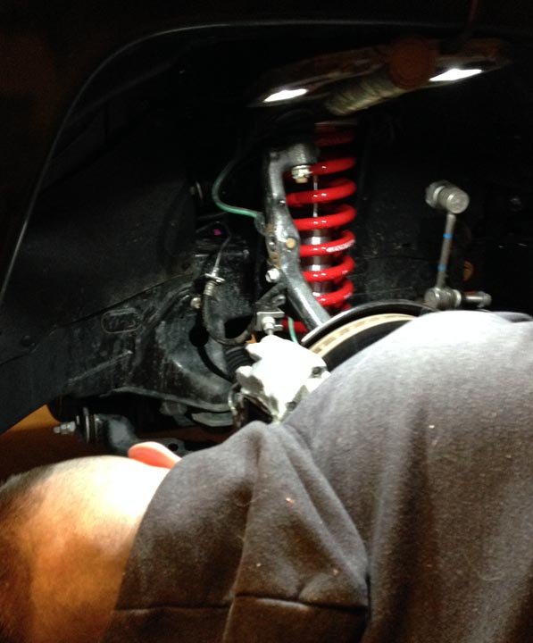

    This lift is strictly front end Coil Overs and spacers. The lift is adjustable with the two supplied spanner wrenches (Although I am uncertain how to make precise adjustments or the specifics of wheat each wrench does at this time). Installation was straight forward and took about three hours with DAC and I working on it. We did not follow the directions and were still successful.
    Tires and wheels are on my list but it will be a long time as I expect to fully wear out these tires before I replace them.
