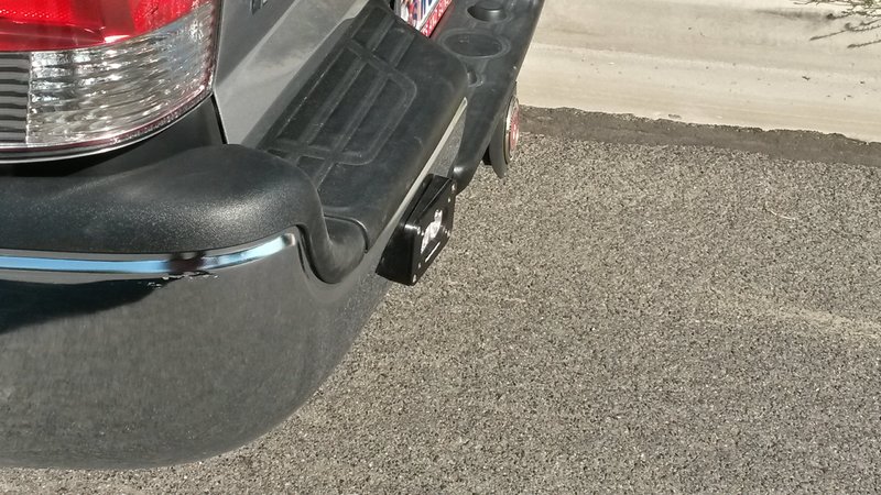

So I got this and put in everything exept the reverse lights?

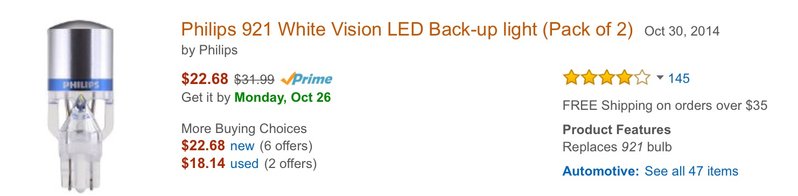

    After several weeks with the Philips, my observations are as follows. I'm torn. The incandescents light the area directly behind the bumper much better and more effectively (~6 feet). But the Philips LEDs have much more reach (impressive if you get out and look behind the truck). As far as brightness goes, the two bulbs are similar. It's not at all a case of "wow, these LEDs are awesome". There are times I like the longer reach. But other times I wish I had the better lighting closer to the truck. Another note on the longer reaching LEDs, they're effectiveness in the reverse camera seems to be affected by surrounding lights (street lights, etc). They are great when it's pitch black outside. But the on screen image seems a little washed out when there are other lights around. In that case, I think I might actually prefer the incandescents. It's a toss up I my mind. Just don't expect to be wowed.
    The incandescent silverstars are a marginal improvement over stocks, albeit an improvement. And a super cheap and easy mod, so why not, if you're not doing anything else. Again, you won't be wowed.

    I agree, it's great to support members. But I went with the Philips simply because they were $23 and free returns if I didn't like them. And I wanted them in two days. Sometimes Money/time is tight. Cheaper than jumper's but not as good as jumpers (pretty sure his were more $$). People need to find what works for them. I just didn't wanna gamble on something I wasn't sure about. But yeah, TONS of people really happy with jumpers lights.
