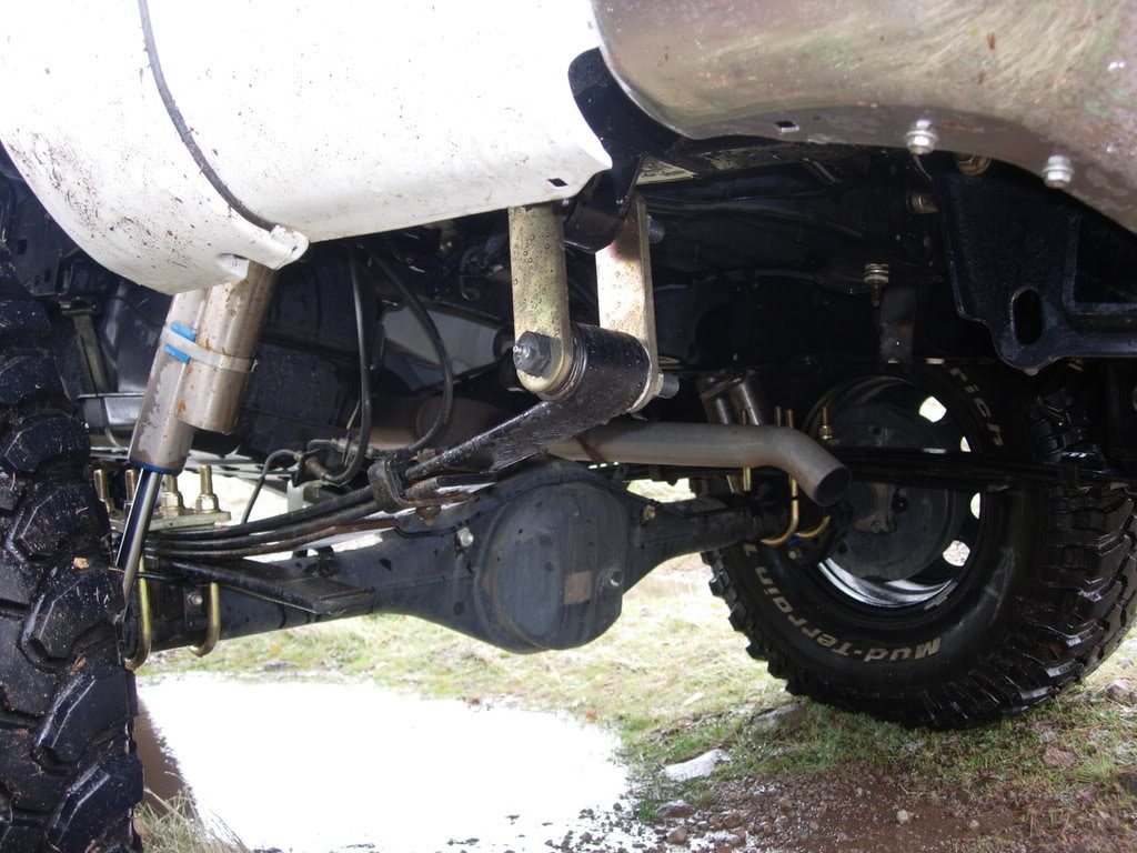

    I didn't think we could do shackles on these trucks the way the rear leafs are mounted? :confused: Unless you mean after cutting off the stock leaf mounts and fabbing up some custom ones?

    oh i dunno i just kind of assumed yall could run shackles too

    Oh right, you have an older gen one! :laugh: Yeah, our mounts are f'd up. The leafs go over them and it's a large bracket that would need to be cut off the frame, flipped, and remounted before a new shackle would lift the truck.

    ^those had to be custom made. The stock setup wouldn't allow that, and would have to be removed first. As in, cut off since they are riveted on by the factory.
    Nice pics though! So it can be done if you know how/where to get them.

    so the newer gen trucks spring hangers are welded onto the frame on both ends of the spring?
    thats pretty lame...i wonder what caused that brain fart in the engineer's office that day
    the first gens have a shackle from the factory...just a matter of buying larger ones

    There is a shackle at the rear of the new ones. It's just that the floating end is above the fixed end, so longer shackles will effectively lower the truck.

    Not welded, but riveted on with the factory 1/2" rivets so cut/drill them out...
    Yeah. that explains it better! lol
