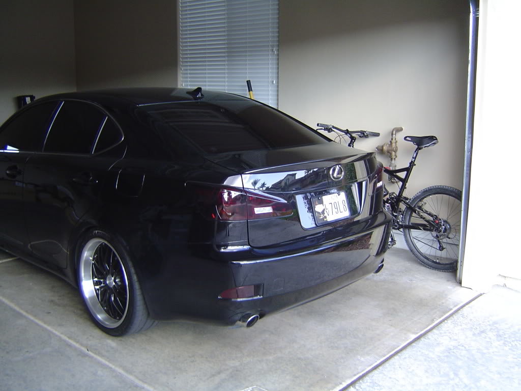

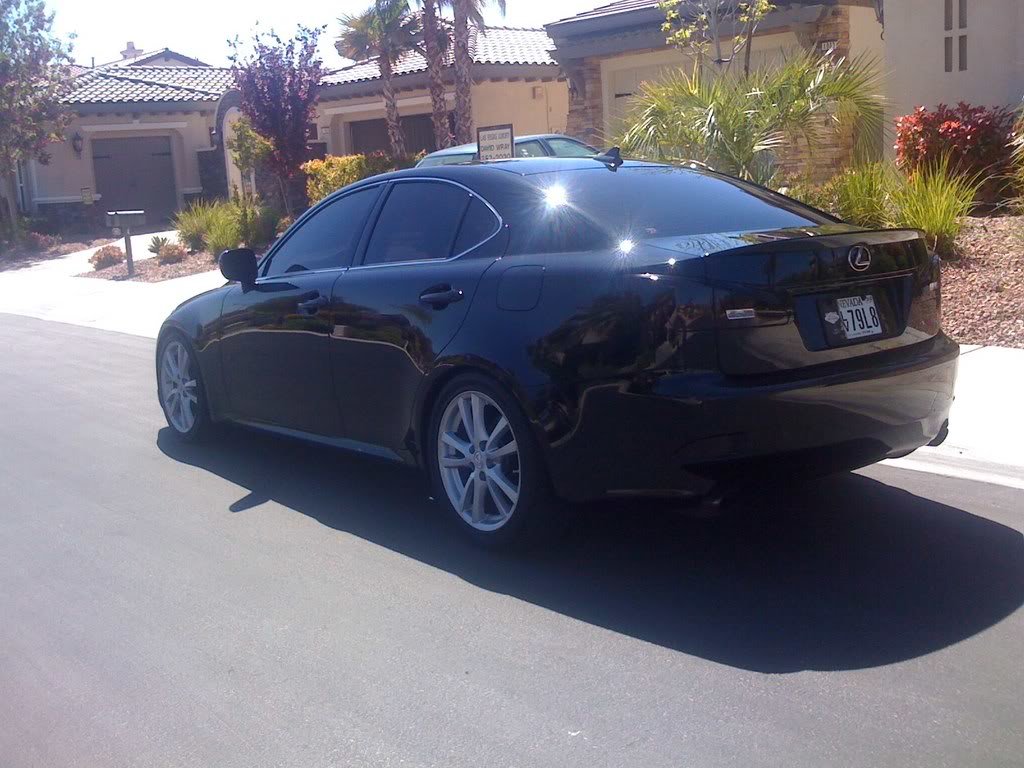

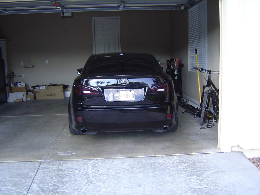

    Finally, I got my pic's of my TL's that i did. The 3rd one is with a flash. That's why its so light.

    I would not worry about it, those look good.
