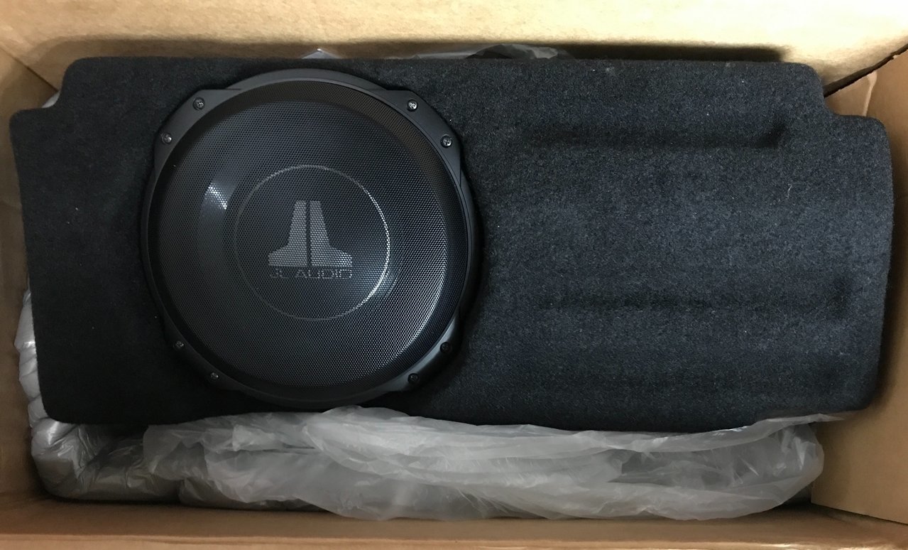

    Also interested in that Crutchfield sub. Can it be added without mayor modifications to the stock radio?

    I have this:
    https://www.crutchfield.com/p_13693334/JL-Audio-ACS110LG-TW1.html?tp=114
    Behind the rear seat, passenger side. Had the shop install it. Trimmed the plastic rear panel slightly and the seat back closes with the slightest bit of pressure. Hits deep for a sealed box. Remote gain control is in the console. Really happy with the outcome.
    I can get a pic when it stops snowing.

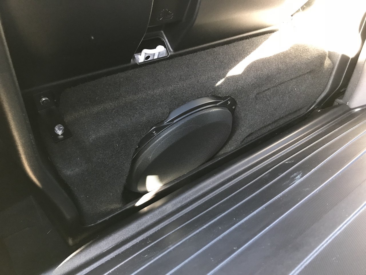

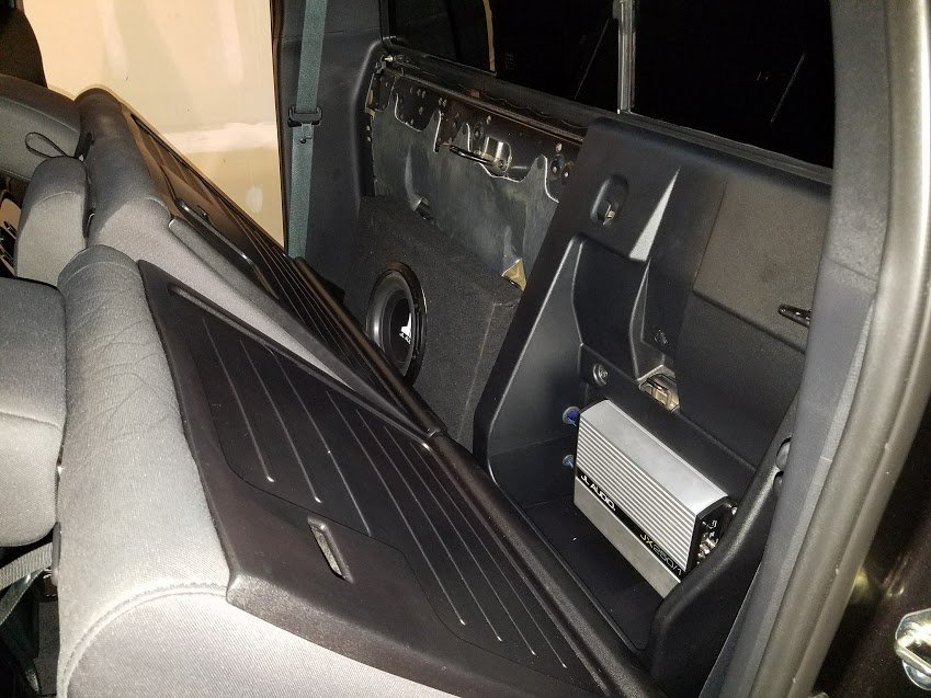

    Jl stealth box and having mr marv build you a custom box is your two best options. I removed my rear seat organizer panels had mr marv build me a 10” box that perfectly fits behind passenger rear and under power window motor. Then i ordered “group buy 7 molle panel” to fit Around the subwoofer to attach storages pouches to. Gonna be awesome. There is plenty of info on here how to add a sub. Do it. Just buy once dont cheap out.
    You will need a:
    -Amp with hi level inputs or
    -amp with line in converter like lc2
    -shallow subwoofer
    -box
    -4gauge wiring kit
    -speedwire.
    Search for 2016 audio build in audio forum thats the best one i found

    Sundown Audio SD-3 600RMS : $199
    Pioneer GM-D9601 500RMS : $140
    Shallow box : $150+ For good quality (Marv is the man)
    LOC and Wiring : Totally depends on what route you want to take (Digital processor $60-$250 or all the way down to a simple "tap into existing speaker leads" like $10), ($50 Walmart bullsh*t wires all the way to $180 1/0 gauge OFC run)
    "Add a little bass" can be done for like $200 total on cheepo bargain stuff; it all depends on how much you appreciate the sound, quality and your truck overall.
