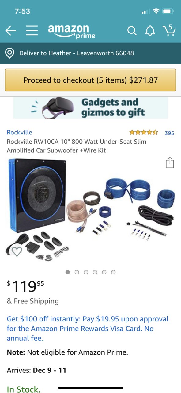

    Im looking to add a sub to my 3rd gen as well. I just want a little extra bass and don't really want to use my backseat storage right now since I use it quite often (no sort of storage add ons currently so bin storage is still a want right now). I have not ever installed subs before so this would be new for me. I have tried searching internet for this particular set up to see if anyone has installed in a tacoma yet.
    https://www.amazon.com/Rockville-SS...&sprefix=kenwood+powere,automotive,153&sr=1-8
    it has good reviews besides one recent negative one (sounds like someone got sent a used one and wrong one but didn't inspect before installing). I figured for a little over a $100 including a protection plan with Amazon this could be a nice little set up for under my front seat.
    Has anyone used this? And if so, have any install links? Thank you in advance!

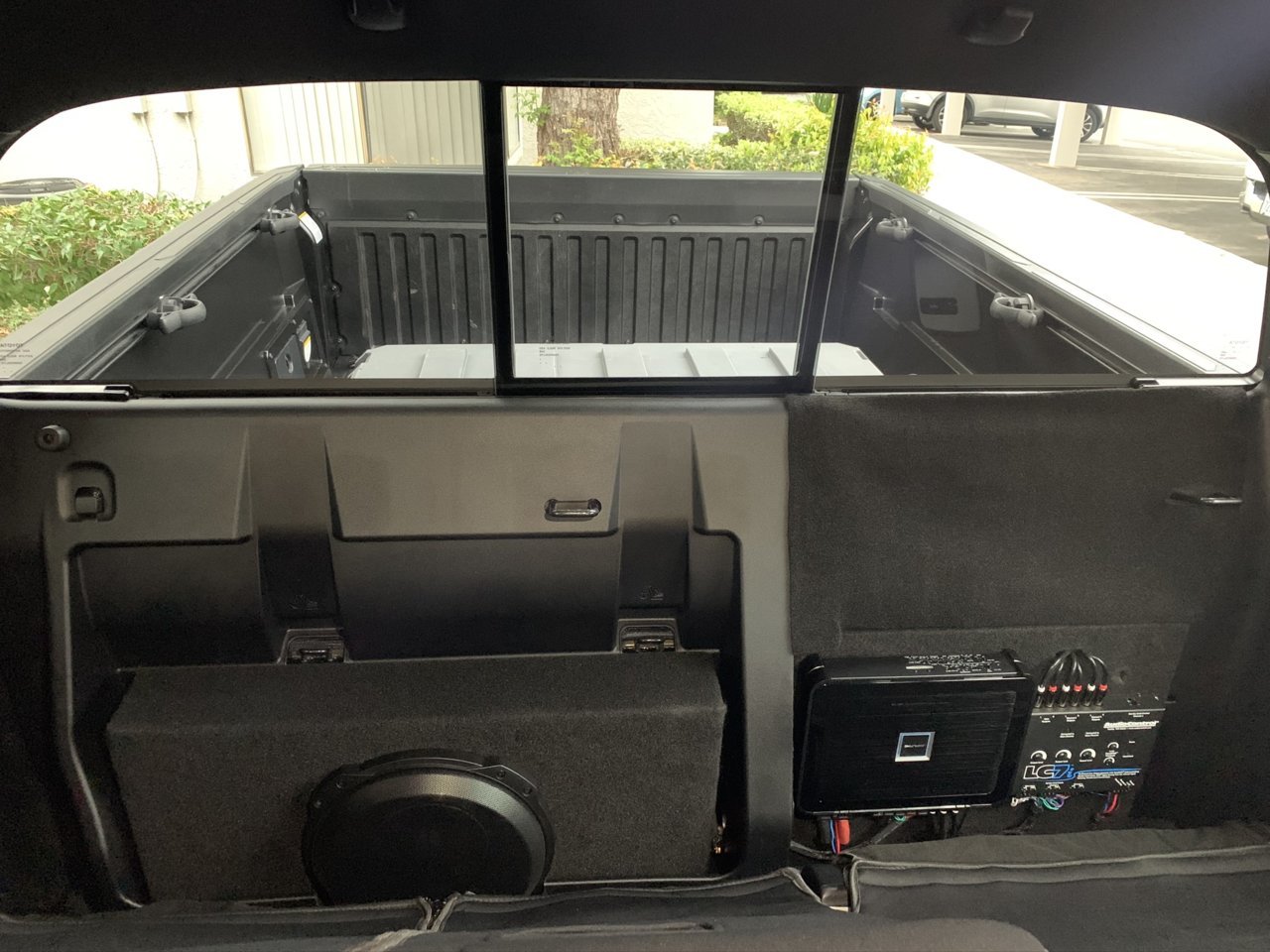

    I went with a Mr Marv box, carpeted it and through a JL 10TW3-D4 in. I was able to fit the box in the larger storage bin by cutting a half moon for the lower section of the driver and removing the plastic from the back of the seat. I added the JL grill (does not come with one) to prevent the driver itself from coming into contact with the seat. Requires a bit more of a push to lock the seat in place but it works.

    If you've ever had a real sub in a proper enclosure before in another vehicle you'll be very disappointed in that little rattle box.
    Likewise if you listen to anything with moderate bass you'll be majorly disappointed.
    For the time, effort and money you're going to spend wiring that you would be much better served getting a dedicated sub and amp with a matched box.

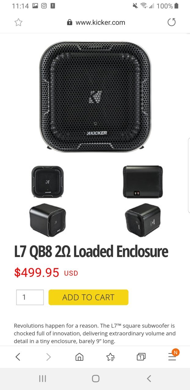

    I followed the path of least resistance..kept the factory 6.1" headunit ..upgraded my components..added a 5 channel amp and kicker 8"sub...which sits perfectly between the jump seats in the back.

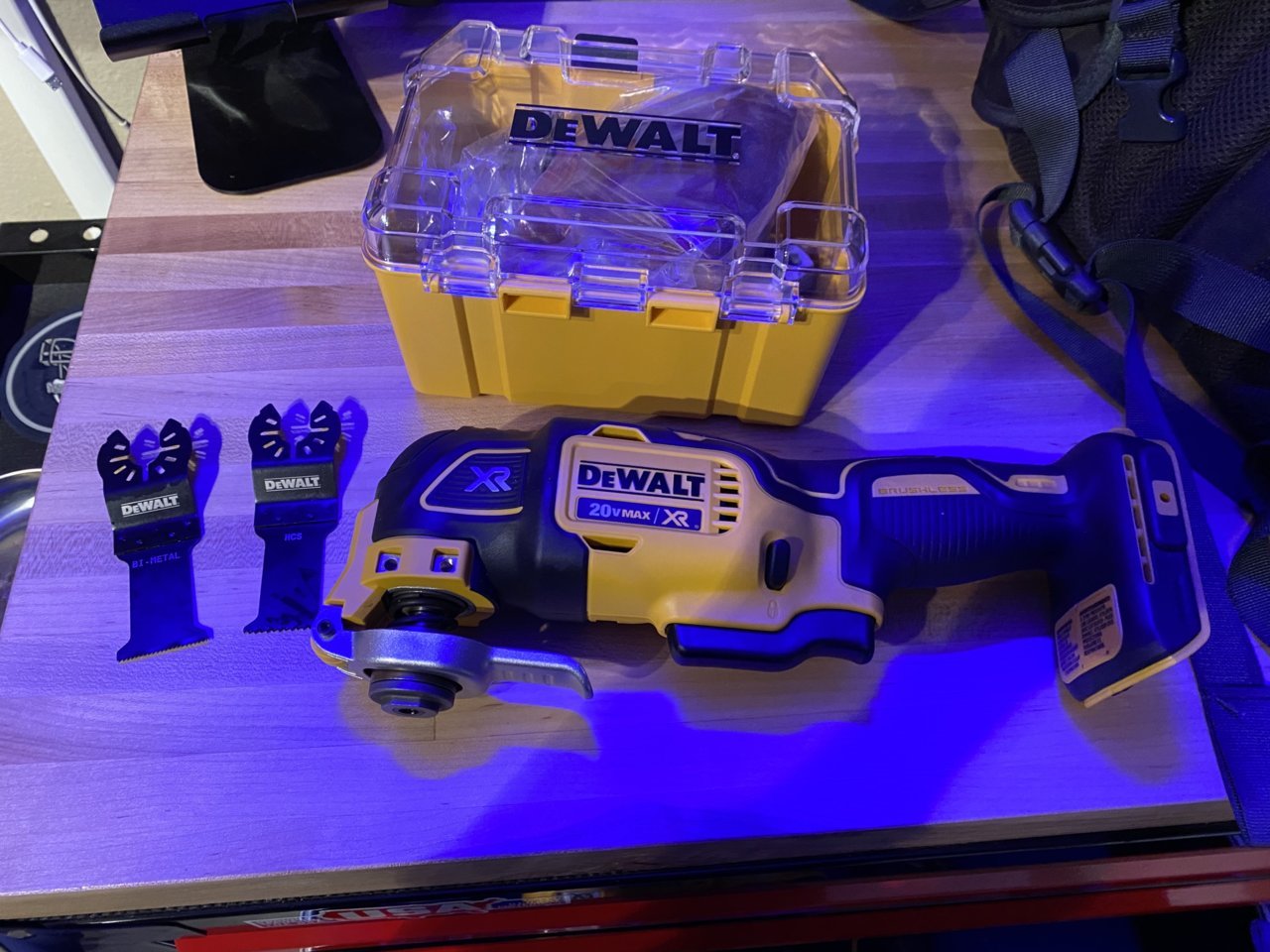

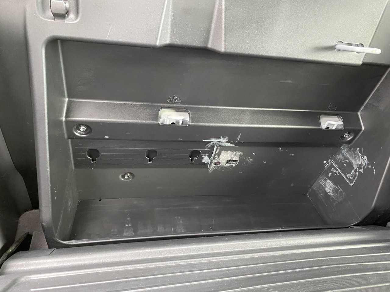

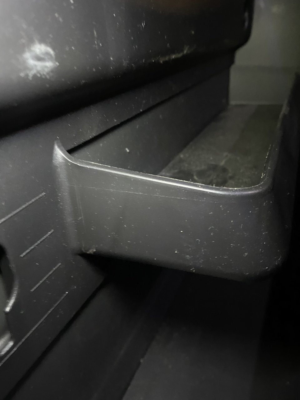

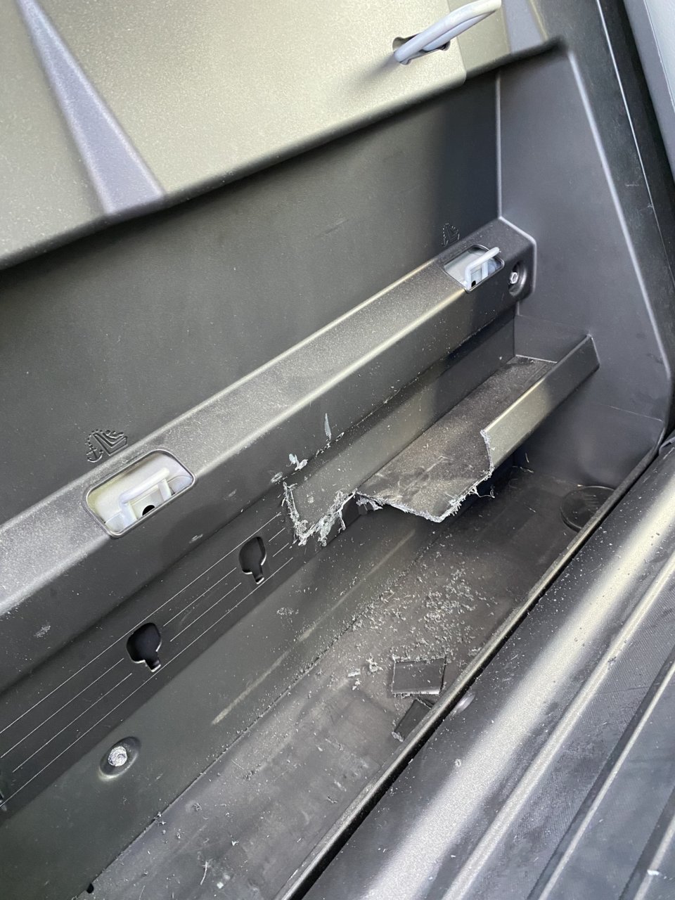

    @reloader403 and @Superdave1.0 my plastic storage area has this bin or “Ledge” inside of it that would not permit fitting of the powered sub. I bought the one that Dave has and am wondering best way to go about fitment. I have an oscillating tool. Wondering what blade is best for plastic ? Anyone have tips ?

    Sorry brother I have a 3rd gen. But if it were me, I would start cutting :sawzall:
    Try the tool you have. If that doesn't work, a sawzall, dremel or angle grinder will all make easy work of cutting plastic. Is it just this cubby that's in the way?

    @Superdave1.0 Yeah that’s the cubby Got the same sub u have is yours the 8” ? How do u like it. ? Yeah if I can remove that ledge it’ll fit nicely. Kinda hate to cut the oem material but she is also almost 12 yrs old and it’s behind the seat lol. Your truck is looking sweeet. I’m doing a big audio overhaul.

    A Dremel with a sanding drum will allow you to grind down that lip very fast..... And cuts look choppy no matter how steady the hand.

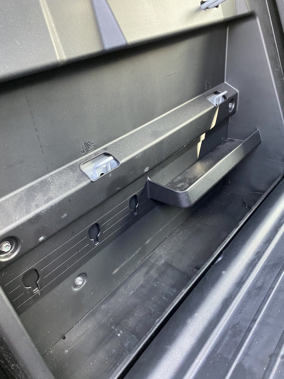

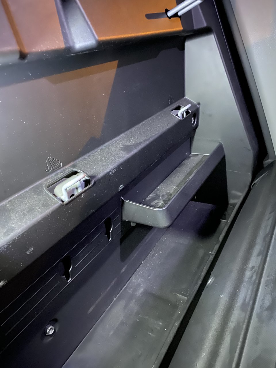

    @Superdave1.0 and @reloader403 thanks for your advice. I took to it this morning and I’ll admit I was a tad nervous cutting on my truck and it was the first time I’ve used my Dewalt oscillating tool but man if that isn’t the most handy device! I def have some rough edges but like you said you’ll prob have those anyhow. Posting pics for those in the future since I couldn’t find any of the plastic storage bin cutting process on here
