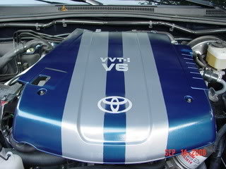

    engine cover either tomorrow or this weekend does anyone if i should use high heat paint so the paint doesn't bubble up or would rustoluem just work fine?

    Krylon paint would work the best.... Some people have put a clear coat on it as well

    Wouldn't worry about high temp paint unless you plan on perching your truck at car shows and leaving the hood up in the sun :) Good luck!

    Duplicolor automotive & clear.

    how'd you get your toyota sign and the vvt-i and such so chrisp??

    Looks good!
    What did you use to clean the surface before applying the paint?

    I just used the blue painters tape over the Toyota emblem & letters & trimmed the tape with a pointed hobby razor.
    Before taping I washed with soap & water then wiped with alcahol.
