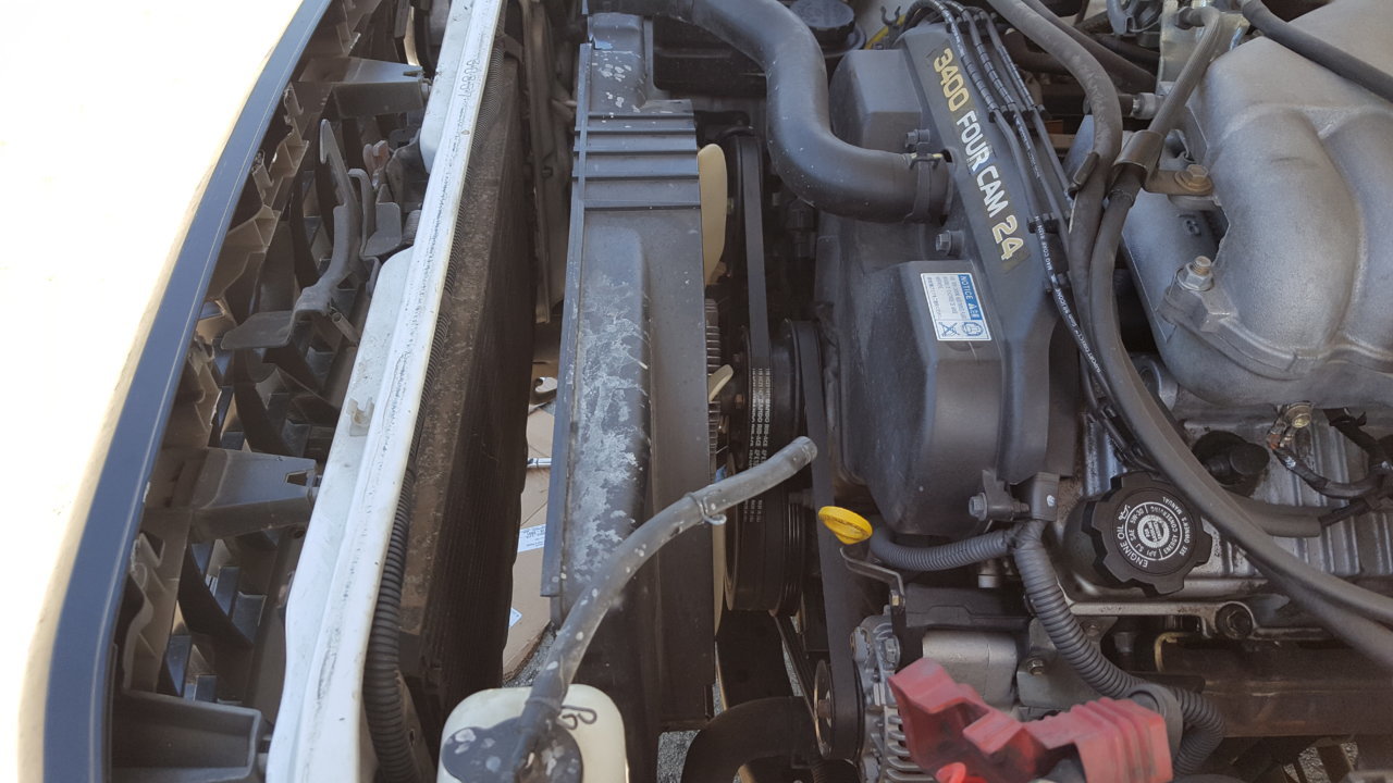

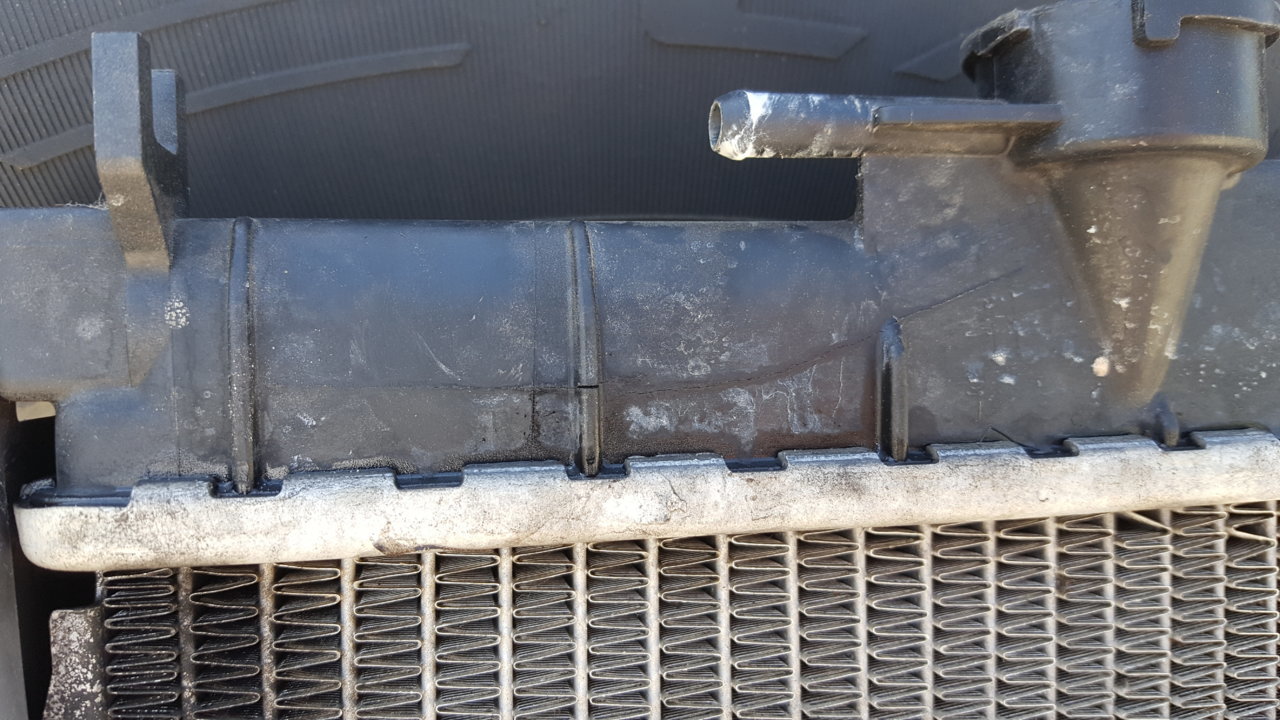

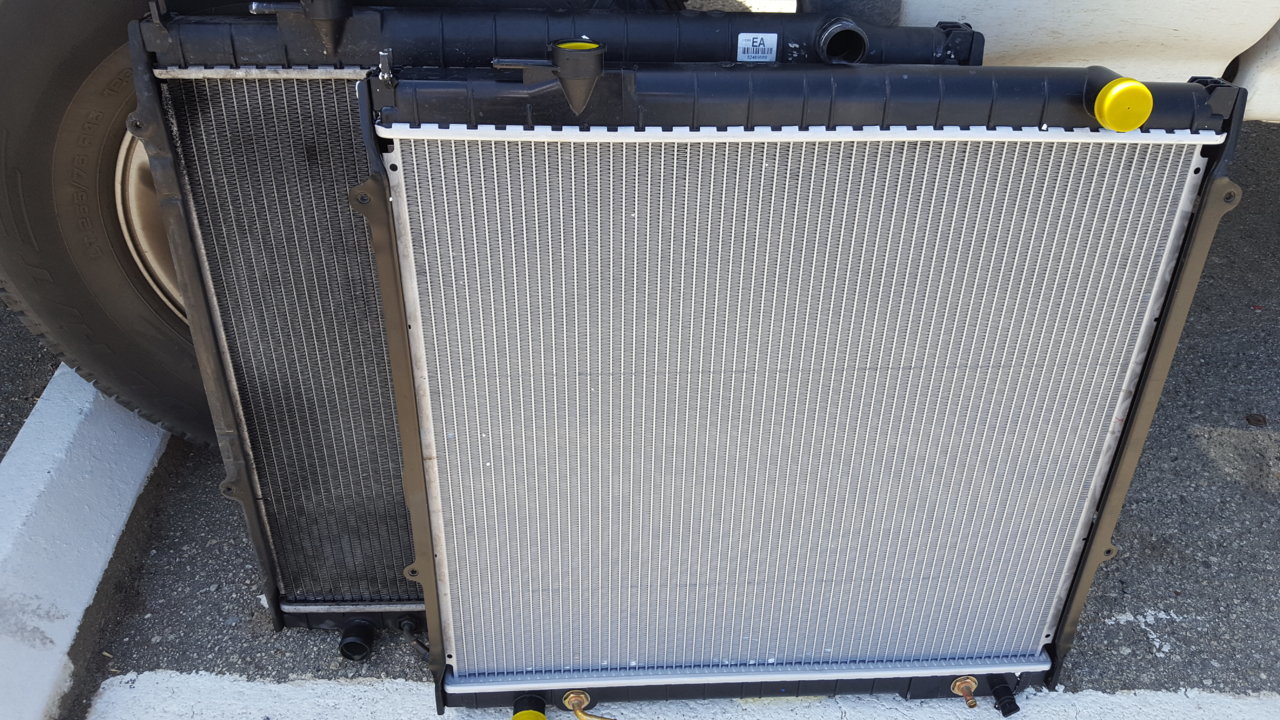

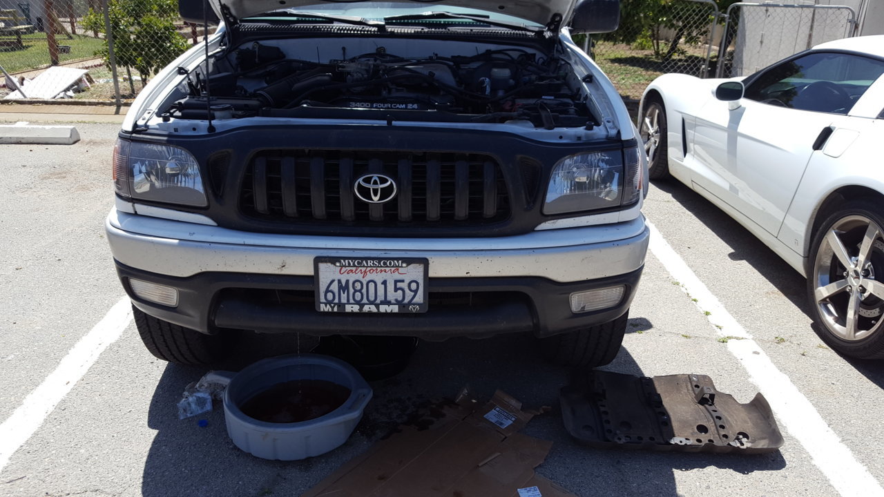

    Oh and here's why I replaced the radiator -
    The vehicle has never overheated, but I noticed that there was "dried coolant" on the radiator shroud. After inspection, I found this crack in the plastic tank. Again, the vehicle has never overheated even though it's really warm where I live, and I just replaced it as cheap insurance.
    Oh and when you swap your radiator out, you don't have to take apart your shroud -
