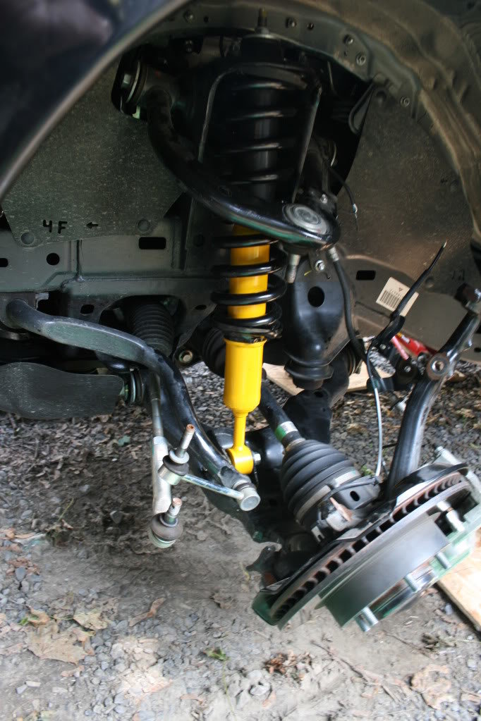

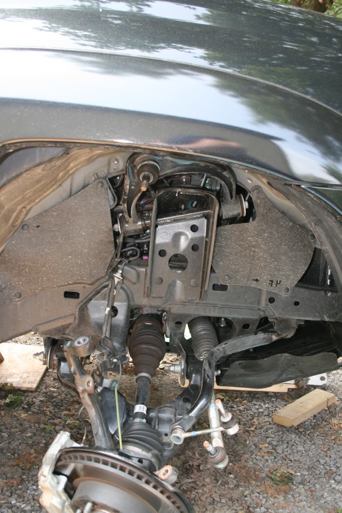

    You must have both sides of your truck lifted up and then disconnect the anti-sway bar from both sides. I just did this same thing on Tuesday for a friend. Here are some photos:

  18. Aug 15, 2010 at 4:03 PM
    #18
    Rich Beauregard
    Rich Beauregard Well-Known Member
    Sep 2, 2009
    #22179
    623
    Rich
    New London, CT
    17 Taco 4x4 SR5 Access Cab White
    Note: You have to disconnect the sway bar on both sides and push it down out of the way so you have clearance to remove/install the strut AND loosen the upper control arm bolt 3/4" so you can lift it up out of the way. Just in case anyone notices the wire hanging, It was snapped by the last guy that worked on the truck, so I soildered it and put 3 layers of shrink wrap on it.

    When I put this in, there was still about 1to1-1/2" to spare so I did not have to push down on the lower control arm. This was the OME885 springs with OME Struts.
