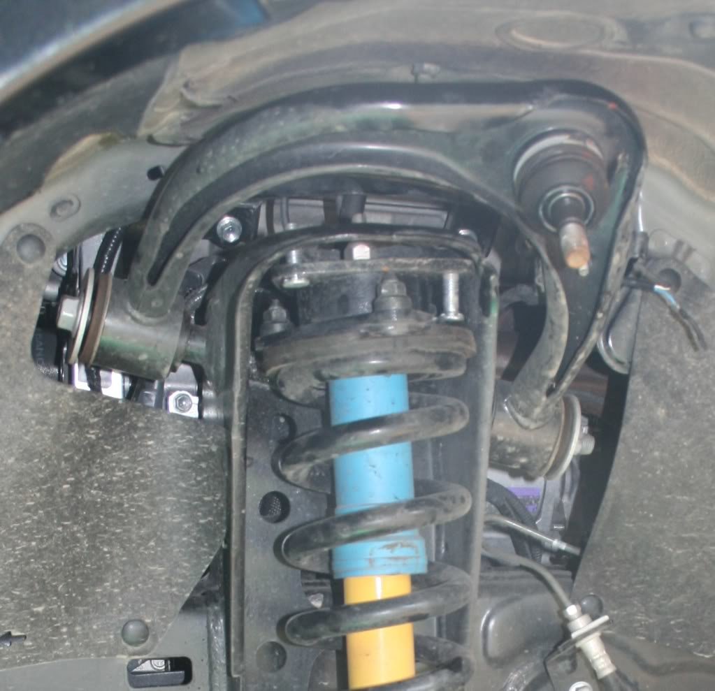

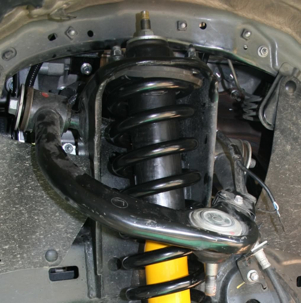

    You do not need to loosen the sway bar bolts, just the end link.
  2. Aug 15, 2010 at 4:20 PM
    #22
    Rich Beauregard
    Rich Beauregard Well-Known Member
    Sep 2, 2009
    #22179
    623
    Rich
    New London, CT
    17 Taco 4x4 SR5 Access Cab White
    More photos:
    08-10-10013B_0766b039d23b4598982e5bc3bc7224c8ae1fcdf3.jpg08-10-10005B_8bb5b1b20c469959190f002e3925e324226c28ea.jpg

    I cant thank you all enough !!!!!!!!!!!!!! Especially the pics !!! I REALLY needed the pics...Thanks SOOOOOOOO much...gonna try this on Thursday....
    If your ever in Western MA.... I'll buy you a beer !!!!!!!!!!!!!!!!!!

    Finally got the lift in my most profound and sincere thanks to all who helpd and posted on here to give me some insight especially for the pics
    Taco is ridin so much better and I'm Lovin it !!
    had some help from a Custom Taco member here in MA. Thanks to him as well for all the help.
    I'll post some before and after pics asap
