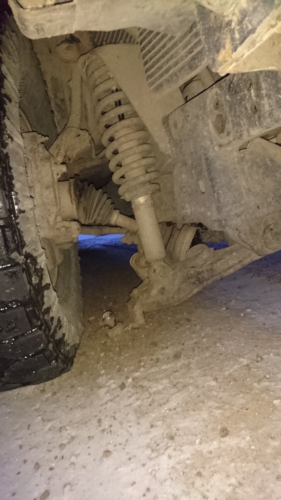

    Ok so doing about 40km on a shitty road hit a small bump and the front end dug into the ground....
    These are 1.5 year old mevotech balljoints that I Changed "just to be safe"..... cv broke out of the diff and all that....

    That balljoint appears to be dry. Were the boots ripped or was there really no grease in them?

    boots were fine apparently there junk from factory... theres 440 000 kms on this truck did the ball joints last winter just to be safe, well now i wish i used toyota parts these have 28 000 kms on them....

    Im not familiar with the brand but other aftermarket balljoints ive seen have a spot for a grease fitting that is plugged with a little bolt. Was the fitting installed and grease added before installation?

    these are non greasable ball joints.... junk stay away from mevotech

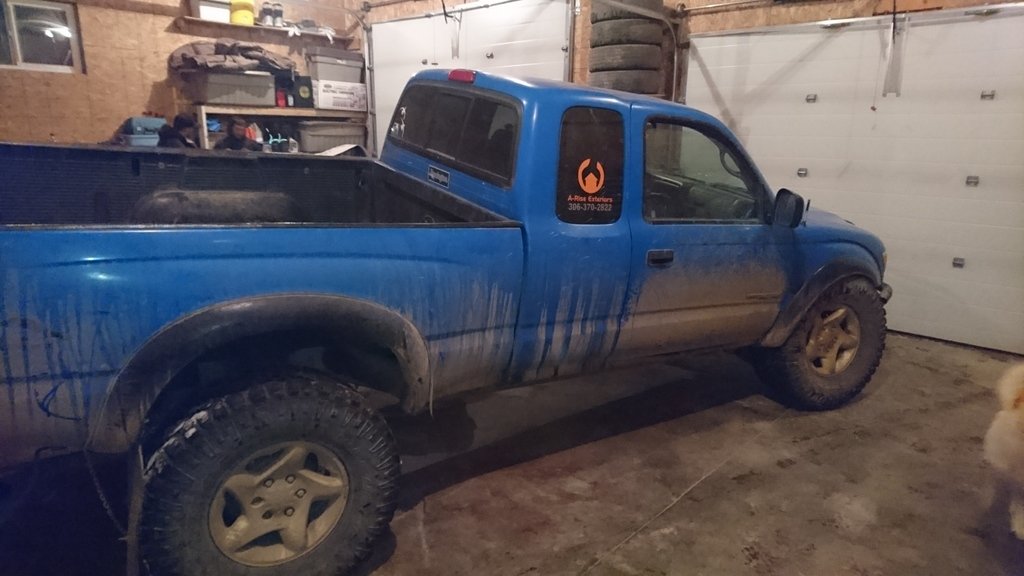

    the front fender is bent and the passenger door wont open

    well i lied i got the door open but it bent the fender in way worse

    Wsa the joint show signs of worn out and metal getting thin or did it just tear through the metal?

    The only issue I had with the ball joint was stripped bolt holding it to the knuckle.
    The ones before were stock Toyota and they had a little play so I changed them to be safe.
    The bilsteins went in the truck years ago, it's lifted and has 33's on it.
    The ball joint was completely dry and just popped out. I'm curious how I can grease the rest of them now.
