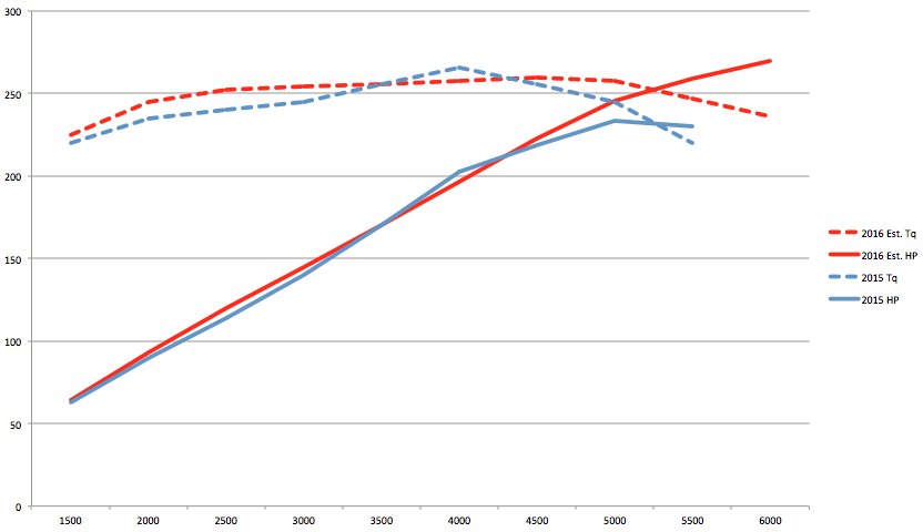

    I google image searched the TIS 1GR-FE (single VVTi) torque curve and plotted it in Excel. Then I took what we "know" of the peak HP and peak torque number and plotted them. Then I filled in the gaps to show how the bottom of the torque curve could be stronger than the current 1GR despite where the torque peaks. The 1GR peaks in the middle and isn't particularly level above or below that.
    Of course, my speculation could be totally wrong and the new engine may not have a very flat curve. My bet, though, is that they used the D4-S and VVTi tuning to keep the low end strong rather than push for high HP numbers like the 2GR-FSE in the IS350. Again, just speculation and my way of showing that there is no need to get all bent out of shape just yet.

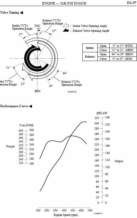

    If the Tacoma engine is based of the 2GR FSE, power curve should look similar to this:
    1GR (shows 285ftlbs :notsure:):
