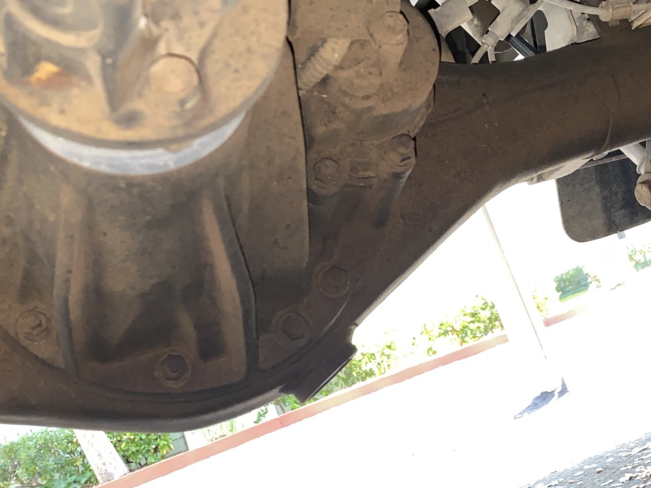

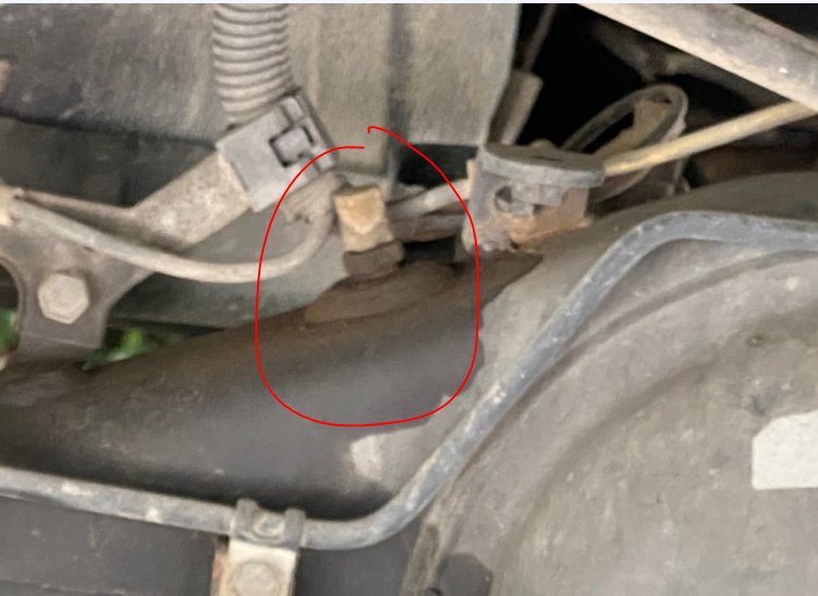

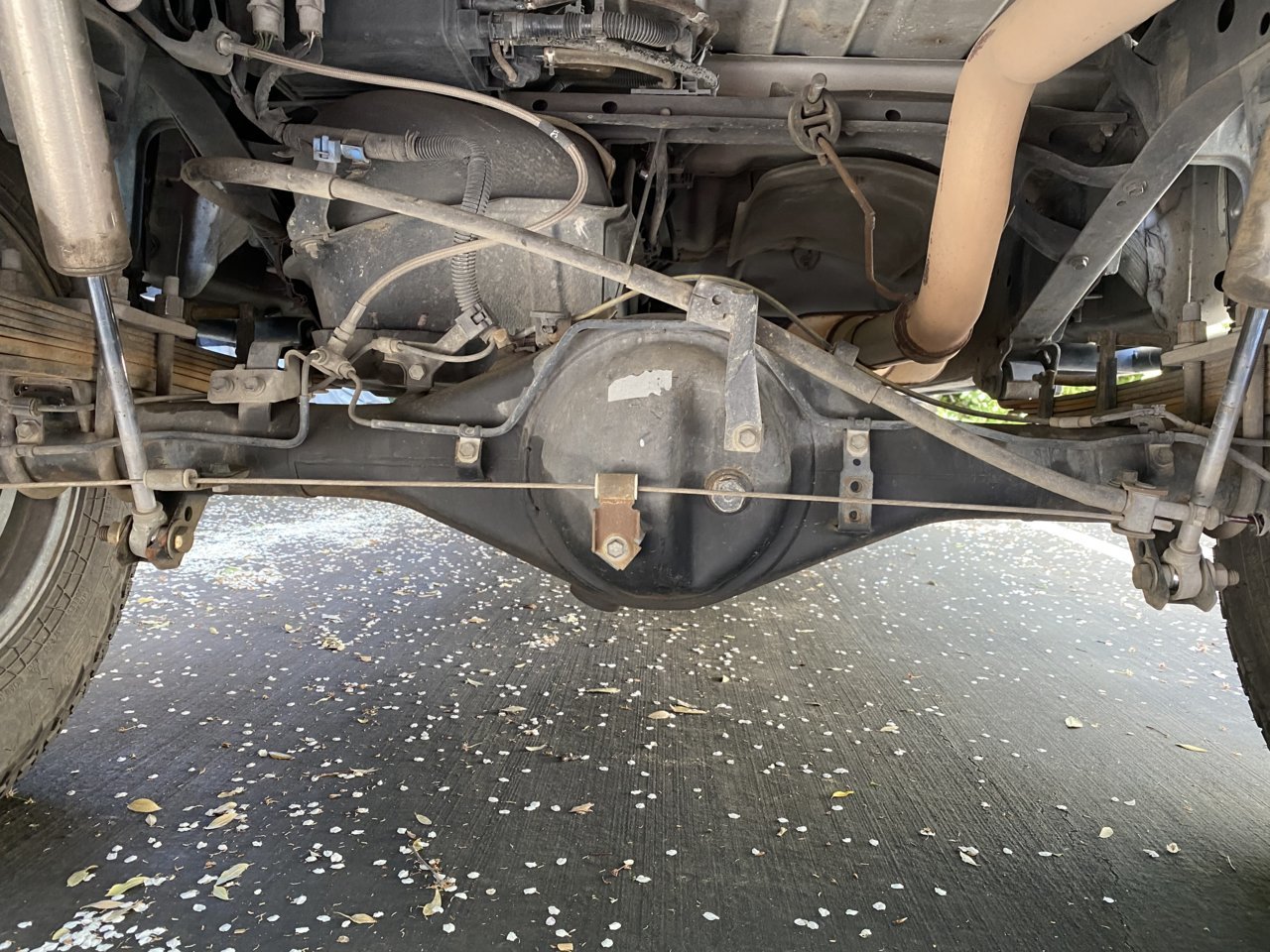

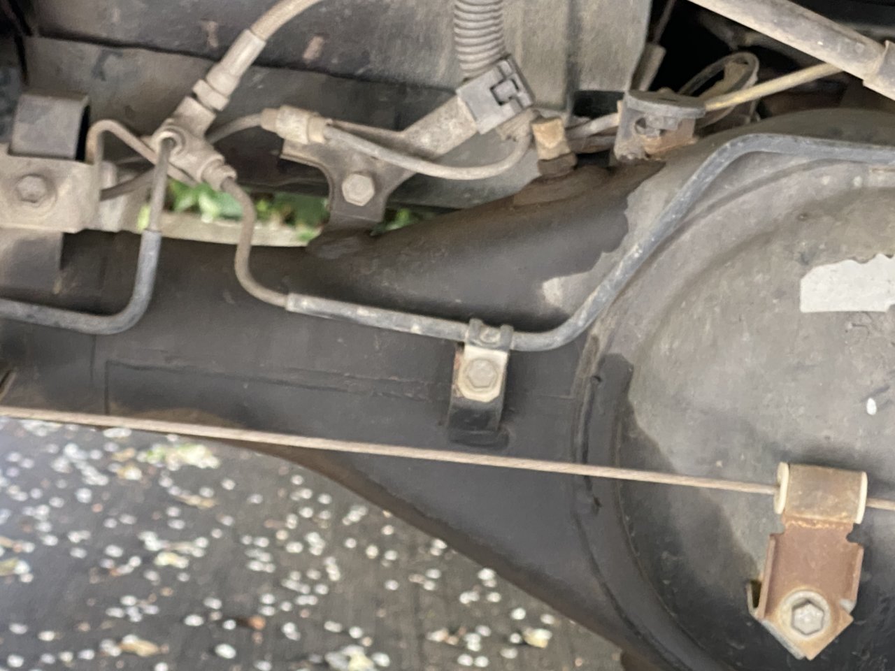

    I noticed a stain from a leak coming from the rear of my 2003 Tacoma 4x4 it looks like it’s coming out of the valve? Any opinions on what it could be? Here’s the pics BD225FA5-B21D-4807-AB50-1CC7C70445D3.jpg 62548D6E-AB69-44B1-8F97-03ED079795A8.jpg 56A50A5B-9577-4FCA-AE70-01338B1DF49D.jpg

    This is the axle housing breather. It just unscrews like a bolt. You can check that it is not blocked. If so it should be pretty cheap to replace

    Replace breather
    Remove fill plug first
    Remove drain plug second
    Drain, reinstall drain plug with new gasket, refill until it spits over, and reinstall fill plug with new gasket
    Note, the above should be done while on flat ground

    thank you sir I’ll be doing that this weekend

    Knock out the front while you're at it; did mine last month
    You'll see I did the infamous 'Lexus plug' swap; you replace the 14mm hex drain plug with the drain plug used on a Lexus
    Baggie of parts are the new gaskets/crush washers

    I suggest removing the OEM axle breather and extending it up to and behind the fuel door.
    Plenty of info if you search.

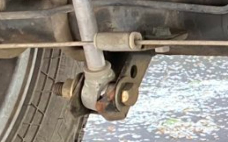

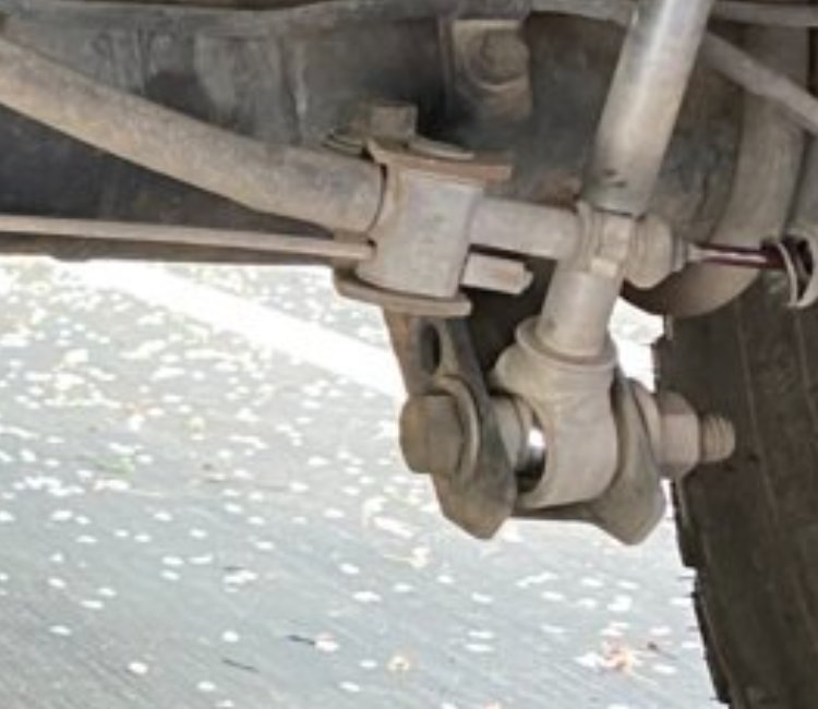

    Not sure if it has been mentioned before but might want to do outside vs. garaged. If in a closed garage be prepared for the stink, it tends to linger.
    Also just noticed, might want to check your bushings :eek:

    Those are spherical bearings, not bushings, and look just as they should.
    Still wouldn't hurt to check them for play though.

    While you're in there replacing the breather, just do a breather extension. Super simple, and helps keep water from getting in the housing during water crossings.

    Yeah that’s what I plan on doing I’m going to search for the link for the install instructions thank you
