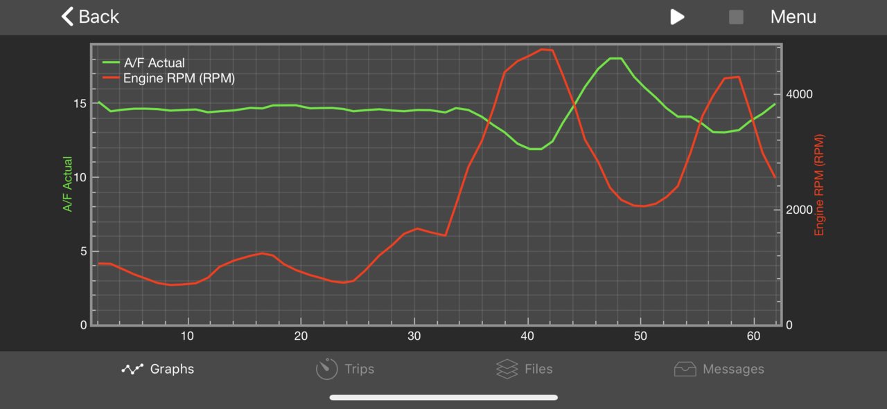

    Just as an update.Went ahead and installed 2.7" URD stealth pulley.Truck pulls much better and mpg are much better.i can cruise at 70 to 75 getting 16-17mpg now.Im running 33" open country's and 20" fuel maverick wheels with a 3" toytec lift.towing my ultra 300lx jet ski I get roughly 13-14 mpg.
    Current set up:
    TRD charger with 2.7" pulley
    AFE Pro-SI dry intake
    Stock exhaust
    TRD reflash
    AEM 320lph fuel pump
    My afr's did as @Torspd anticipated..11.4 @WOT
    Hope this helps.

    Thanks, that's very helpful to know. If you wouldn't mind walking me through a bit...
    Do I really need an AFR gauge?
    You're not running the 7th injector, right?
    And do you remember what belt you have?
  12. May 2, 2019 at 8:26 AM
    #32
    cdelgado14
    cdelgado14 [OP] Well-Known Member
    Dec 11, 2012
    #92905
    827
    Alice,Texas
    Supercharged micro machine ;)
    Bilstein 3 inch w/ 5100's
    You dont NEED a AFR gauge, but I like knowing what's going on with the truck,peace of mind i guess you can say.I am not running the 7th injector.As far as the belt I am running the Gates K080702HD Micro-V Belt.You gotta trim 2 ribs off,and that's what I did.I havent had any issues this far with it.

    AFR still pegs out at ~11.9, same as it did before the intake and smaller pulley.
