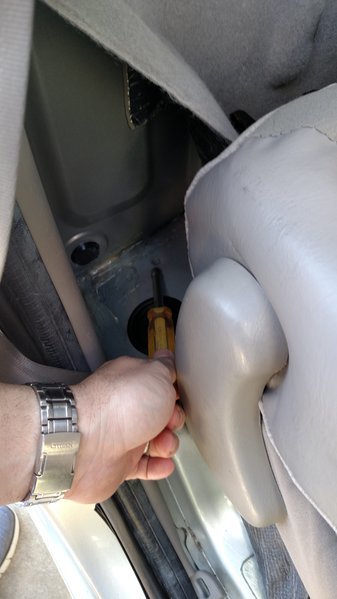

  7. Feb 27, 2017 at 4:52 AM
    Obsessed2000
    Obsessed2000 Just a big dummy
    Mar 7, 2016
    #180533
    368
    John
    NC/VA line
    2000 SR5 4x4 3.4
    Deck plate mod Bilsteins All pro leaf springs All pro greasable shackles Camburg UCA Interior Led conversion Tundra TRD springs Extended SS brake lines Seat covers 33" yokos White herculined exterior
  8. Feb 27, 2017 at 1:30 PM
    TashcomerTexas
    TashcomerTexas My truck is a whiner
    Apr 16, 2014
    #127853
    10,350
    2003 TRD DC Supracharged
    Are you talking about on the left side where the clutch pedal normally is? In autos it's just a foot rest
