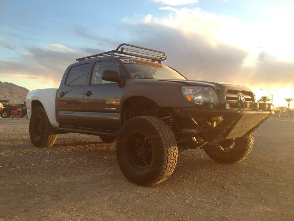

  15. Nov 11, 2012 at 4:07 PM
    #235
    uscg2008
    uscg2008 Well-Known Member
    Nov 6, 2009
    #25537
    2,879
    coby
    San Diego, CA originally from Huntington Beach, CA
    06 trd sr5 four door 4x4
    CLICK ON SIGNATURE>>>>
    damn i love that low profile rack!! well done bubb you got anymore pics of it and all the lights at night
  16. Nov 11, 2012 at 4:52 PM
    #236
    SoCalRoadie
    SoCalRoadie [OP] Well-Known Member
    Jan 18, 2011
    #49459
    882
    Jim
    Burbank
    10 PreRunner TRD 2wd Engage LT
    The rack is a few pages back. It's a modified SMP rack.
    Gonna wire the new 30" up tomorrow. Ill try and get some shots of the whole rig.
