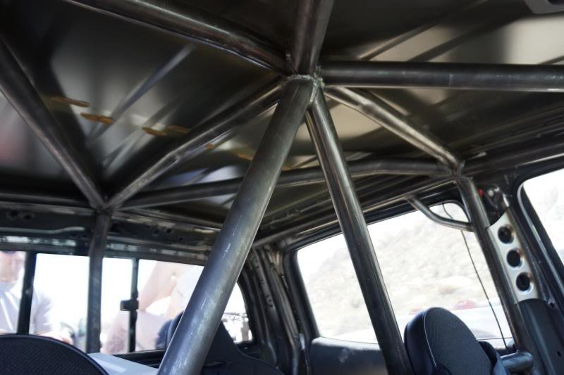

    I don't remember, but you're getting the rear end linked on this truck right?
    If you don't mind, how much did SMP charge to double cab the cage?

    Links might happen down the road. Since the price of new 50Ts just skyrocketed up to the cost of links.
    SMP has thrown out quotes of $6-6.5k for the cage. I agree with those estimates. My actual number was less because I bought my own metal.
    Yup. That's the plan.

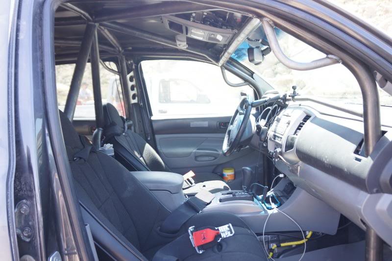

    Post pics of the cab cage! :D

    Very good job! Now you just gotta take time and plan out how to connect the engine cage to the cab cage to the bed cage.

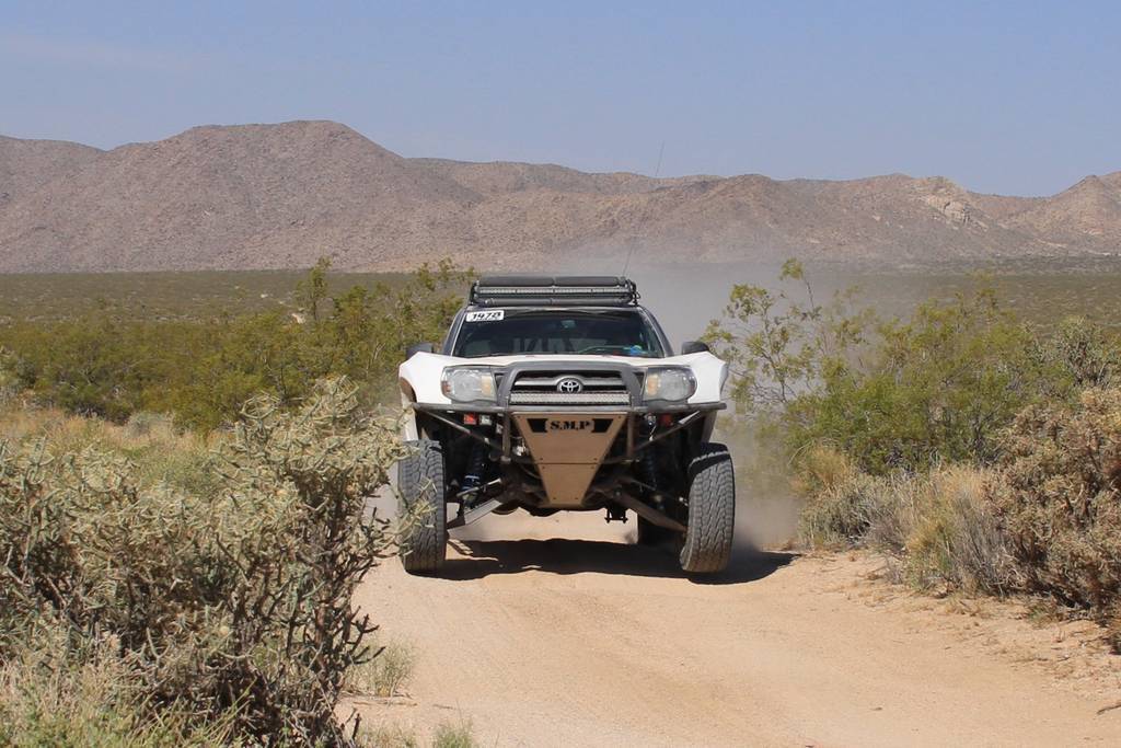

    Tuned the truck a bit with Lembowski's help. I felt in control about 10 mph faster than last time. I need more work but just tweaking the bypass valves made a noticeable difference.

    Nope. It happened this weekend. It was a little bouncy because of the cage, but I really pushed the truck hard this run.
    My valving has been the same this whole time. I just played with the bypass valves to see if it made a difference.
    Front we closed both compression and opened up the rebound.
    Rear we closed the top valve and left 9 threads on the mid valve. Rebound was wide open.
    On the back stretch of trail by Primm where I took you, I gained 10mph. I felt comfortable and in control at 55 mph.
