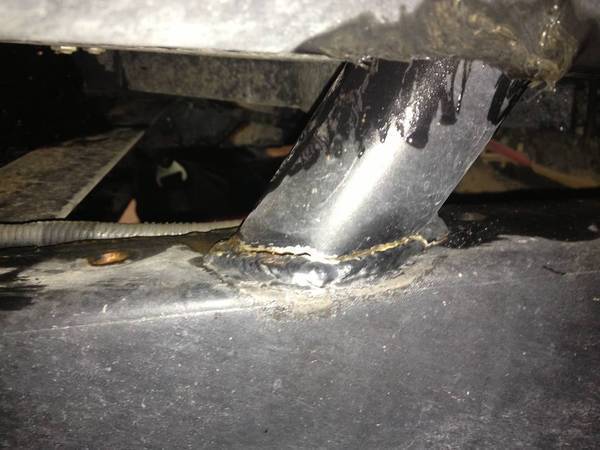

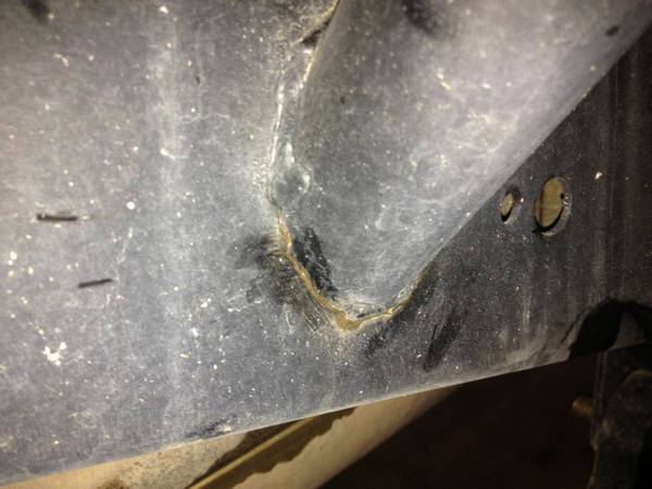

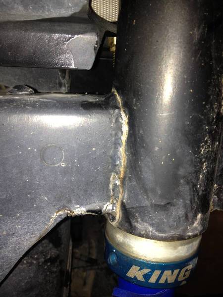

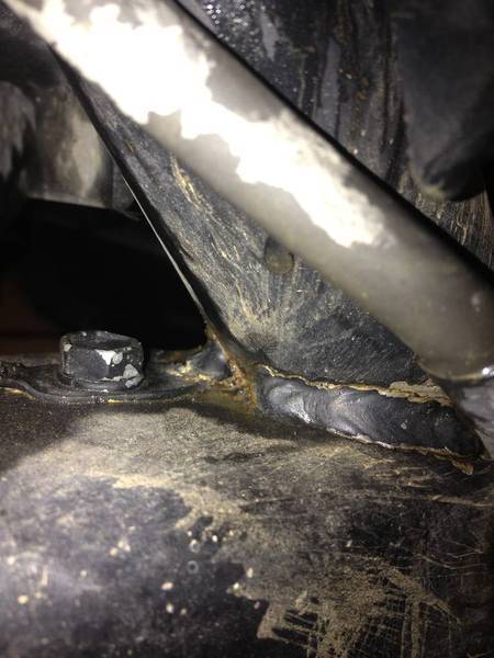

    Well sh!t... I guess I push my truck too hard.
    I got incredibly lucky last night. I was a lot more broken than I originally thought. I broke both sides of the frame on 3 out of 4 sides. I broke the bed cage off the frame on the support brace on the pass side and cracked the driver side. And I cracked the pass side main brace welds.
    Went to SMP today to band-aid the situation. Steve re-welded what he could and its street worthy again, but not dirt worthy. I will have to look into what my next step is. At least tying the cab cage into the bed cage or even starting over with the bed cage.

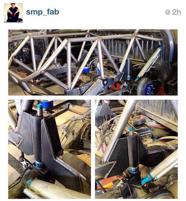

  11. Jul 15, 2013 at 6:48 PM
    #331
    SoCalRoadie
    SoCalRoadie [OP] Well-Known Member
    Jan 18, 2011
    #49459
    882
    Jim
    Burbank
    10 PreRunner TRD 2wd Engage LT

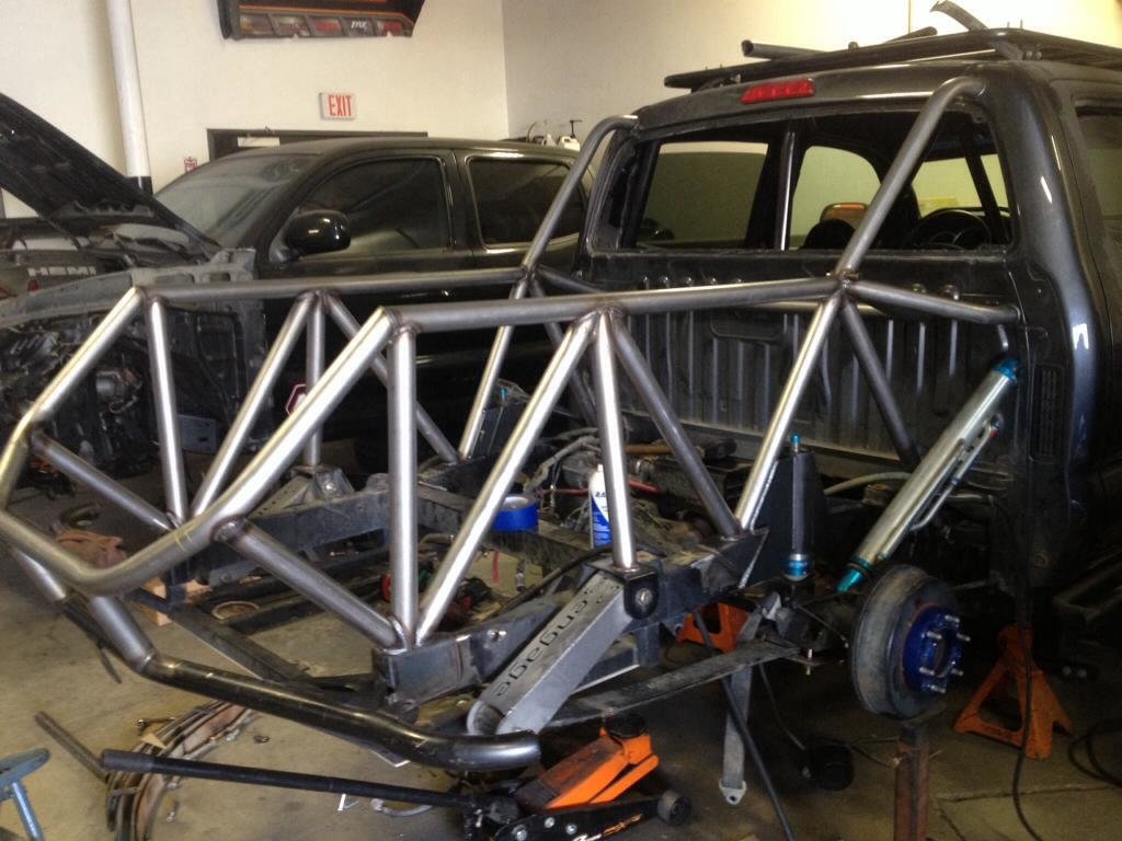

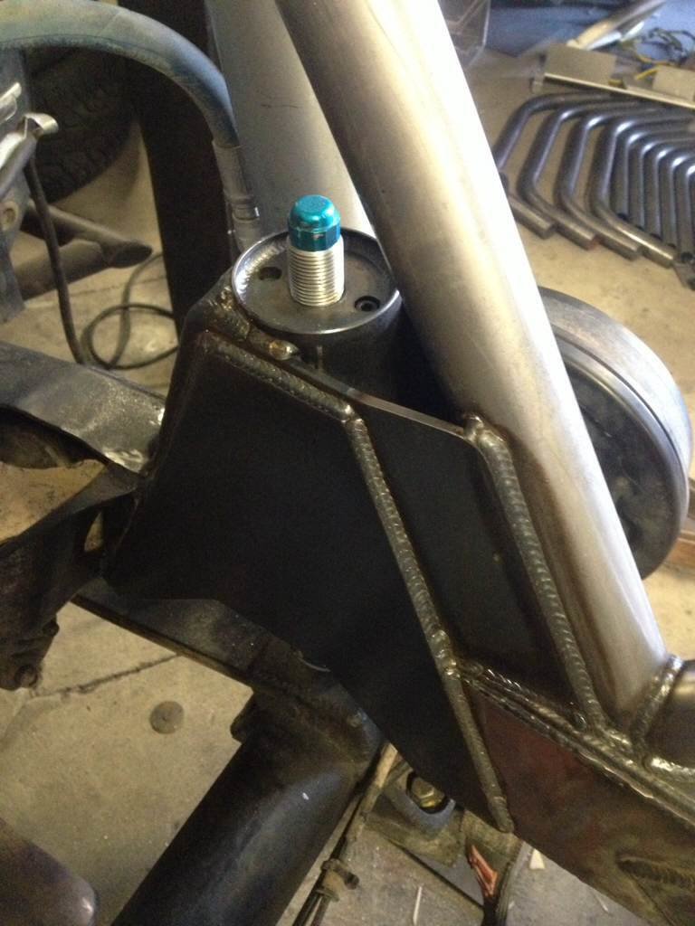

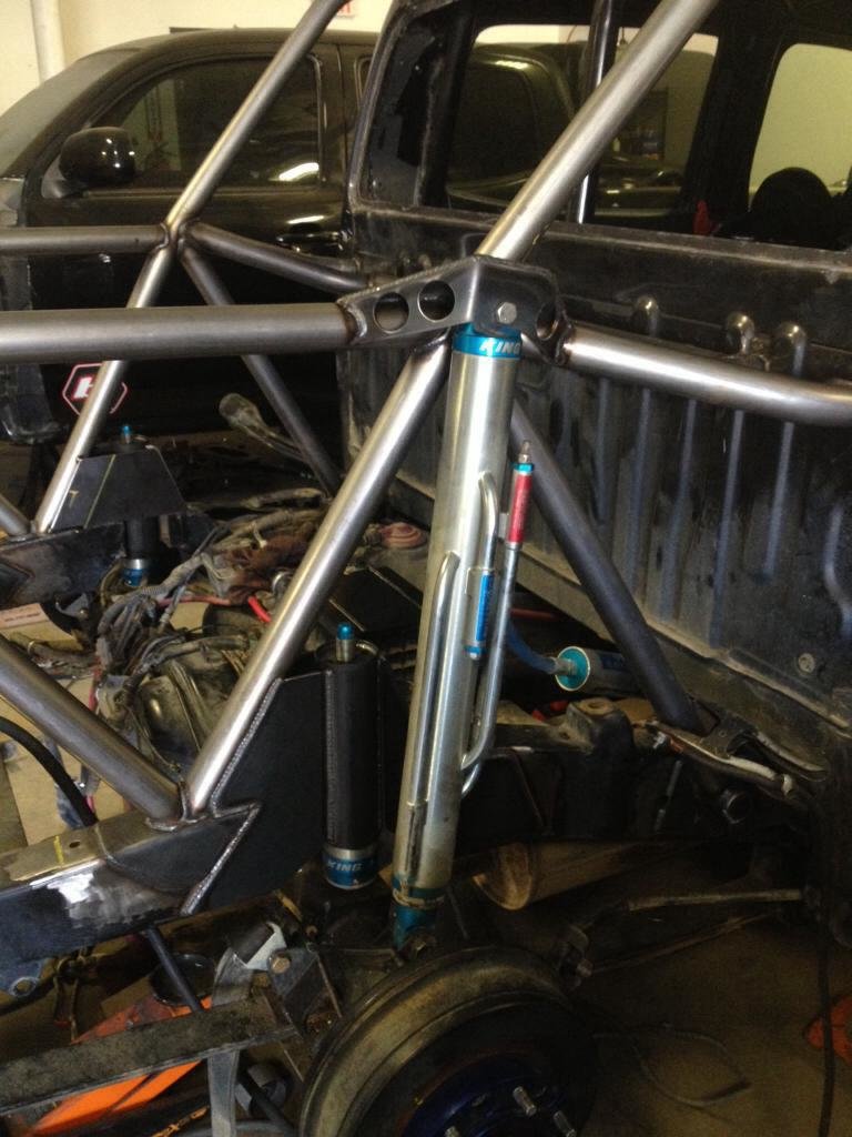

    Finally fixing the Mojave damage.
  12. Jul 15, 2013 at 7:28 PM
    #332

  14. Sep 18, 2013 at 2:24 PM
    #334
    SoCalRoadie
    Jan 18, 2011
    #49459
    882
    Jim
    Burbank

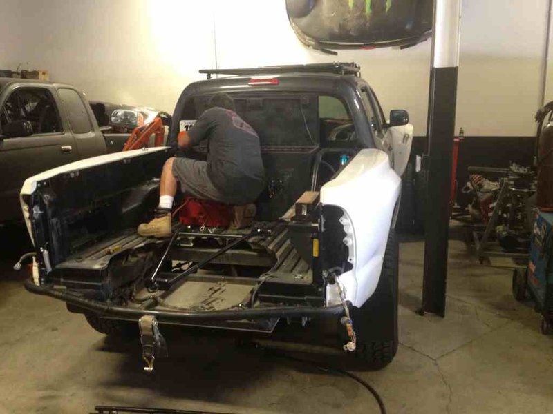

    After weeks of delays, illness and setbacks we now have progress!!
    Hopefully I'll be picking her up sometime next week.

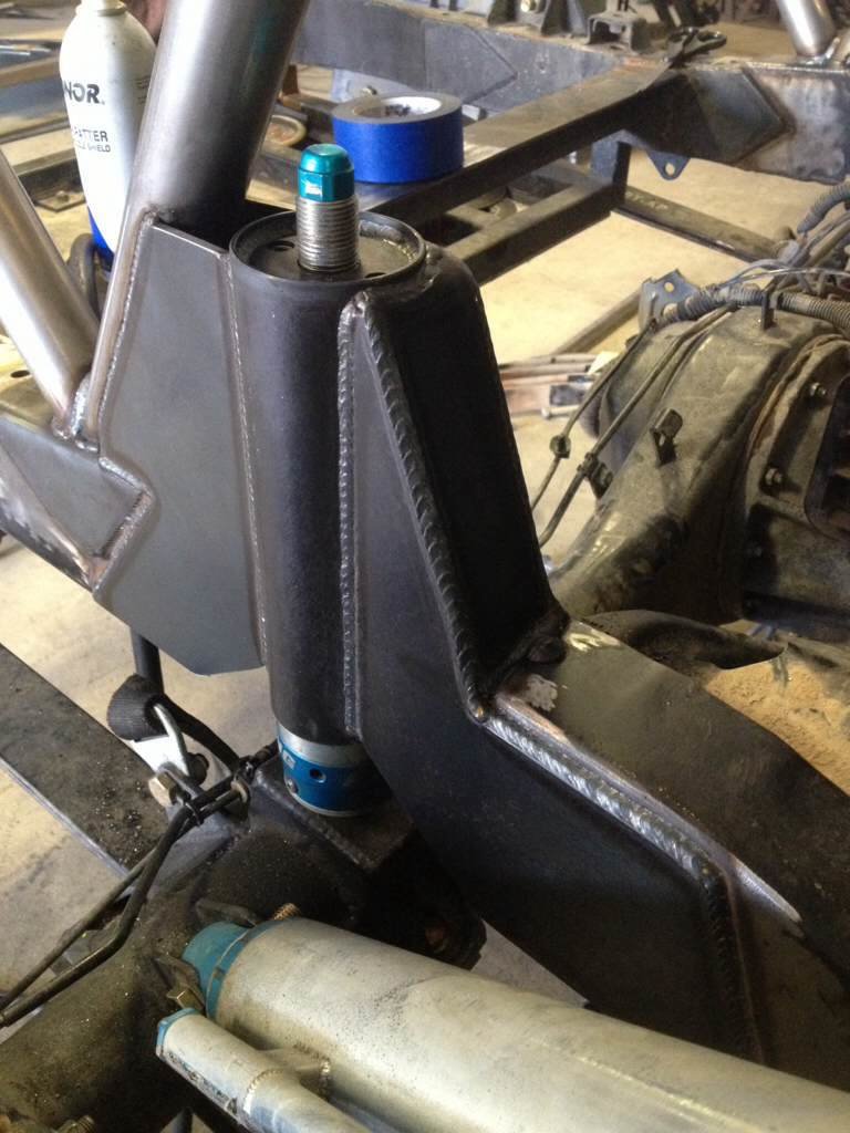

    Yes! Stoked on your bed cage Jim. The rear is gonna be 10x stronger.

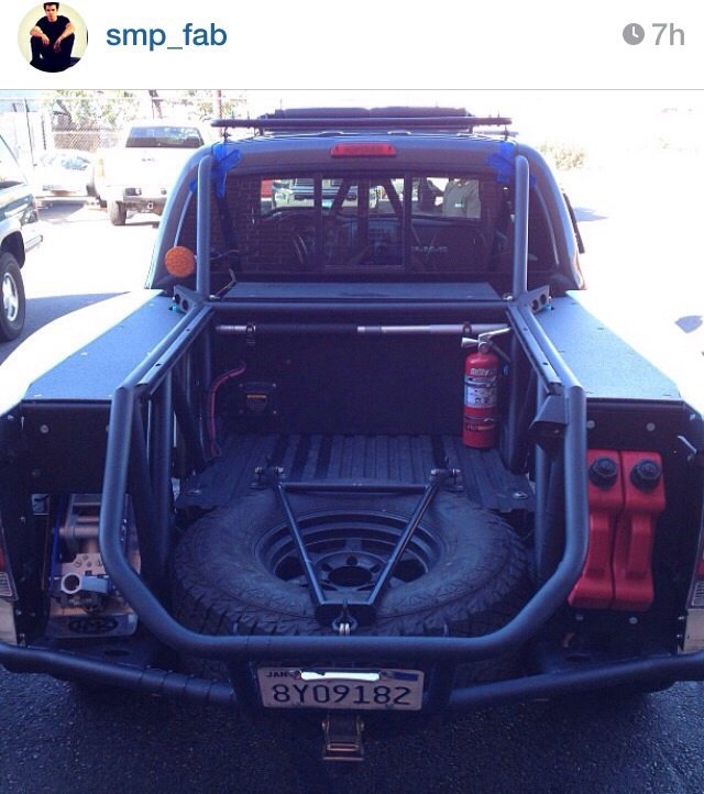

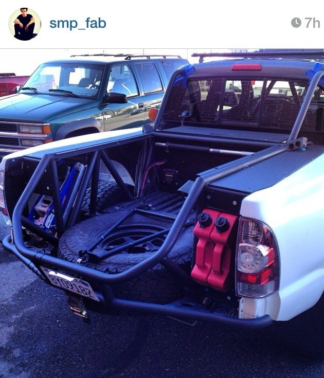

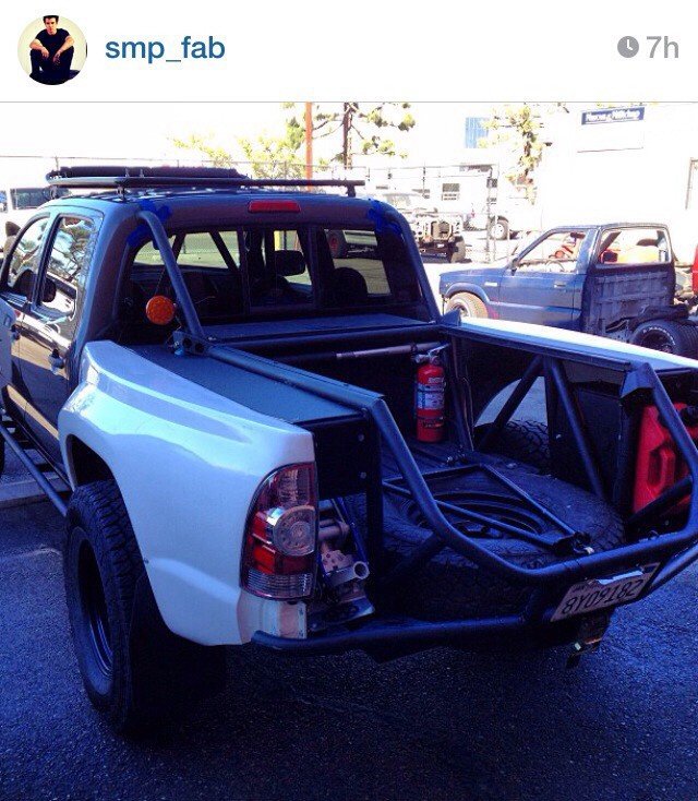

    Here are some better quality pics:

    Truck is back from the shop. I'll take some more pics later this week.
