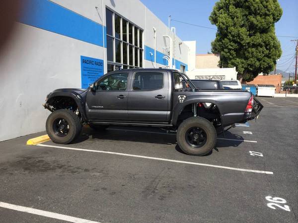

  6. Mar 17, 2014 at 11:58 PM

    Damn that looks mean :eek:

    Looks awesome man

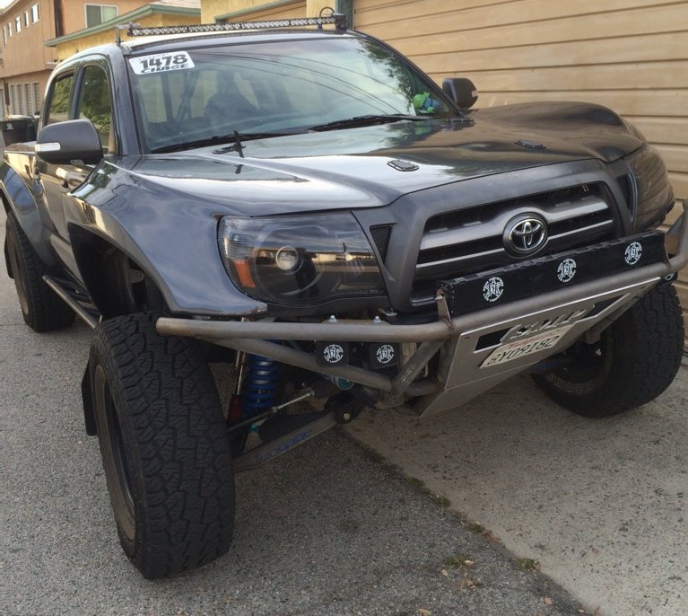

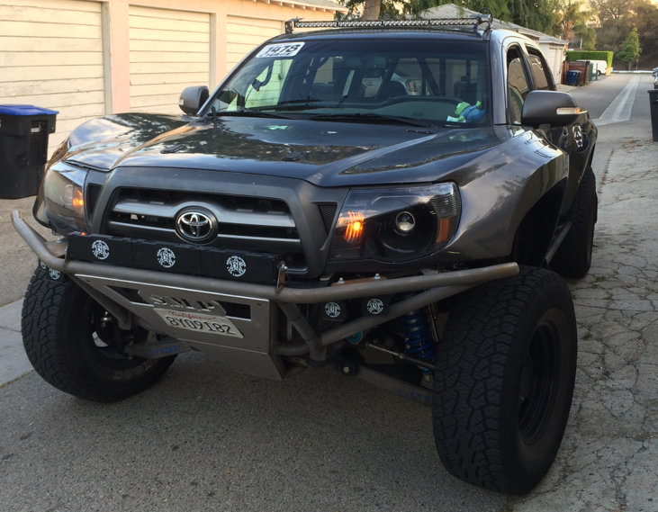

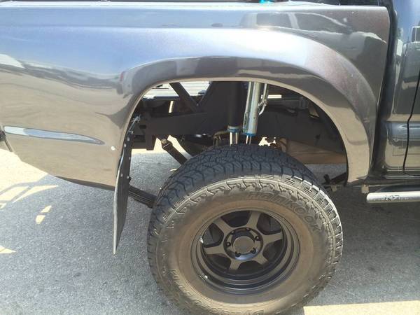

    Some new updates:

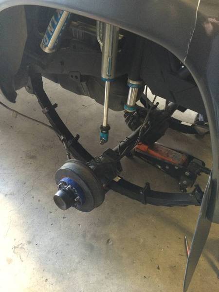

    Put some new custom Deavers on. With my 13" shackles its a little high.

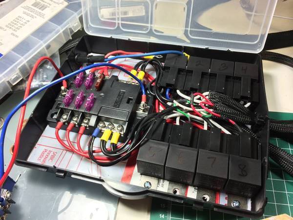

    I've got a light project that is making headway. Just need to find a better enclosure:

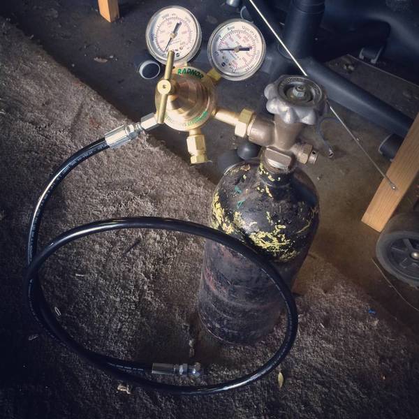

    It's time to step up my shock game:

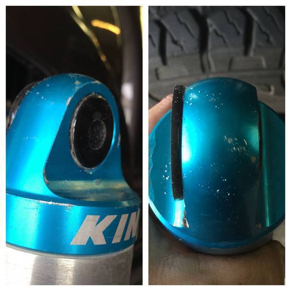

    And I put some poly bushings in my rear shocks (top cap only) Best. Decision. Ever.
    I also swapped out my 13" shackles for 12". It took a lot of the harshness out of the rear and dropped it an inch or so.
    I'm going to hit dirt soon to break in the springs and see where it settles.

    6" Ruff Country DBL
    Why the change in shackle length? Just for ride height?
  14. May 4, 2014 at 10:54 AM
    #354
    SoCalRoadie
    SoCalRoadie [OP] Well-Known Member
    Jan 18, 2011
    #49459
    882
    Jim
    Burbank
    10 PreRunner TRD 2wd Engage LT
    It changes the ride height slightly but it takes some of the pre-load out of the springs. This equates to slightly lower and softer springs. Overall a much better ride. I was very surprised at the change it made.

    2008 dcsb trd offroad 4wd
    did the bypasses make a big diff with the engage kit? do you have bumps?
  16. May 4, 2014 at 12:01 PM

    882
    Jim
    Burbank
    Huge. Whole new truck.
    Yes. 2x2 Pro Comps in front and 2.5x4 kings in rear.

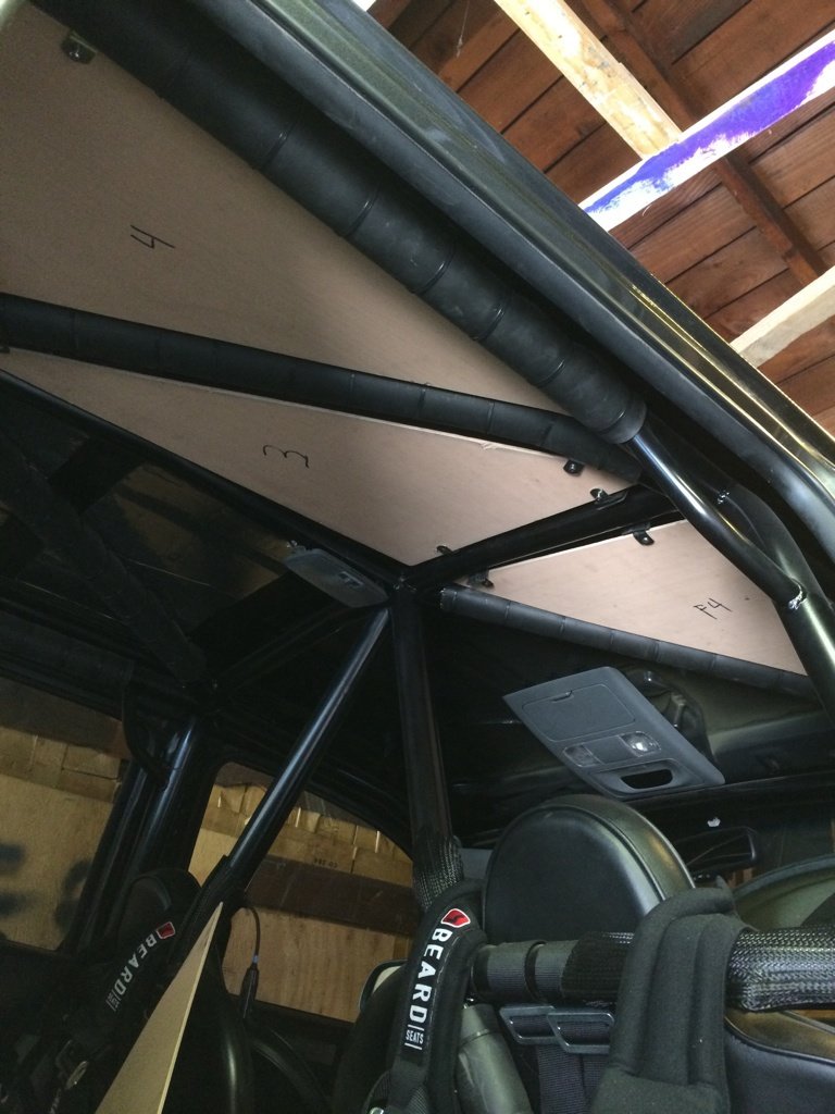

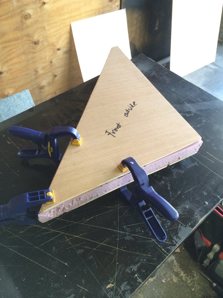

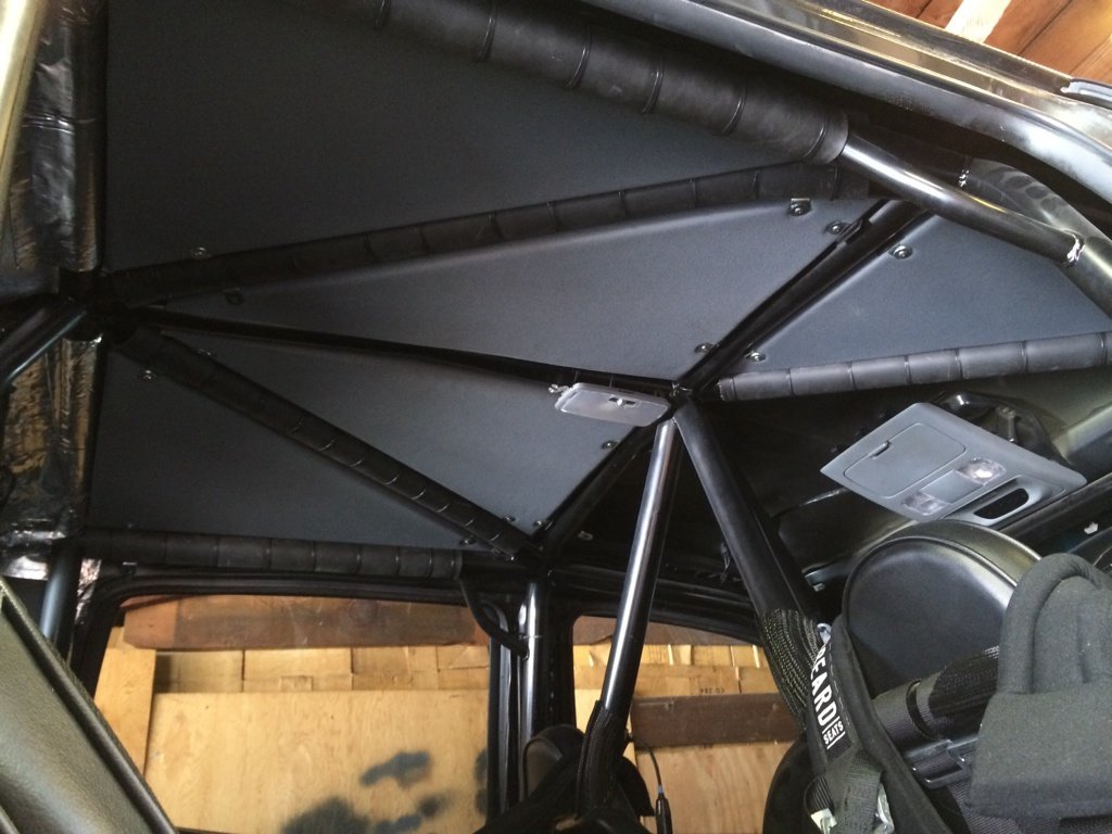

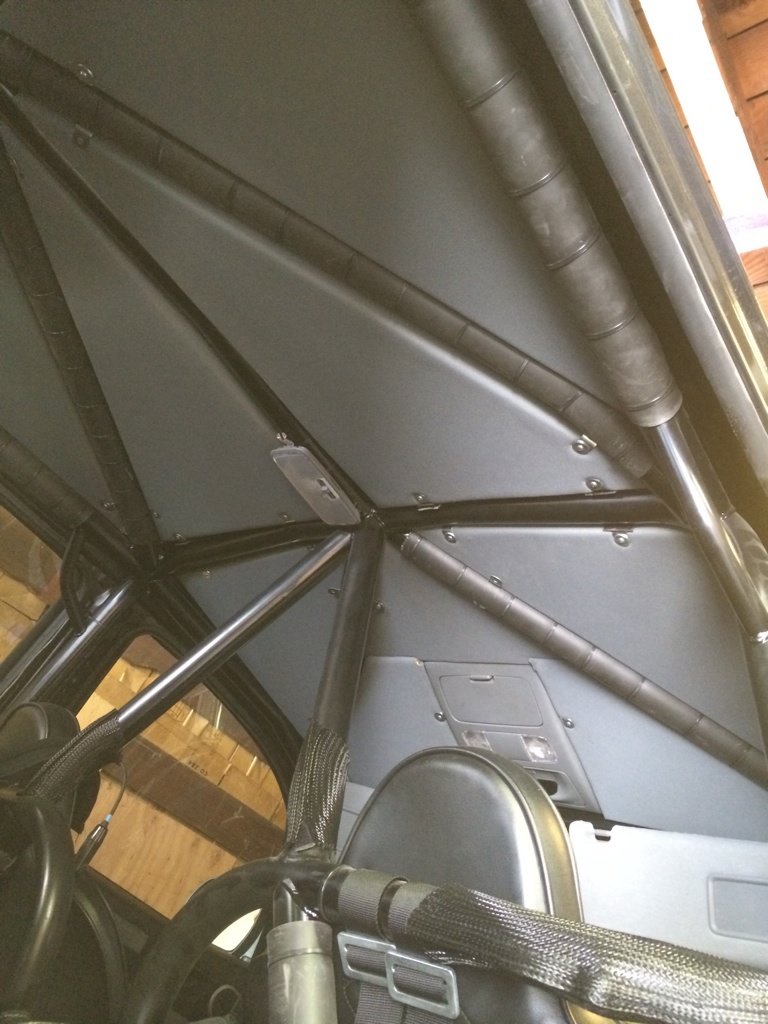

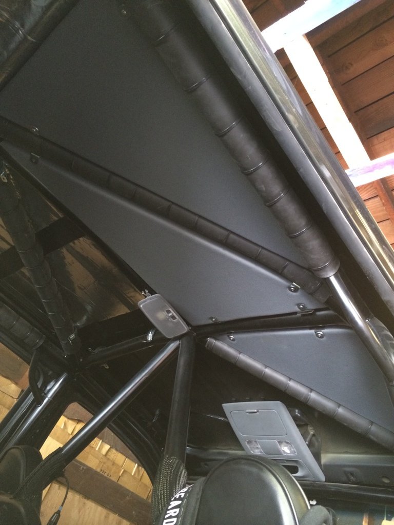

    Made a headliner this weekend.

    Jeeper Creeper
    Can you take a few pics of how you did your rear mudflaps?

    siiiick build. Good job on your headliner, subbed.
    edit: where'd you get the poly bushings for the top of your kings?
  20. May 29, 2014 at 10:33 PM
    #360
    SoCalRoadie
    Jan 18, 2011
    #49459
    882
    Jim
    Burbank
    PolyBushings.com
    They sound great but I had to go back to unis. They couldn't handle all the energy of going fast in the dirt.
