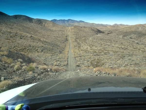

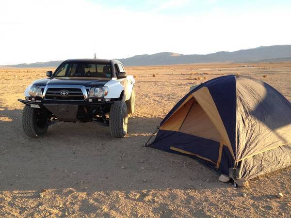

    Some pics from Lucerne this weekend.
    Base Camp
    On Sunday I took the 85+ mile route that Mike gave me. This was about half way thru.
    Waypoint 22 starts the hills... got thru the first few then had to find a way around WP 24 because I couldn't get up the hill comfortably... I was solo and didn't want to get stranded.

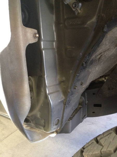

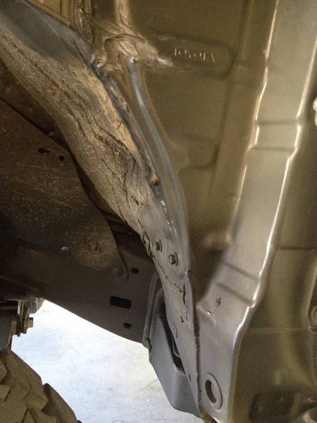

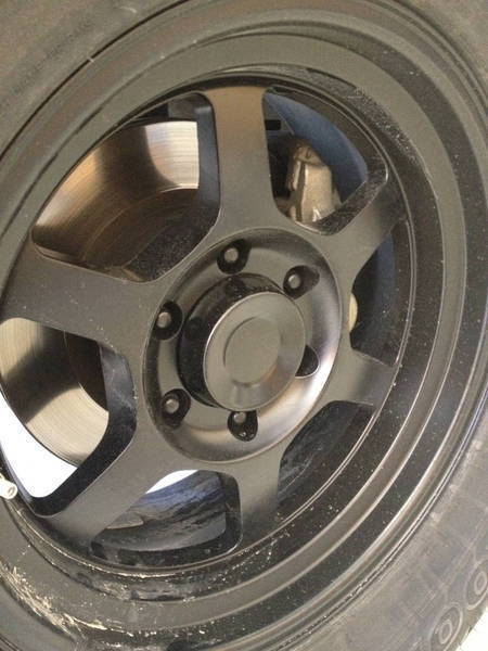

    Busy weekend. Bought two more Countersteer Xs for spares. Dude came with some new shorter center caps that look way better.
    I went up to KR Fab and got some bits and pieces chopped off so I have full clearance of my 35's now.
    Ken also fab'd up a quick and dirty tire carrier for my spare. Welded up a tab for my soon to be dust light. No pics yet.
    And i put my rear spacers in. :cool:
