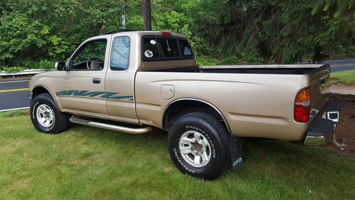

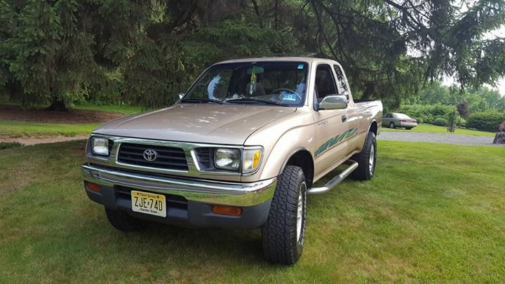

    My brother told me to make a build thread, even though I haven't done much. So heres my truck its an Xtra Cab with a 3.4L v6, and a 5 speed manual. And its gold with these weird decals on the side which are acceptable.:cookiemonster:

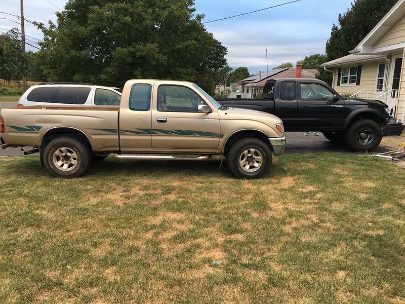

    Pics when I got it:
    13321845_10157023056765422_8271454234479660400_n.jpg 13325696_10157023056740422_3554551825459480275_n.jpg IMG_0632.jpg

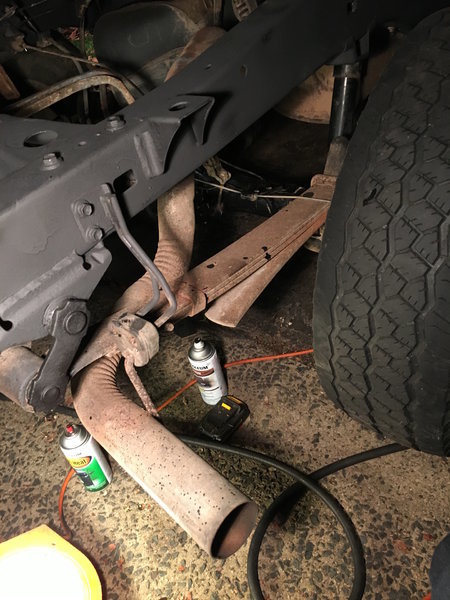

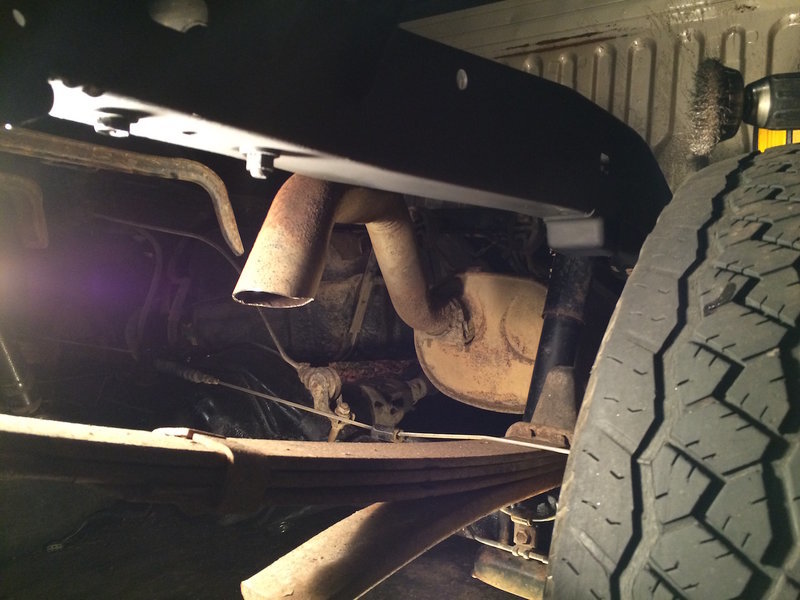

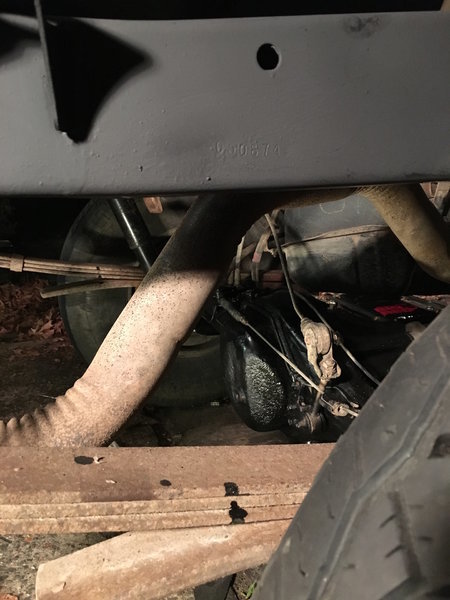

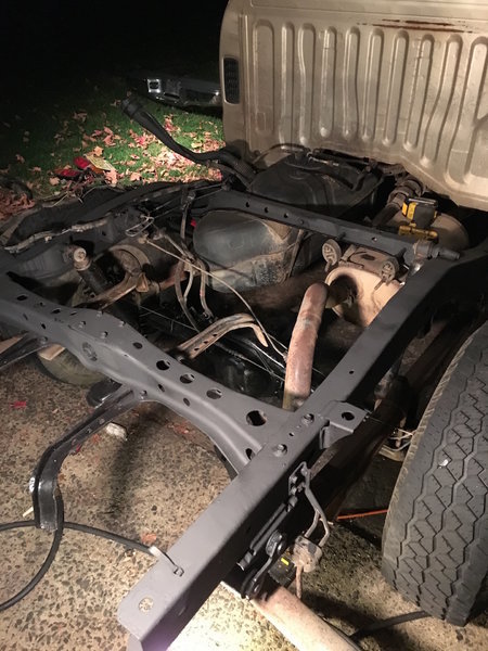

    So heres what I have done this week. I wanted to coat the frame in POR 15 before the winter and get most of the rust off the frame, even though it was replaced by the recall.
    After I cleaned the frame and painted it, I cut my exhaust just because apparently it gives you better clearance off-road and I figured it wouldn't hurt much. I also cleaned and painted the skid plate under the gas tank.
    (Before)
    (After)

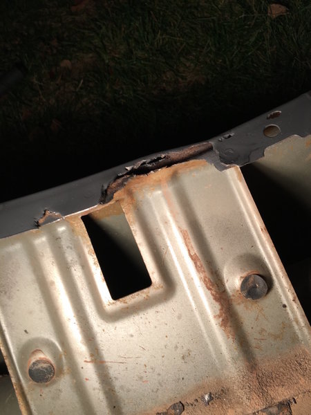

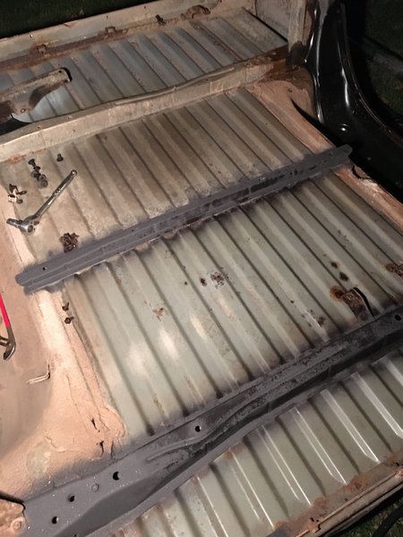

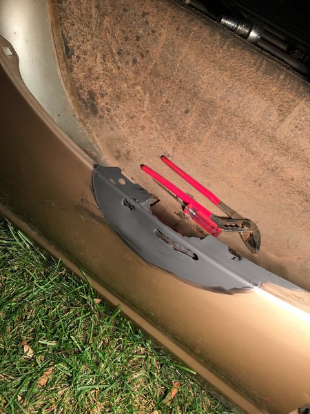

    I decided to hold off coating it in marine grease until I was done with the bed. The bed isn't in bad shape other then a bit of rust and a couple dents and a rusty fender.
    I wire brushed the paint off and cleaned it as much as I could and coated it in paint because I didn't feel like dealing with it that night, and I didn't have any sheet metal.

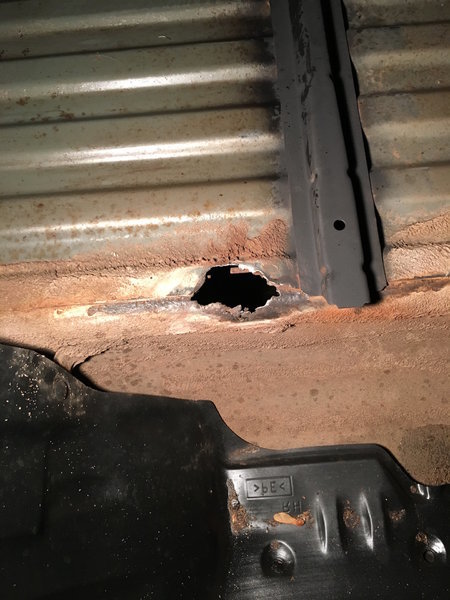

    This rust spot looked the worst before I wire brushed it and I think its the worst of what I have to deal with which is good because something similar happened to my brothers bed so I kinda know what I'm gonna be working with.

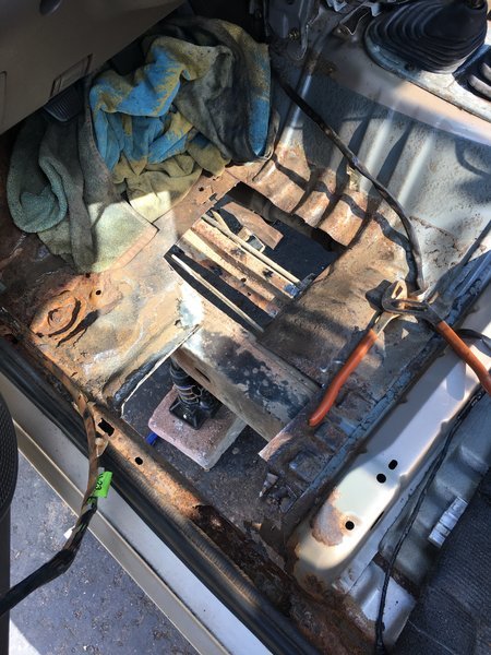

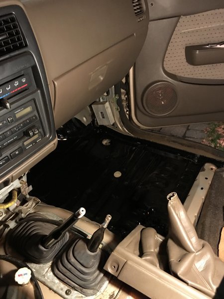

    I also removed those nerf bar slider things Ill get a pic later without em. Once Im done patching up the bed and having that where I want it I am going to tackle the interior, gonna take most of it apart, clean it, and patch the rust hole in the passenger side floor.

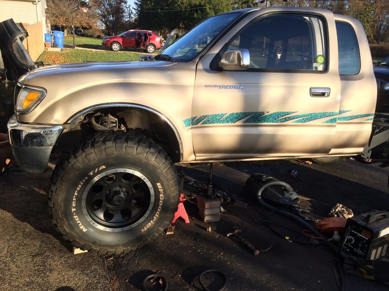

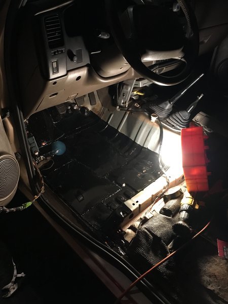

    Some updates on the build since I haven't updated in awhile.
    in chronological order:

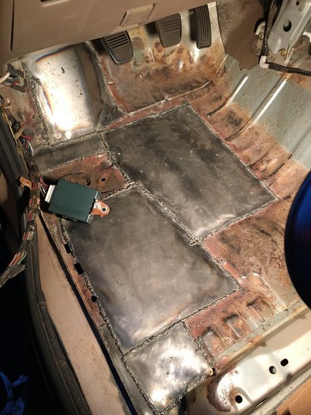

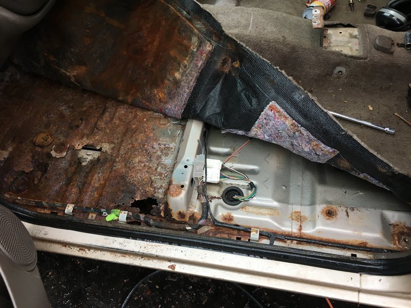

    - patched major hole in floor
    - painted wheels
    - removed nerf bars
    - removed decals
    - painted mirrors
    - washed, buffed, waxed
    - magnaflow muffler
    - diff breather mod
    - fixed brakes
    floor repair:
    test fit my friends 35s :D

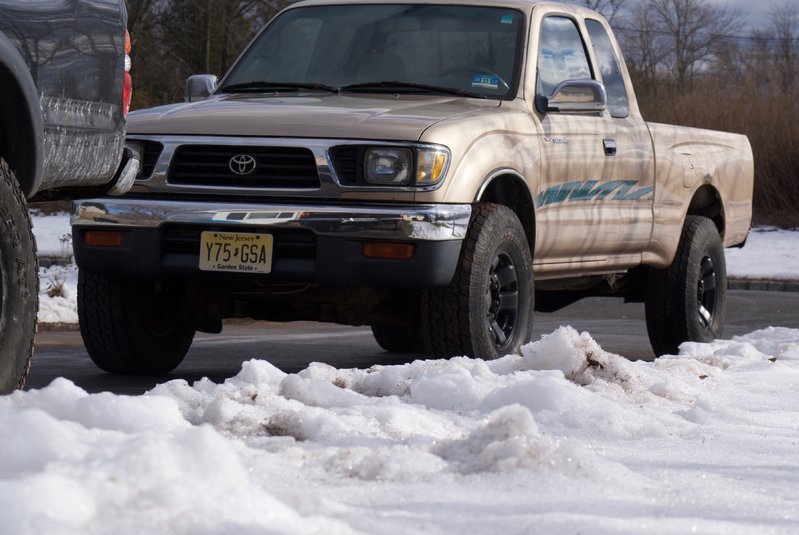

    removed nerf bars and painted wheels:
    removed decals, painted mirrors, buffed, waxed, washed:
    my tax return is going towards the lift and Im getting more hours at work to save for tires, should have most of the stuff by spring break, got some big plans including a bed rack, custom rear bumper and retrofit front bumper ;)

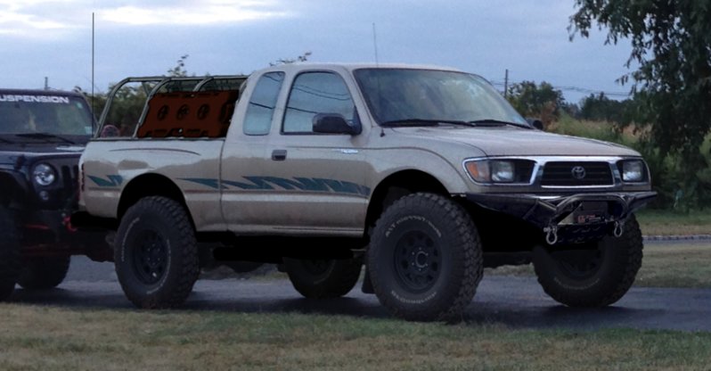

    Heres a little concept my brother made awhile ago, basically end goal

    What process did you use to remove that decal?
  10. Feb 20, 2017 at 7:49 PM
    Sofatank
    Sofatank [OP] Well-Known Member
    Jun 7, 2016
    #189018
    132
    Christopher
    New Jersey
    1995 Toyota Tacoma
    None
    Most of the decal was above the paint, but the small ones on the cab were under the clear coat, but you just use a hair dryer and start pealing at it, not to much heat or else it will get really stretchy and rip but just enough, and the stuff under the clear use a razor blade and be really careful pealing it up. And after your done pealing it up use some goof off and a rag to remove the adhesive.
