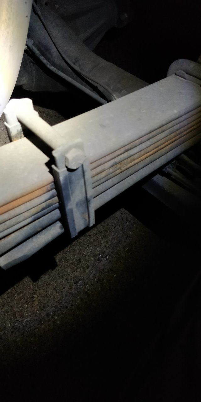

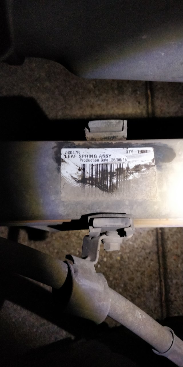

    I have CS047R leaf pack. Overload removed (still in picture).
    99% I have bed empty. Never really Carey heavy loads. But I believe the leaf pack I have was intended for heavy loads and it rides like one. Very harsh. Loaded 350pounds in the rear once and even then sagged very little.
    I need a softer, no load or light load close to OEM leaf pack.
    I've considered the Skyjacker Soft Ride leaf pack. What else should no consider?
    Thanks.

    yeah that is not a stock set, too many leafs, much stiff
    consider if someone is taking off stock leafs... do a switch-a-roo

    To remove some of the stiffness you can remove the 3rd leaf from the top. It still probably wouldn't be anywhere as soft as the oem pack.
