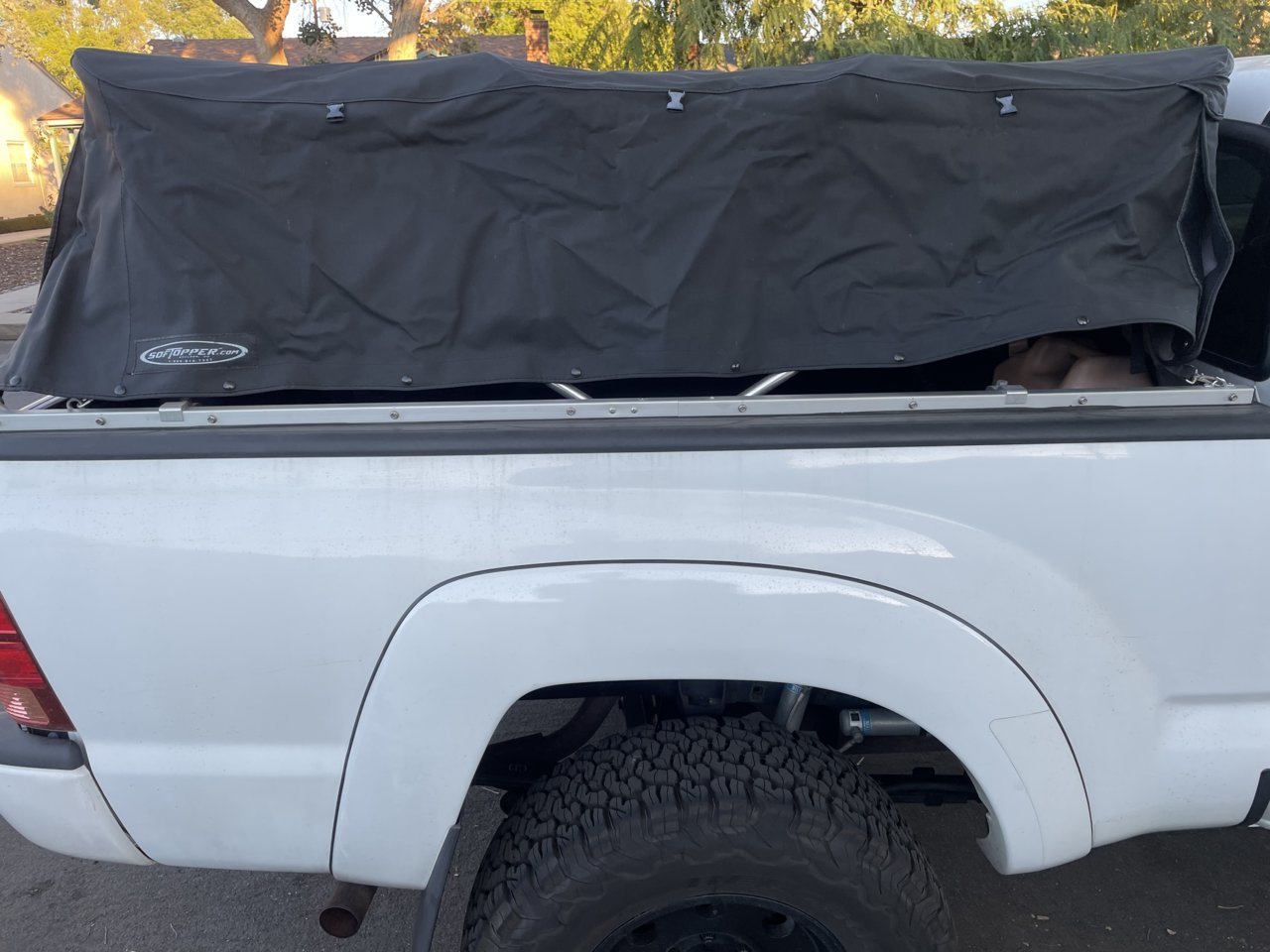

    I put my softopper down for a couple weeks just for the hell of it. Came back today to put it back up and I cannot get it to cbuttom back up. And the only thing I can think of is that the fabric shrunk? Am I crazy? Anyone else experience this before? Mine has always been a little tight when buttoning up but this is impossible. Attached a pic as well that shows where it sits, after I got the opposite side buttoned down.

    Nothing in your pic looks alarming to me. The frame is clearly in a relaxed position so it should be expected that the cover would not snap into place if you're trying with it just like you have it pictured. Or at least it'd be tough to do so.
    If you let it warm up in the sun it'll be easier, if it's cold it can be too stiff to go easily back into place. Use the straps at each corner to snug the frame down more and more until the frame sits low enough to get the cover to snap into place. You may need to snug them down more than feels safe, but, in my experience you can snug these down A LOT without any issues. When you start snapping the cover on, you shouldn't be doing one side at a time like you mentioned. Unsnap that side you have snapped in. Then start with the forwardmost snaps on each side. Go back and forth from side to side snapping them in place as you work your way to the back. Snugging the straps as needed to give yourself a little more slack.
    That said, I believe that the covers can shrink a little over time. I just wouldn't suspect that it'd happen overnight like that. The Softopper is designed with some adjustability that can help with fitment. Look at the little brackets that bolt to the side rails. The ones with the pin that each side of the frame slips over. You'll notice that bracket has three holes in it. You can move the pin up or down in three different settings. The lower settings could be used if you're having issues getting the fabric to snap into place.
    Lastly, check the frame for damage. There are rivets that hold the pieces of the frame together and if they break the frame can get a bit out of wack and that could also be causing issues. Luckily, Softopper is a great company and sell almost every little part and piece of hardware in case you lose or break something.

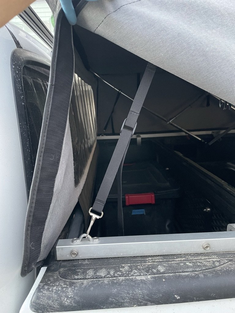

    Can you take another pic, showing the front, passenger side strap? In your photo, that strap appears loose. The angle is wrong compared to what it'd look like if it were snugged down. The angle between the strap and the side rail should be >45 deg but yours is clearly <45 deg. The rear strap is harder to see in your pic but it also doesn't appear to be the correct angle for it to be snugged properly. See in my pics below how my front strap is much more vertical than it is horizontal?
    It makes a MASSIVE difference. By cranking down those 4 straps the top of the frame will get lower and lower. Thus, reducing the distance from the top of the frame to the top of the bedside. If put in place, before being snugged down the top of the frame will actually be a couple inches ABOVE the top of the cab. Once you snug those straps down it should be relatively even with the cab. That height difference makes all the difference in the world regarding how easily the fabric fits on top.
    Sounds like this isn't the cause of the problem but it could be helpful in making your life easier once you sort out the main issue.
    Sounds like temp is also not your main issue. But again, trying to install when it's nice and warm will be a help compared to trying to install when it's cold. Sort out the main source of the problem and then use this as a tool to make your life easier.

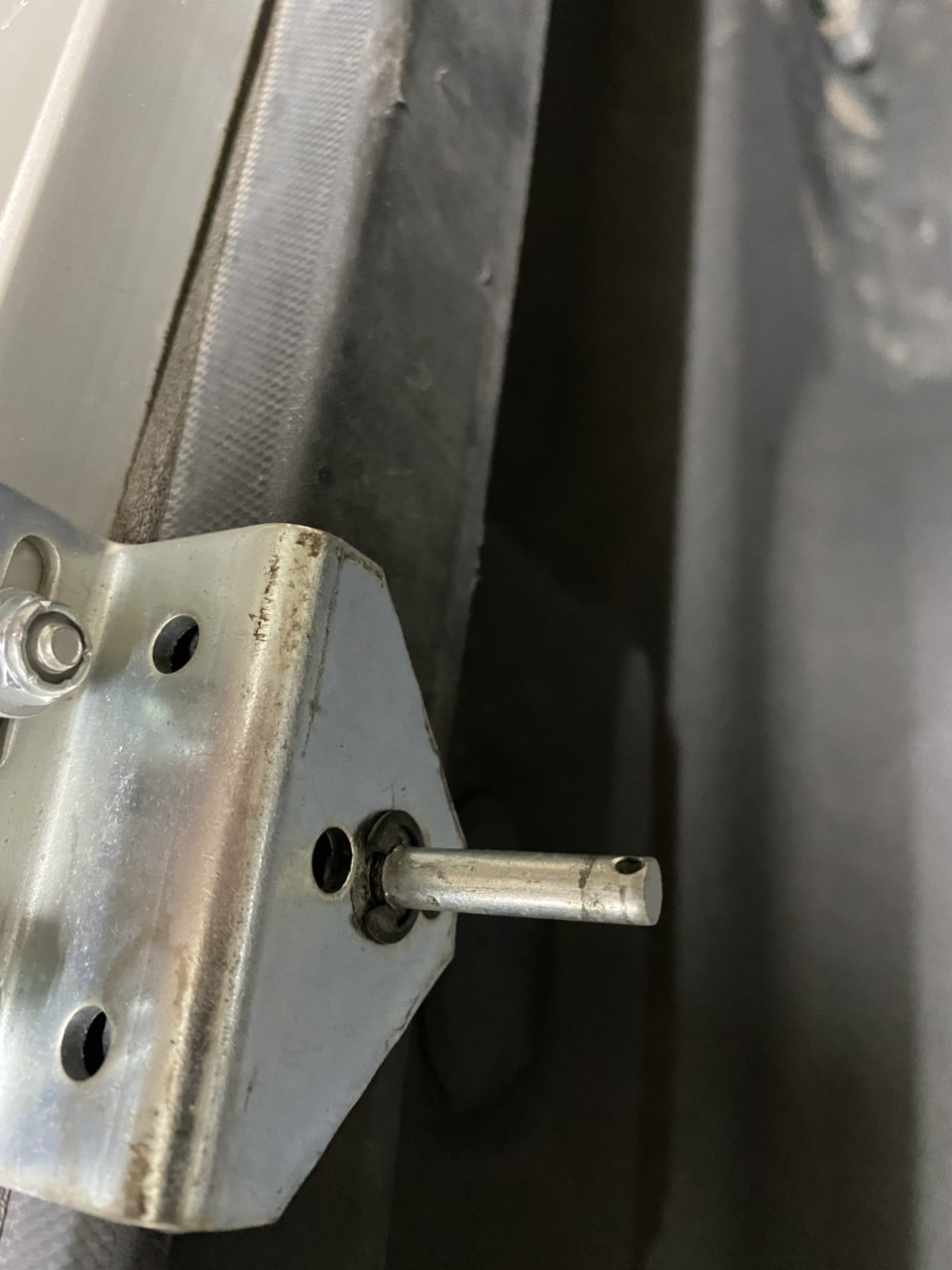

    On the frame rail, there’s three positions of adjustment. Factory settings is in the center. You may need to raise or lower.
    79A3D9FF-3A7A-452E-97E1-0DAE0F19F382.jpg 2EF114E0-8275-4421-B822-F4F0BFE2875F.jpg

    I was doing it that way at the time of the post. I did it the way you said just the other day. And it was still not easy by any means to get attached. The last corner was a huge pain in the ass. Had to have my wife pull down on the crossbar to get it in place.
    I did notice that. I THINK I’m on the lowest setting but I will double check that because lowering it even a smidge would help it out for sure. Thanks!

    I just looked and I can go down one more setting. It’s so weird, I never had any issues with it until I took it down one day in the summer and didn’t try to put it back up for a few months. It had to have shrank a little bit.

    just had the chance to lower to the lowest setting. Helped out tremendously. Still a tight fit but much like it was prior to feeling like it shrank. Thanks again!
