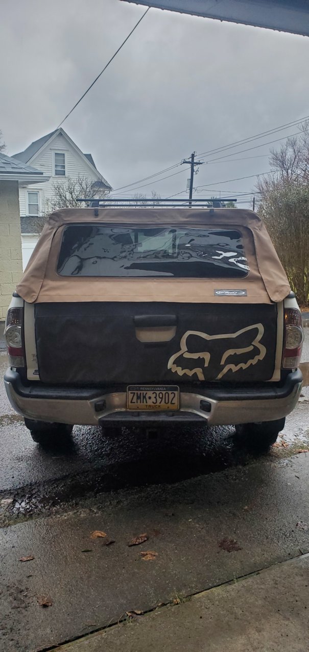

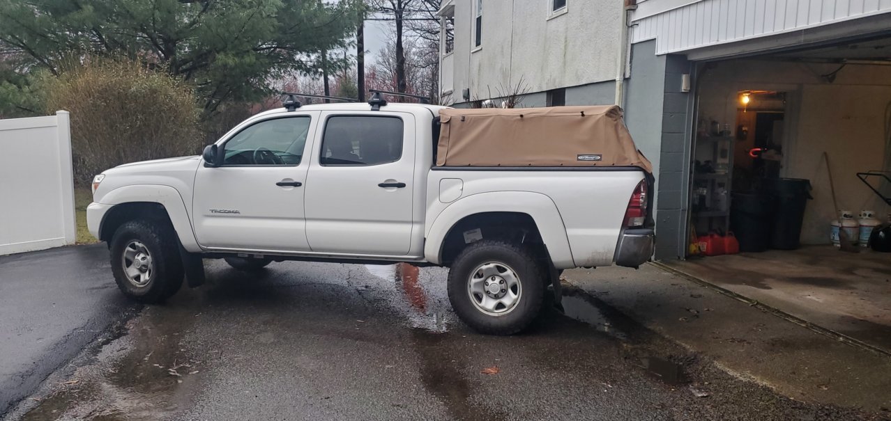

    Did you drill through the softtopper to attach the 3rd light to the bar? I installed my topper yesterday and followed your instructions for the brake light and all worked great!! Right now i rigged the light on the inside hanging from the bar and you can see it through the window.

    I just cut a slit big enough to slip the wires through.
