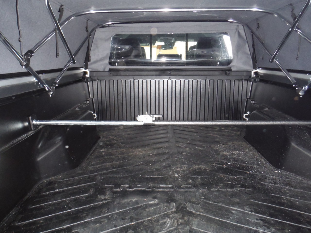

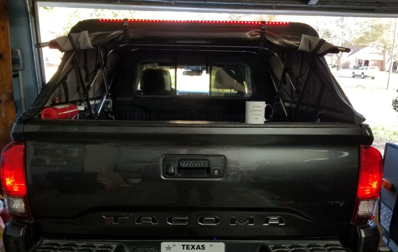

    Ranked most important to least:
    • 3rd brake. Was a 36" strip, I've since upgraded to an 8" motorcycle taillight. It's so much brighter now.
    • 3/4" rubber grommets on the tailgate bar. Keeps it from sliding when rolled up
    • Softopper doggie window. Love rolling that up and opening the slider on a cool day.

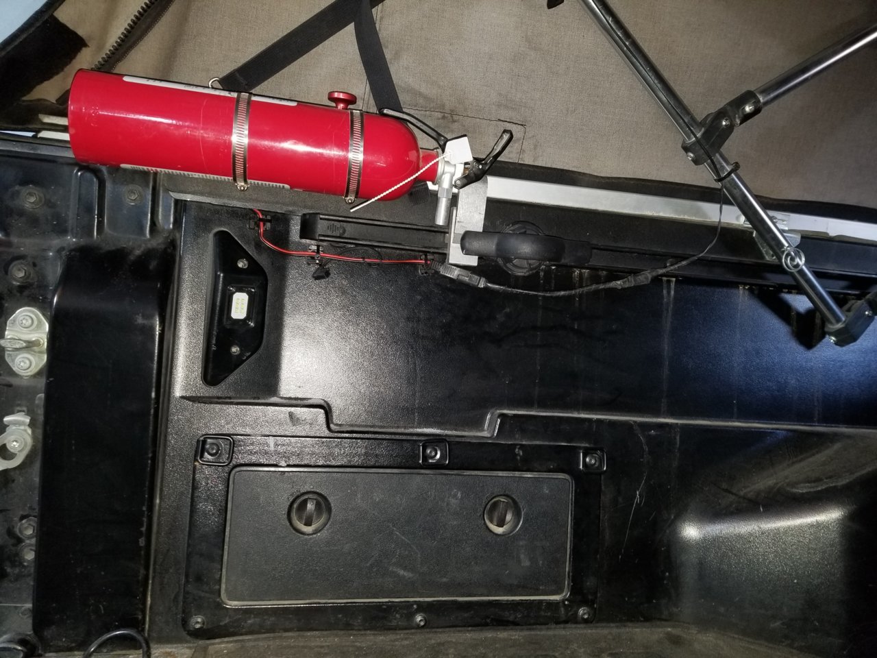

    • Fire extinguisher quick release mount. Fortunately not used under distress.

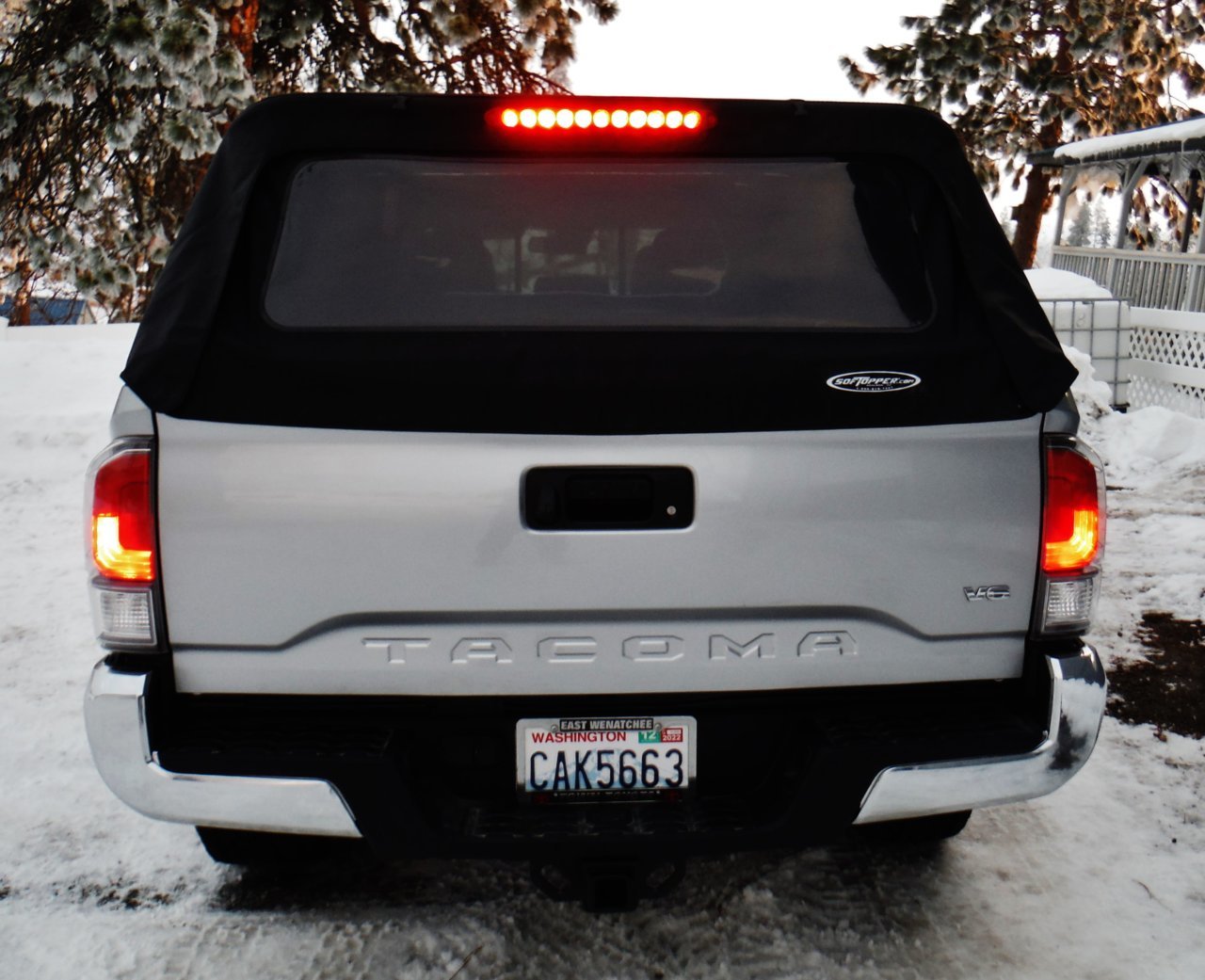

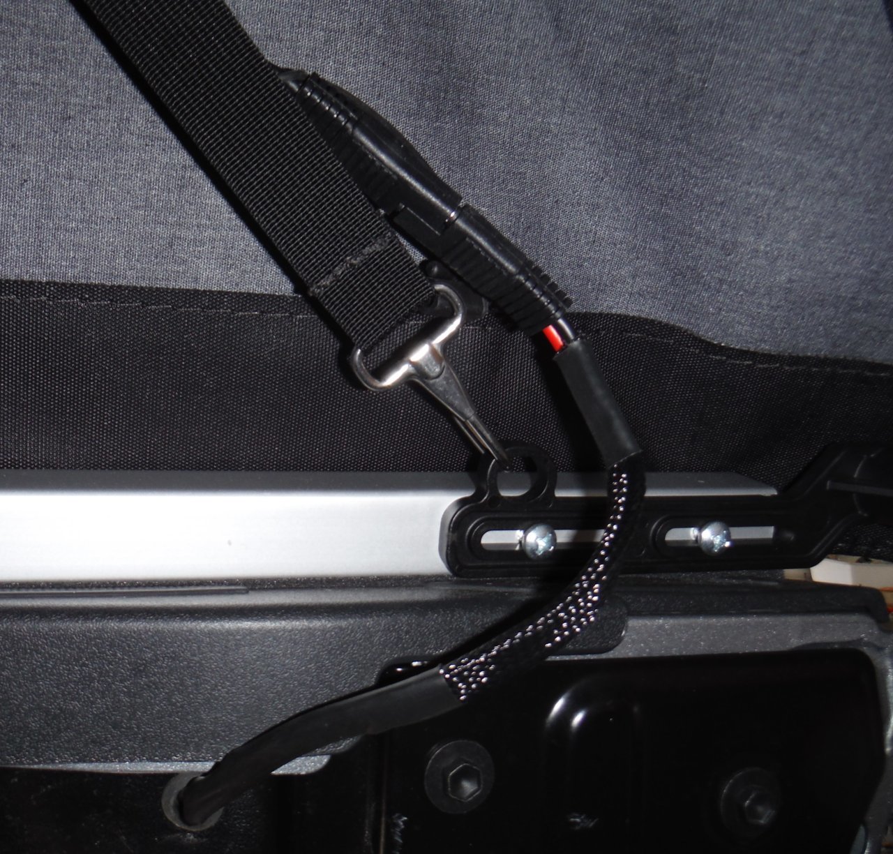

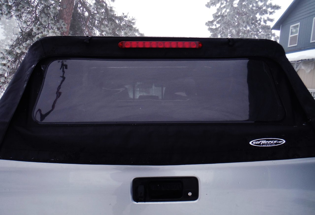

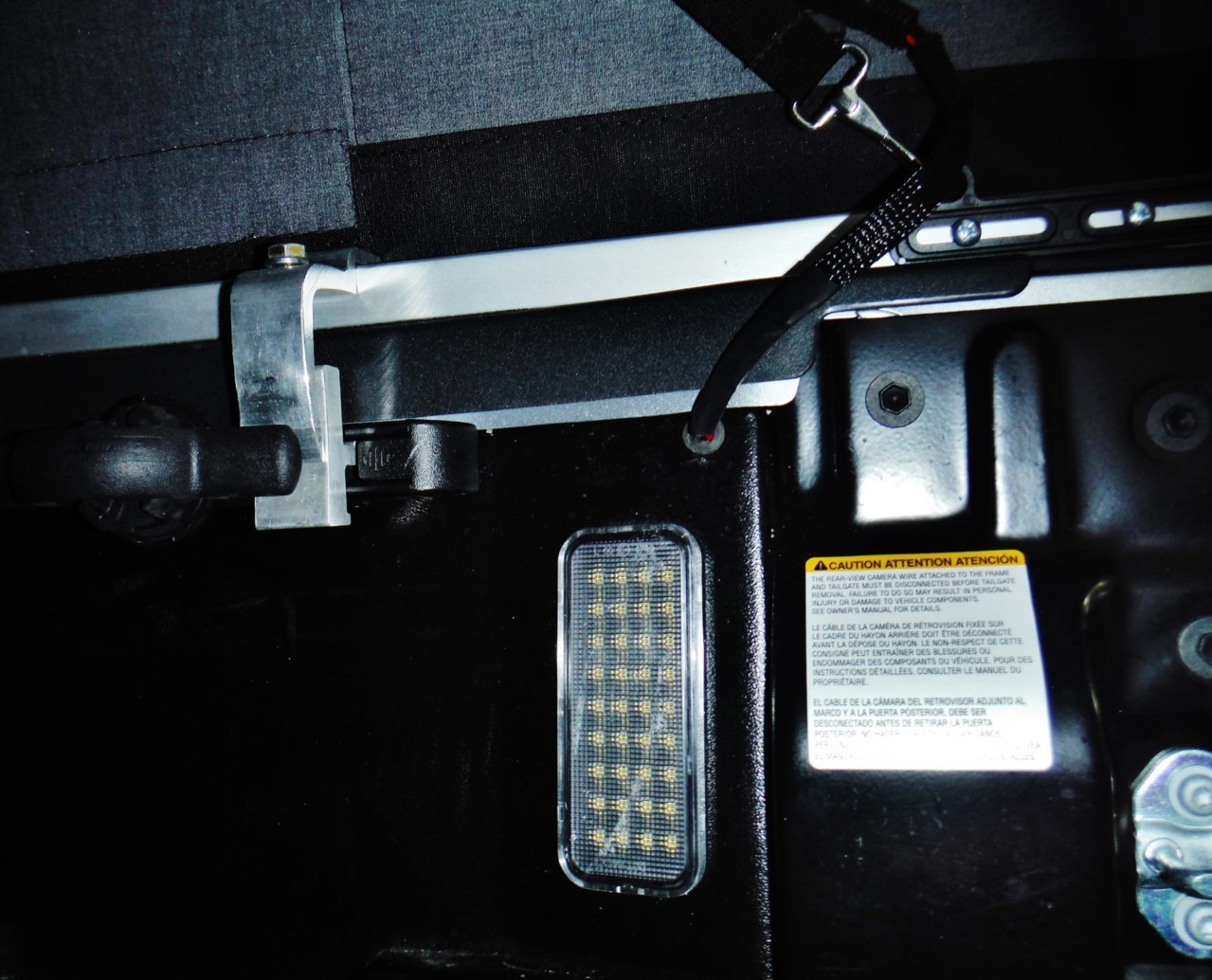

    Here is my 3rd Brake Light install. It unplugs so I can still remove the top easy if I want. Little wire shows just enough to get to the light. Used the Adapter off here to tap into the Break Light wiring real clean Plug and Play. Used a wood burner to make holes in the top and put Steel Eyelets in them for the stainless steel bolts. Used a Leather Strip to back up the light for more strength to bolt thru. Nice and brite day or night. Installed my Bed LED Lights too.

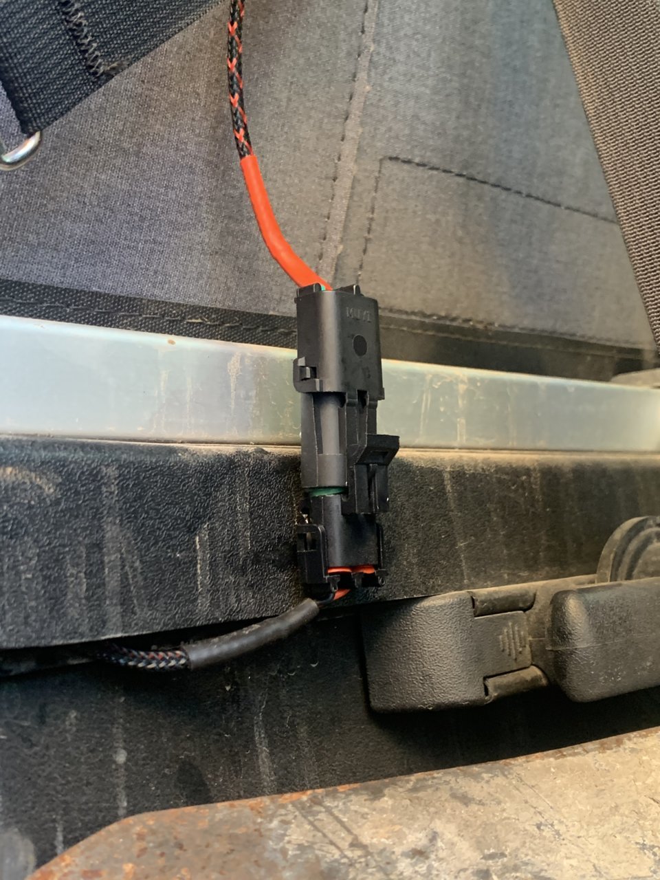

    Reviving an old thread here, what connector/mount did you use? That looks clean.

    Any deustch connector will work. I had a bunch from doing projector retrofits over the years
