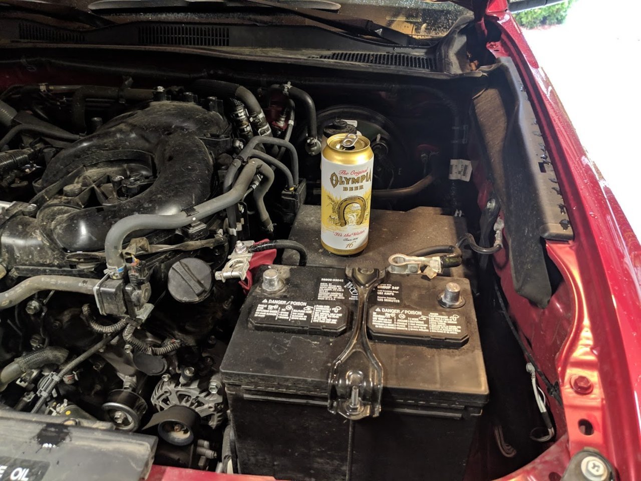

    Battery disconnect:
    -- After you flash and start the engine briefly to confirm the tune is good, then shut it off
    -- Disconnect both battery terminals completely
    -- Touch the terminals together for about 10sec to completely drain down the systems
    -- Wait another minute or so
    -- Connect positive first, then negative
    -- Start and idle the engine for 8min
  8. Apr 12, 2019 at 3:42 PM

  9. Apr 12, 2019 at 3:46 PM
    #2609
    tonered
    tonered [OP] bartheloni
