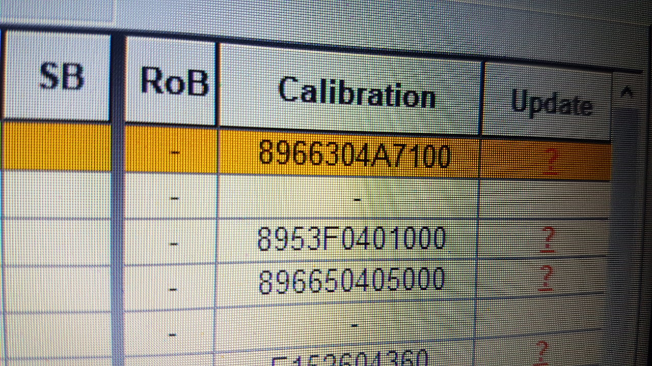

    Go in and complain of a surge around 40mph and ask them to use the Techstream and perform a health check. The techstream will display that there is an ecm update available and ask them to do the update for you.

    New software calibration ID. I'll be sending Matt a copy momentarily.

    That how the tsb reads but I only had a issue in second gear right after the shift from 1st and the truck would stutter then clear up. I does happen in third but you don't feel it as much because of the different ratio. With the new software it's gone and the truck is very smooth. If you go complain of exactly how the tsb reads and you should be able to get the software update.
