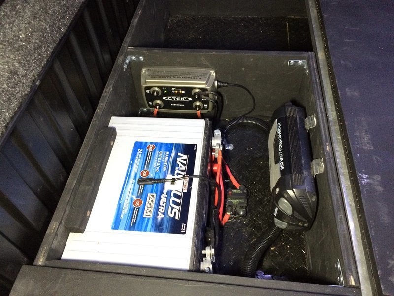

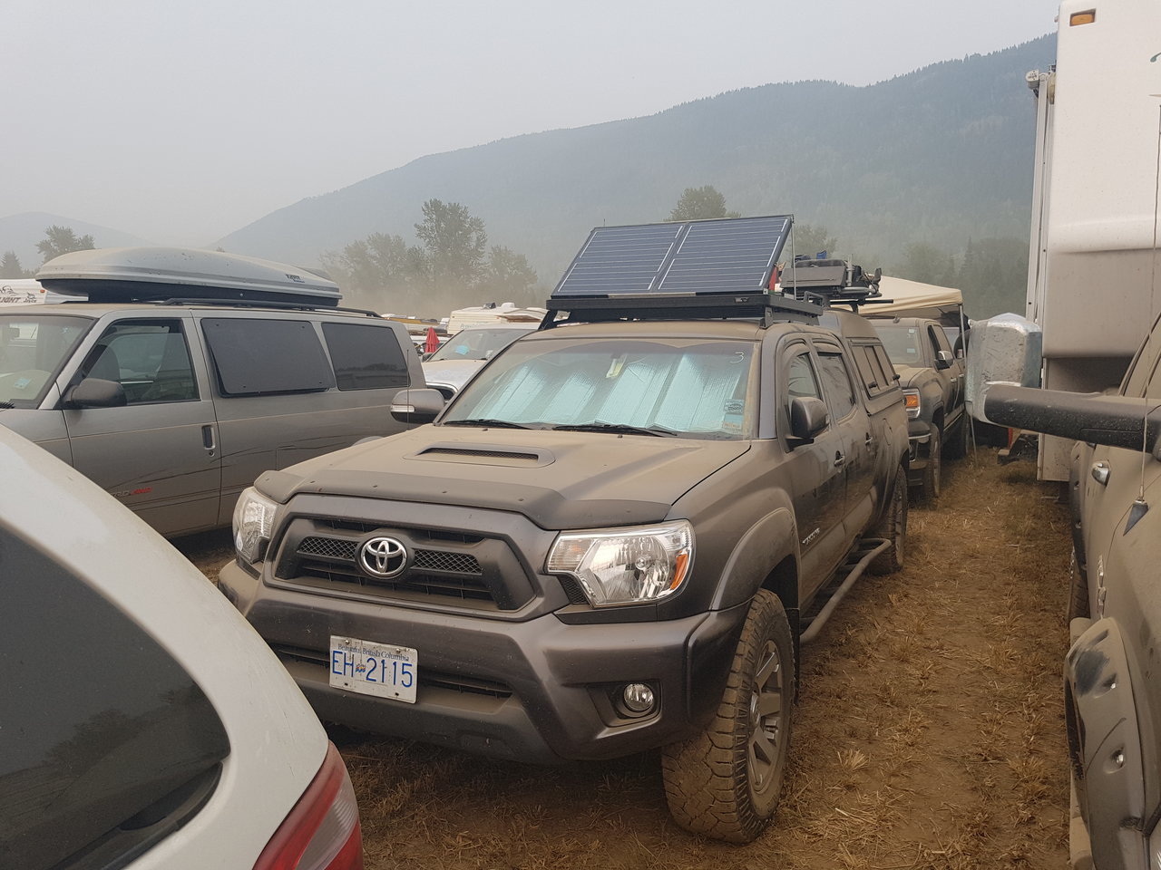

    Get a CTEK d250s DC-DC charger and solar regulator. It's a MPPT charge controller, DC-DC smart charger (alternator charging). It will charge an auxiliary battery off solar and off the alternator when the trucks unning. If your aux battery is charged it will also back feed the starter battery and charge that off the solar.
    This is the system I have in my truck.
    CTEK Dual d250s
    Group 31 AGM deep cycle battery (105ah)
    2x50w panels on my cab rack on a custom tilting mount.

    I also use a CTEK Dual d250s, dual inputs ALT and PV. I also have a Morningstar Sunkeeper 12A under the hood.

    Pics of the CTEK setup?

    Are those Instapark panels? Nice set up btw!
    I have it all mounted underneath my bed platform.
    ACOPOWER, I got them off Amazon.

    Sounds like you have a nice setup. Is your fridge eating most of that power? We just have a two-way, so it's on propane while we are boondocking it. I doubt my 200w system could do it if we had our Norcold running off 12v too.

    Sweet, I like how you set it up.

    Brilliant idea- a cover box! You are right though- those panels are tough, I like the material they are covered with.
