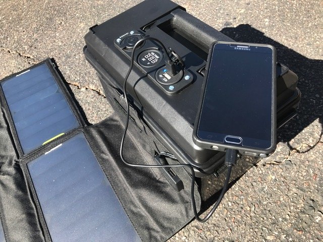

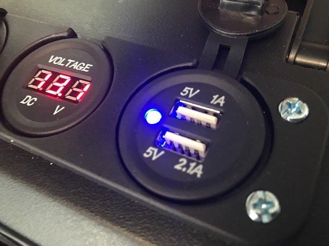

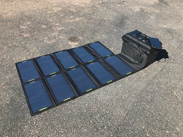

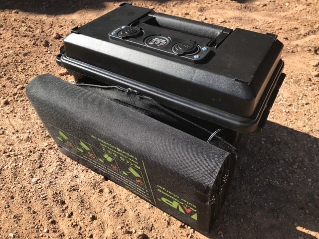

    We've built some small portable units we carry in the truck for camping and set up once we get to site but may look at doing something like this on my roof rack.
    Here's our portable set up that houses a 12V LI batteryIMG_0830.jpg IMG_0831.jpg IMG_0836.jpg IMG_0840.jpg ...

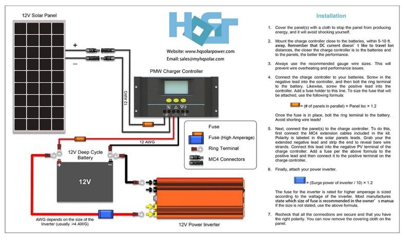

    Does anyone have an idea as to how I would create a setup like this using an additional battery that is on a separate circuit completely? I want to have an aux battery that is charged by a solar panel but is not charged by the alternator. Ill most likely mount it in either the engine bay or inside the shell but im wondering if the charge controller would still work with that configuration.

    You need to follow OP's setup and simply just connect it up to the aux battery as opposed to the main battery. That is a very simple 'off grid' set up.

    What he said ^^ same setup, just route the output from charge controller to aux battery, not main battery.

    Here's a pretty basic diagram on what to do. Depending on your end loads (meaning if they are AC or DC), you can add a small 12v inverter.

    Great diagram, thanks again for the info. One more question though, that seems intuitive. If I was going to add an aux fuse block to use with this configuration, wouldn't I just connect it to the Load outputs on the charge controller, and then wire everything through the aux fuse block?

    Yes, that will work as well.

    Another thing, just be sure you have the panel ISC (short circuit current). It's on the back of the panel, multiply by 1.25 and thats your fuse size needed.
