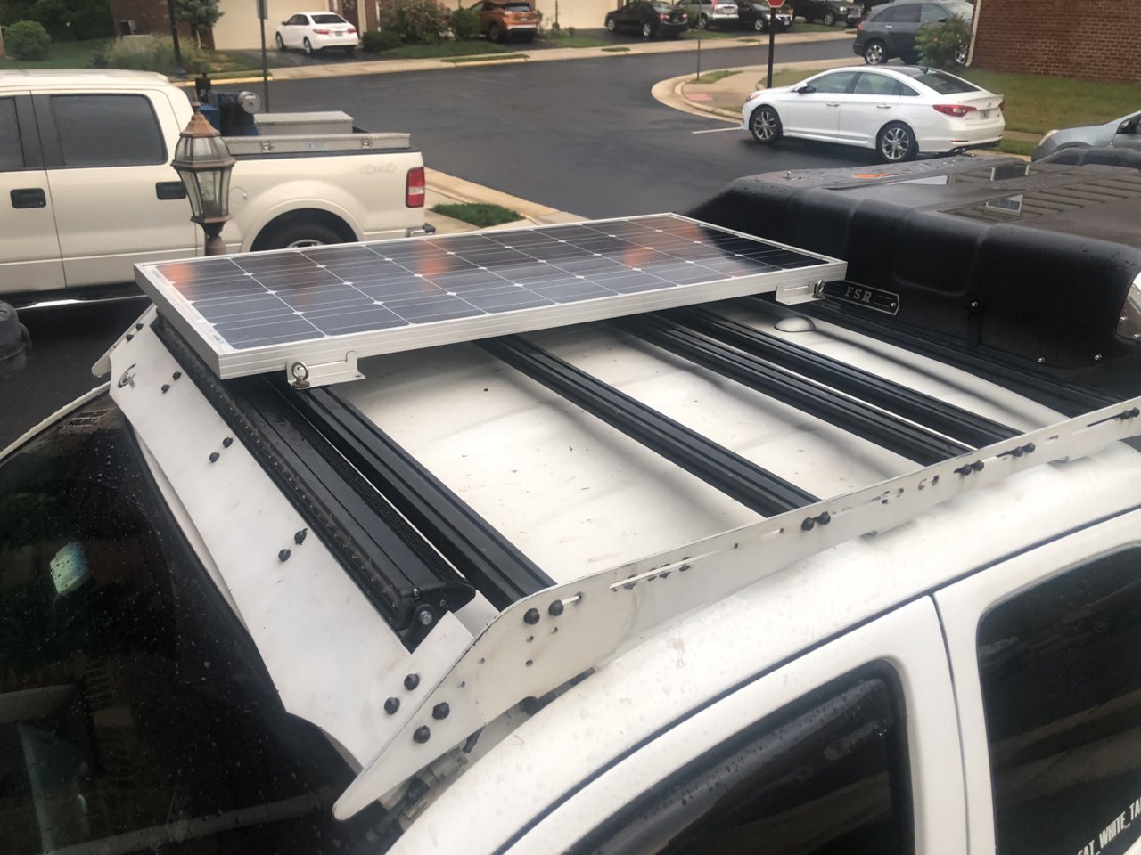

    @fatfurious2 Do you have any wind noise placing the panel in the rack like that? I have a 1x100 watt goal zero panel mounted on top of my cab rack running left to right across the vehicle, and it feels like an actual sail on my truck. On the highway a slight crosswind will actually move my vehicle. I've had to take it off because it is so bad on roadtrips. I'm curious though if you've had that issue with how you've placed yours.

    Yea I think when there is cross wind, i can hear a howling. I didnt do anything about it though. Or maybe try to make the panel flush with the cross bars instead of on top? I don't know how id do flush though.
    Ive had mine setup like this for a few years. Im getting ready to take my prinsu off to sell. I want to upgrade to a 160w or maybe higher. Im getting a go fast camper, and im going to try to mount it flush up there.

    I have a Baja rack with my panel going the other direction as yours, and it's awful. Mine also sits on top of my rack since it's a mesh floor and I don't have other options. A previous post on this thread showed the panel placed under the prinsu rack crossbars which is cool and might make a difference. I just got a roofnest falcon and it'll overhang my cab by about the same amount as the GFC so my cab rack has to go. I'm thinking about doing these flexible panels and just going directly onto the cab roof. That noise from the cab rack drove me nuts. The idea of putting it on the tent is also one I had, but just means I need to keep the tent on full time.

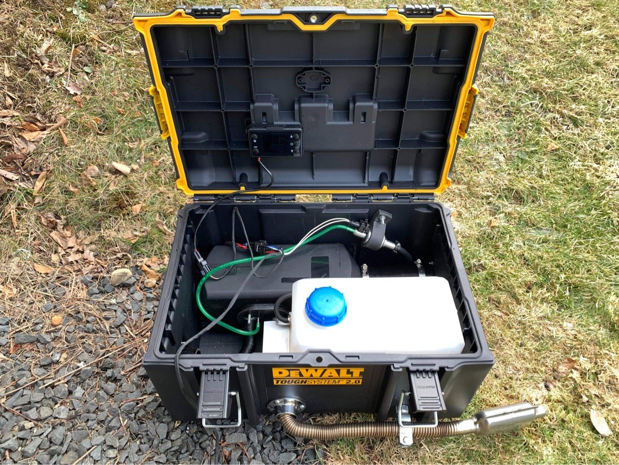

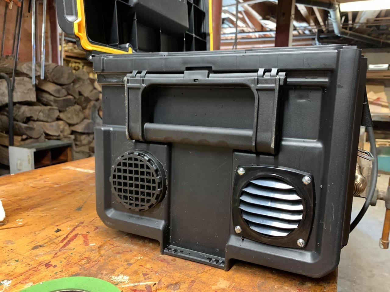

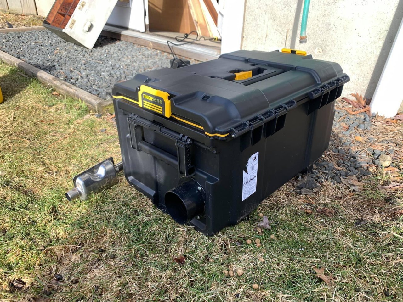

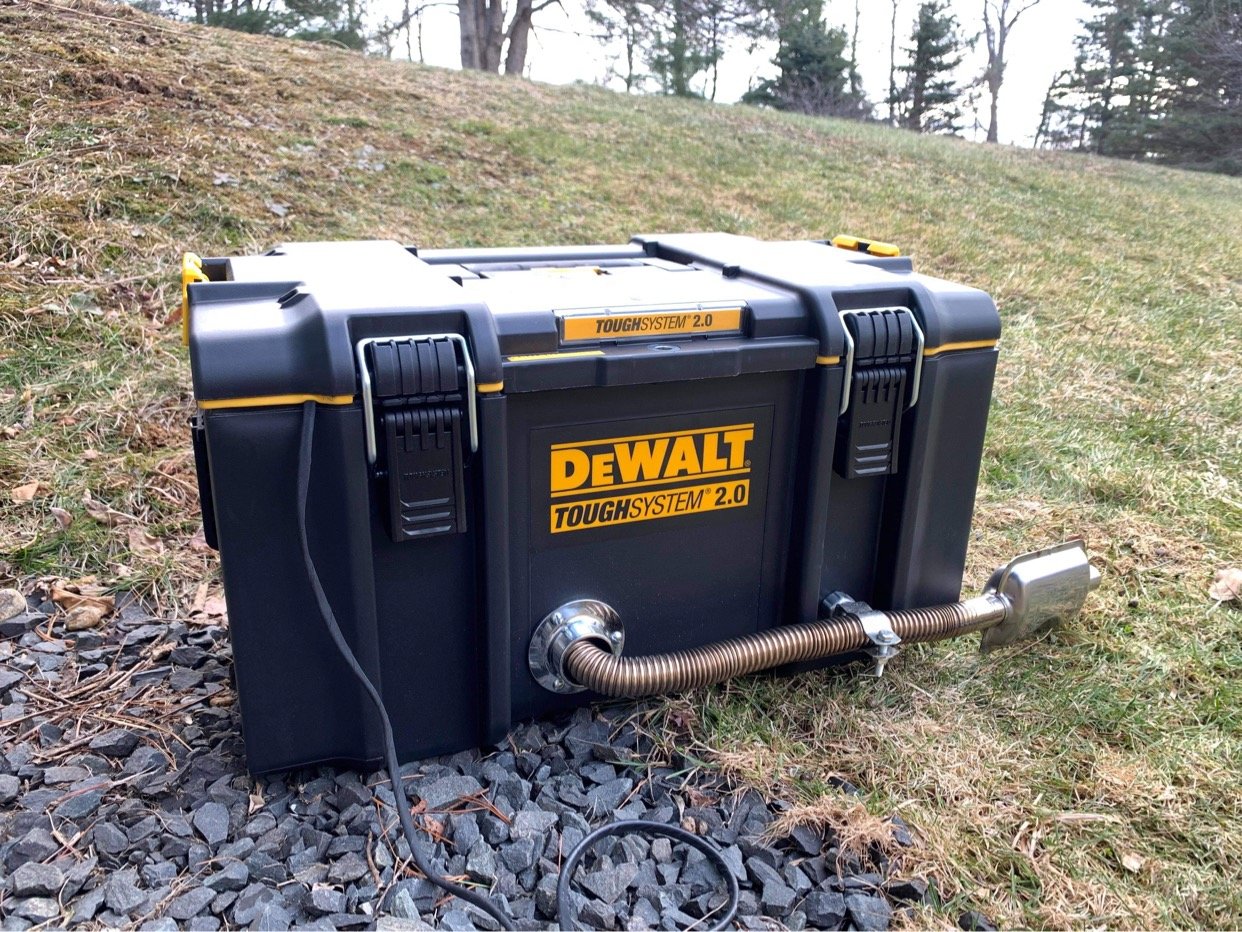

    I have a diesel heater that I set up in a tool box so it’s easy to travel with. F4E3BCCB-D7F4-40F2-8AFC-9C75CFAFA82B.jpg F7DD8F64-6AE0-46BF-83C7-AF569E13846C.jpg

    @Hyland33 that's awesome! You have it ported in through a window?

    I have an RTT and I run insulated tubing up and into one of the side windows. Keeps it nice and toasty year round

    Guessing that's pretty quiet being in the tool box? If I go that route I'd likely sit it under the bed and drill a port through where the left cubbies used to be on earlier 3rd gens. I'm not trying be completely covert parking lot camping but also don't want to listen to a noisy engine either.

    Yeah it’s quiet in the box. Can’t hear the fuel pump tick at all. I added a 12v outlet in one of the bed cubbies that I plug it into and I put the box under the truck at night.

    Nice! Beat me to the next question! If I go this route (heavily leaning towards after doing some reading) I'd want it outside the bed for space & venting reasons. Think about sold on this solution.

    This is sick! I was going to install my diesel heater under my bed platform but I like this idea more since it's portable. I'm going go with this box: https://www.homedepot.com/p/RIDGID-...C-_-searchViewed-_-NA-_-205440481-_-N#overlay
    I'll probably send the heat into the bed via one of the cubby hole things on the side, and add a cap or something when it's disconnected.
    What fuel tank did you go with? My heater came with a massive 10L

    Mine came with the smaller 5.5L tank. I bought one of the all in ones originally and ended up moving everything into this box after a few uses. I didn’t like how tall the all in one was. Too tippy in the back of the truck on the trails.
