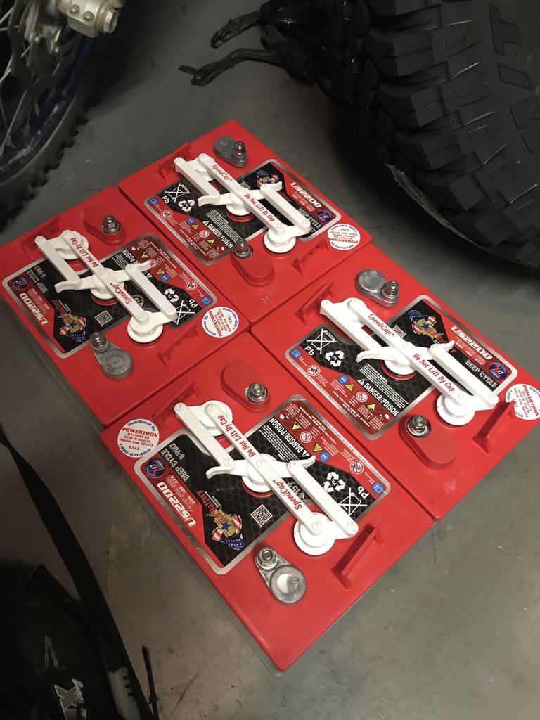

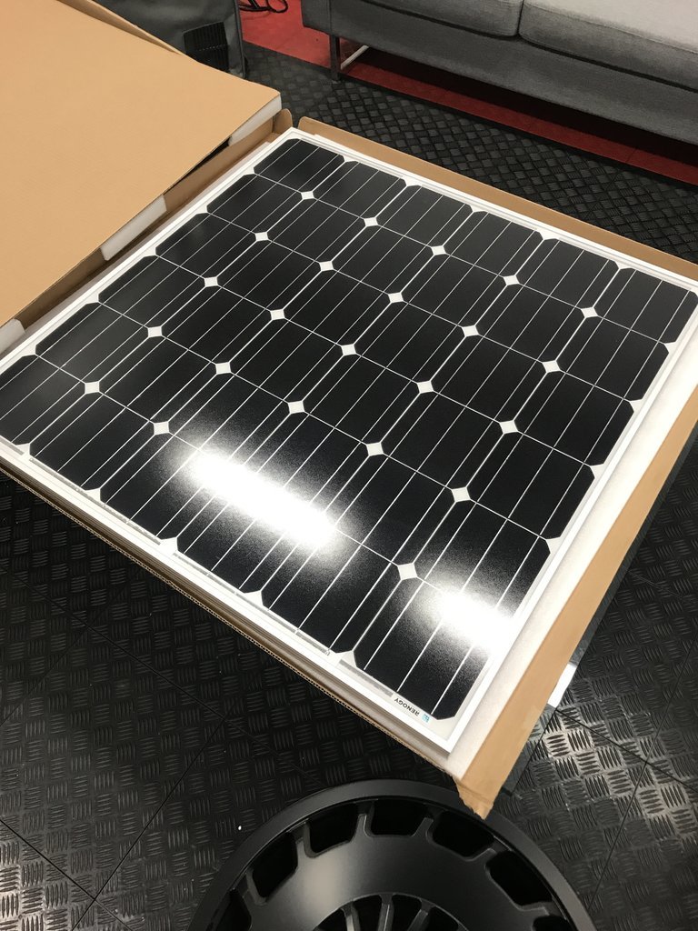

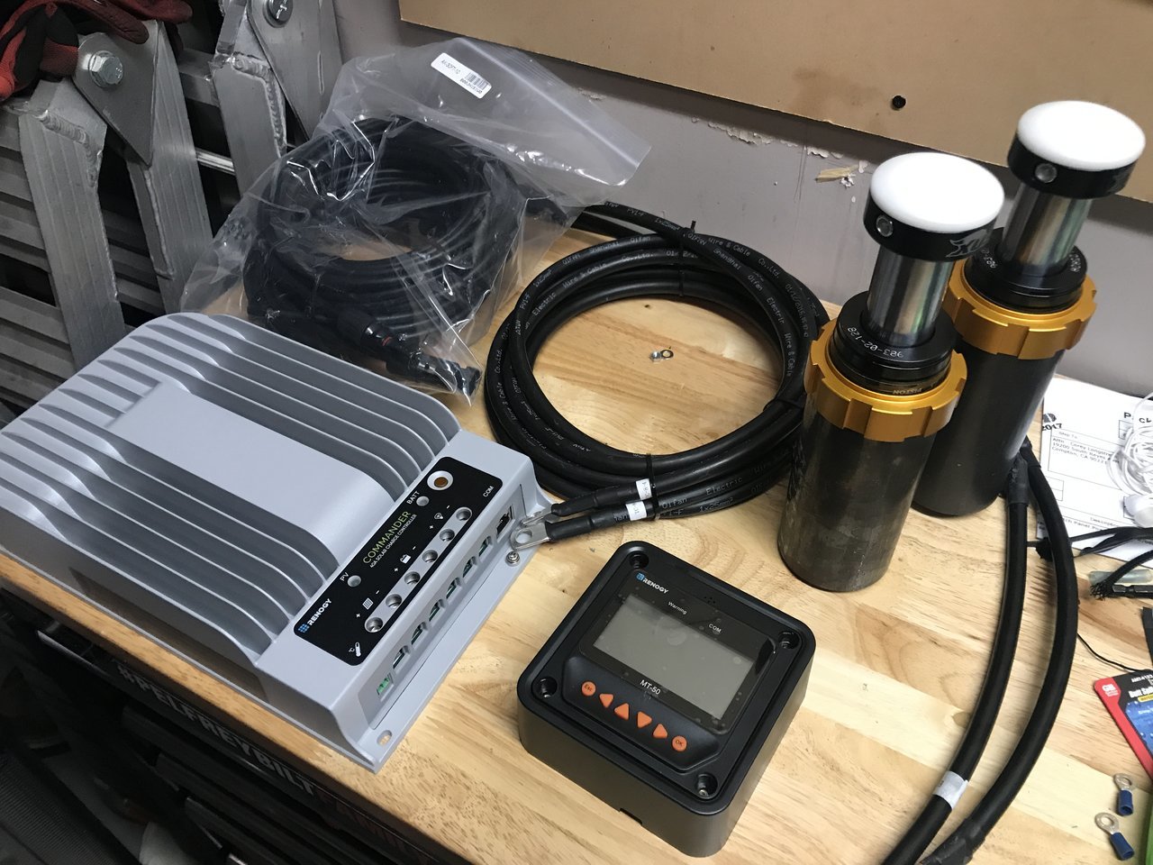

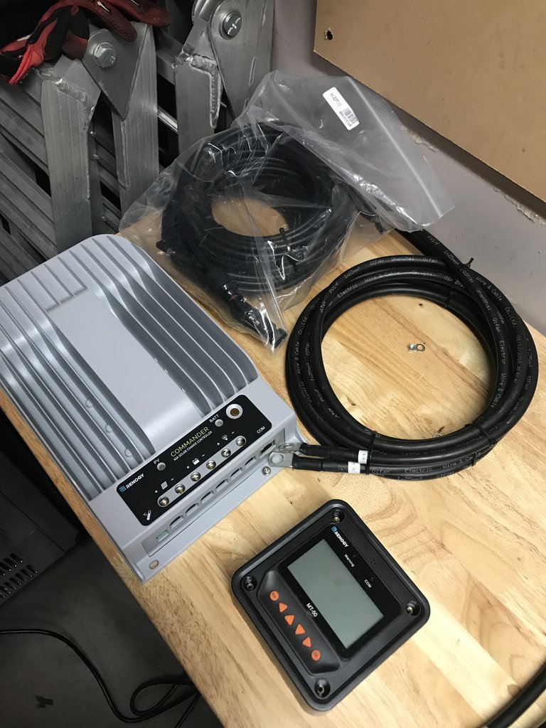

  15. Jul 16, 2017 at 2:35 PM
    blackohio
    blackohio [OP] Well-Known Member
    Jan 22, 2016
    #175780
    2,542
    Cliche Guevara
    white mudflap
    parts.
