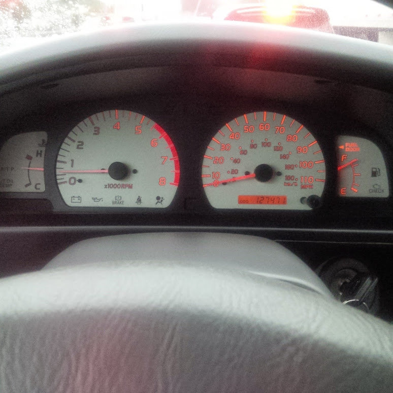

    anyone have the issue of a bulb burning out in the dash cluster? I don't think the cluster is bad since the ext power light lights up when i push it. Its only the speedometer that doesn't light up.

    awesome and it has grey interior...I just got my tacoma as well and my cluster is burned out from the left hand side. I figure there are about 4 bulbs, went to the dealer and ask for the bulb left side on the cluster. He says there are about 10 bulbs...He was being a dick, I'm sure he could have helped me out. Anyway I didn't buy the bulb as there are 2 sizes according to him. Each bulb was 7 dollars and change.

    Nice truck! Not a fan of the color but it should serve you well! The dash cluster lights going out is a common problem. My 04 double cab only had 75k on it when I got it and the ones on the temp gauge and half the tachometer were out and still are. Planning on doing an LED conversion this summer when I dump some money in my truck.
    So far, she needs timing belt/pump replacement as well as rebuilding the rear drive shaft. Figured I'd just do my dash lights then, drive shaft will be in the shop for about a week so there will be plenty of time! Going to do my timing belt too to save money.

    My cluster is EXACTLY like this. Someone on here mentioned it could be a faulty fuse causing this. Still haven't checked all my fuses yet but I will start there.

    turn on the lights and hit the top of the dash where the bulbs are out. see if it comes back on.

    Ill try that first then check fuses. If there not blown then ripping the dash apart it is.

    There isn't much ripping involved, I can have the gauge cluster out of the truck given 15 mins. Really only requires a 10mm nut driver (or ratchet with extension), stubby #2 Philips screwdriver, normal #2 Philips screwdriver, and a careful hand.
    I have replaced my stereo multiple times, done the heater core once, and changed my cluster lights a couple of times and pretty much the entire interior of the truck comes apart with just those tools.
    If you need any help lemme know! :)

    smart move and yes its just a light bulb needs replacing, I wish the newer trucks had the black gages, I cant stand those white gages

    The bulbs are easy enough to replace. While you're at it, I'd order all new bulbs, and get a different color. I switched over to blue and really liked it. It wasn't expensive, and I believe they were LEDs. Better to change them all while it's out, then to have to do it over.
    Also, plan on more then 15min to get that cluster out.
