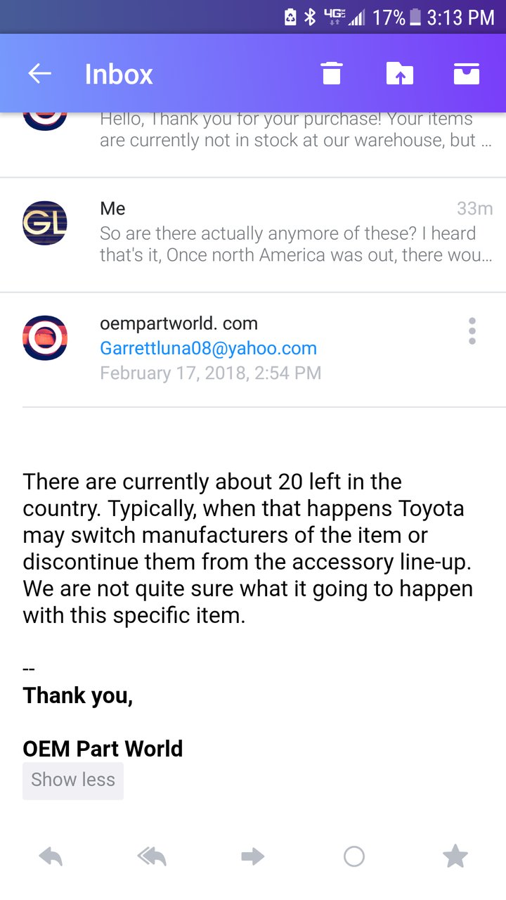

    Odered mine this morning from oempartworld. I got an email back, they're out of stock now but I was told they ordered them. I got this message back....

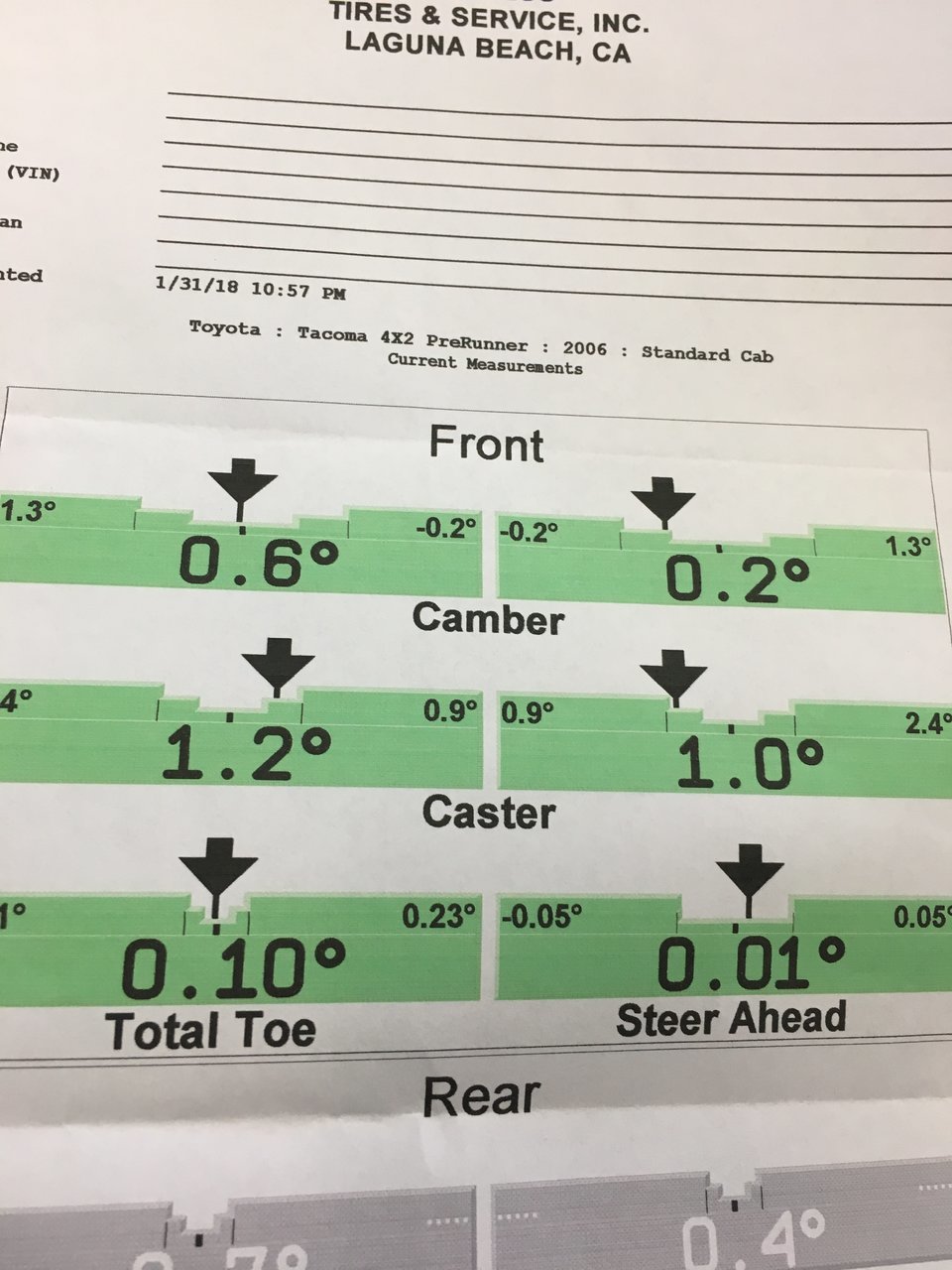

    I installed mine yesterday and had an alignment today. I got 1.75” lift in the front. 22.5” Center hub to fender on both sides. I run Deavers in the rear that give me 1.5” lift. Sits level and rides great. I previously ran Billies 5100 set at 1.75” with stock OR springs in the front and OME Nitrochargers in the rear. I have included my alignment specs with stock UCA. Not perfect but I can live with it until Tuesday when I can tinker with it again.
