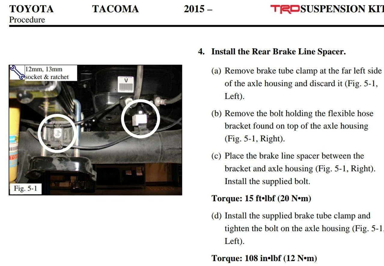

    Just installed front and rear. The kit came with a block with a clamp and bolt. Where is this installed?

    Rear brake line spacer

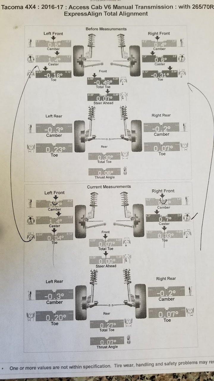

    Thats their thing, good ol' "set the toe and let it go".
    The techs get paid shit on those lifetime alignments, its pretty sad.

    Same guys who want to charge for alignment saying it's necessary after changing tires, huh? lol

    Where did you find these instructions?

    Here you go.
