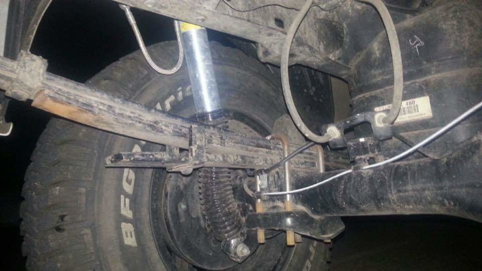

    Seems 99% of you are installing AAL with the Pro kit.
    If anyone has installed a new FULL leaf pack with the Pro kit (and no additional spacers), I'd like to hear your thoughts.

    Yes, with a long one
    No with a short one, but those suck.
    Not all. But I cannot remember if I did 1 or 2 off. My 2015 was probably the 10th set I have run or so, not including the ones I have broken.
    This one was my 2013, I think I removed 1 more clamp on my 2015 than I did on the 2013. And one of the I removed all the clamps and installed new ones on the add a leaf. FB_IMG_1513039903216.jpg
    NMTrailRider[QUOTED] likes this.

    I installed a brand new take off TSB leaf pack (3+1) with a trail gear single add a leaf and netted 3" over the saggy OEM springs I was running. The trail gear leaf were good without cutting clips but there's only a couple inches to spare before they impact the clip.
