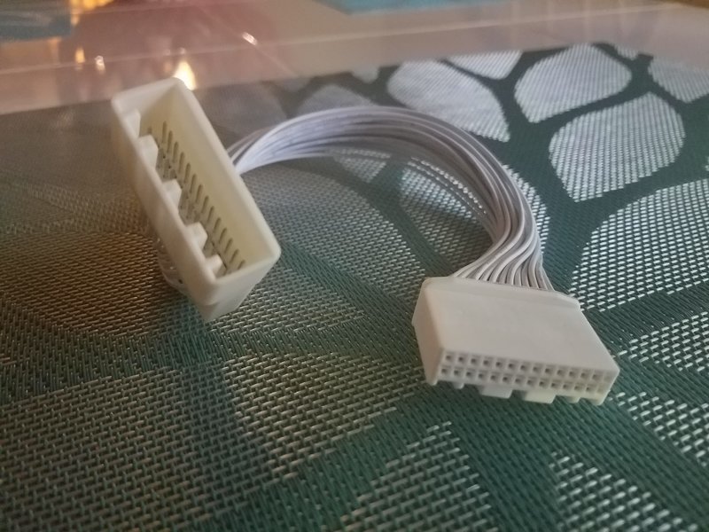

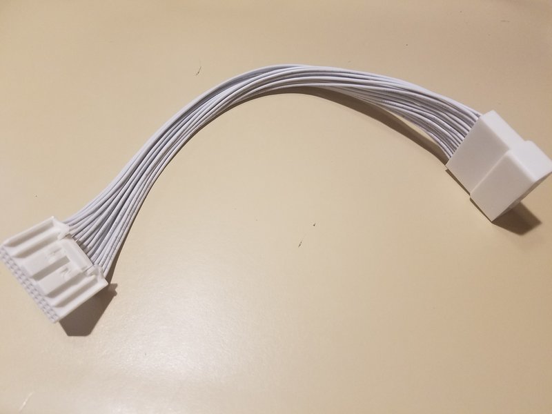

    This wiring harness will allow splicing into the existing 28 pin connection to the head unit without damaging factory harness.
    --Access reverse signal input to allow switching rear view camera on when not in reverse.
    --Access vehicle speed sensor input to allow passenger to input addresses and modify other settings that are normally locked out while driving.
    --Access to aux audio input wires for adding second (same line) input location (i.e. center console, glovebox, back seat)
    --Access to steering wheel control inputs
    --Access to remote microphone inputs
    Compatible with most late model Toyota, Scion and Subaru vehicles with the 28 pin connector.
    Fits 2013+ Tacoma
    Harness is fully pinned, so it has several spare wire leads if needed.

    Check pgs 8-9.
    SPD (Pin 17)
    REV (Pin 2)
    This is the end that plugs to the head unit. The wire on the lower row separated by my thumb is Pin 17.
    This wire on the upper row is Pin 2.

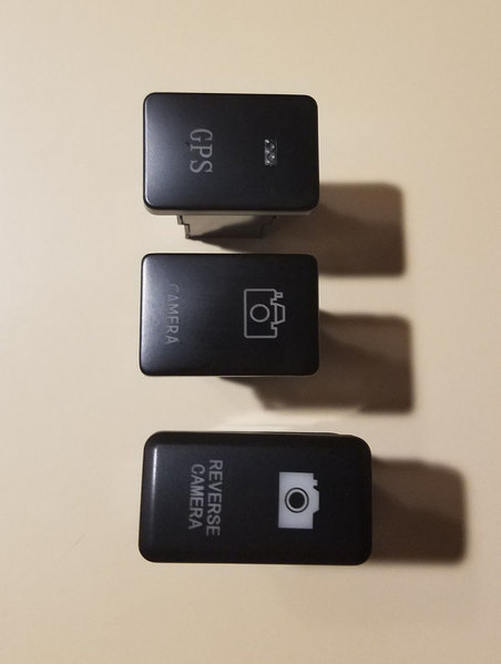

    The AOB switch will have 4 leads. Two go to the switch illumination (+12V, GND). The other two are input/output. So, for NAV, cut Pin 17 and connect the ends to the input/output wires.

    So per the OP I take one wire to the +12 to light. The - to gnd. Then when I cut 17 does it matter which part of the cut goes to the other 2. Or does it matter depending if switch is on or off?
    So I take pin 17 to one leg and pin 2 to other. And if the switch is off and GPS works but I don't want GPS on just switch the 2 wires from the harness? I think I'm over thinking this.
  13. Dec 28, 2016 at 8:46 PM
    jshsltr
    jshsltr [OP] Well-Known Member
    Sep 3, 2012
    #86120
    1,056
    Josh
    St Louis
    Doesnt matter which side wires from 17 are on. It is a SPST switch. In the OFF position the nav lockout should be disabled. In the ON position it should work as factory.

    See my revised post. Dont know what I was thinking. Pin 2 is for reverse camera. For nav lockout, just Pin 17 both sides of cut wire will be connected to I/O.
