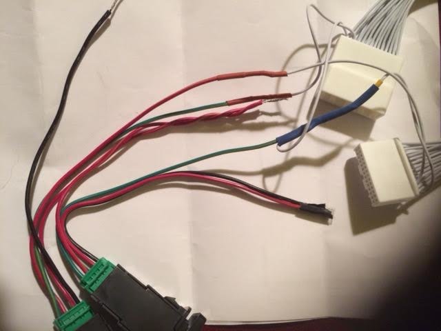

    I am assuming the end you taped the diode to is the HU end.
    Looking at the wiring diagrams from Hoandge and gpd
    the #2 wire should remain connected except for the diode using this SPST switch.
    I hate use the word assuming!
    And what does HU mean? Sorry I'm an OFG.

    I need a diode or I need to know which one to get and a picture showing which way the diode goes.

    No diode needed if you use a SPDT switch. That's how I wired mine.
    Edit: I used this switch from DigiKey: Click Me

    Do u have a write up or a pic how it was wired? Also did you have to use a relay and what size?

    Why would you use a relay? You're not powering anything. This is just signalling.
    I didn't have a chance to write it up, I know @Hoangde has some good diagrams floating around, and also check through this and other threads.
    Basically you tie the center of the SPDT to pin #2 going into the head unit. Then tie one side of the switch to the original input line and the other side of the switch to a 12VDC signal source. I used pin #1 going into the head unit. Don't pull power for a lighted switch from this, it's just a signal line to indicate the ignition is on.
    NOTE: the above is for 3rd gen, I don't know if it works on 2nd gen
