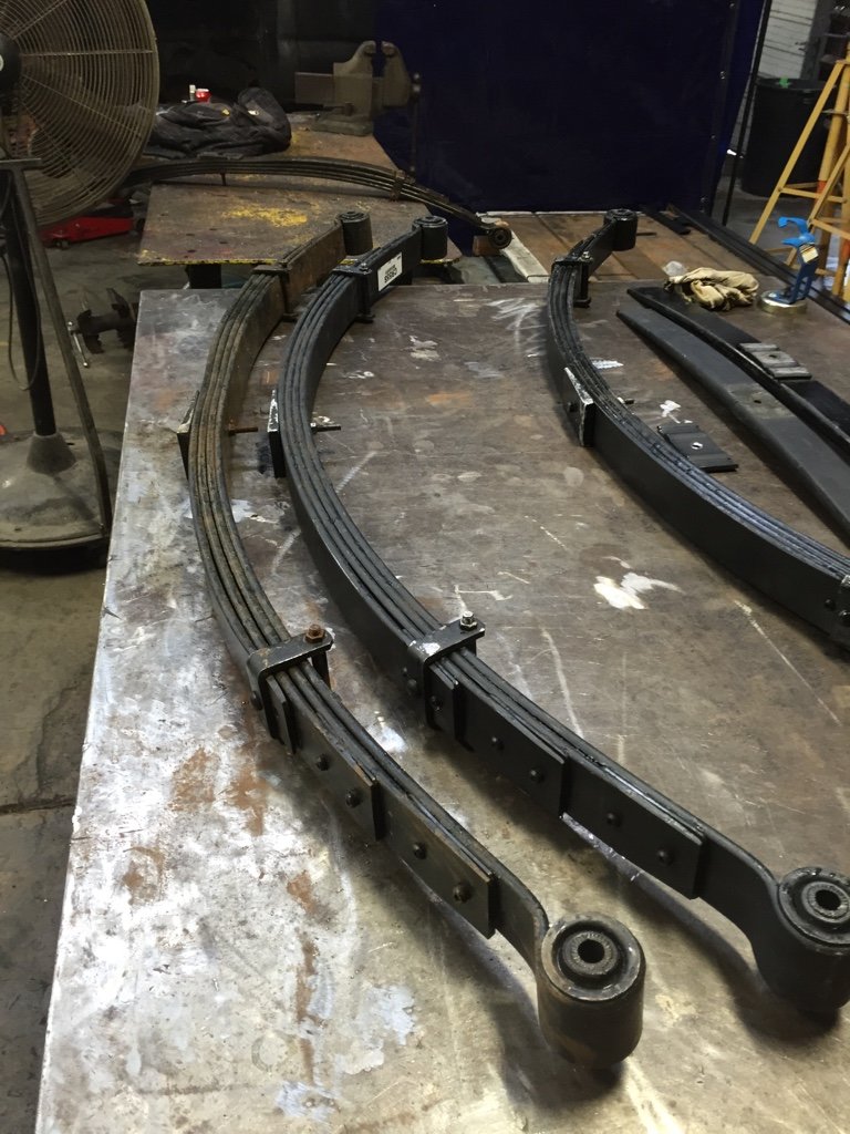

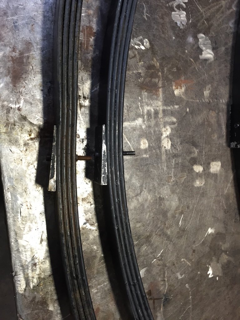

    Old leafs vs. new leafs.
    I'm going to take these by the local leaf spring shop and see if they can do anything with them. If not they're going in the trash, unless you guys can think of another use for them.

    Use them for an off road trailer.......right now!

    5" lift springs on an off-road trailer? Hmm... You might have an idea there. Hopefully the shop can take the kink out of them.

    Those are what my deavers looked like when i took them off. I went with a stiffer spring and bump stopped them correctly. My All pro leafs are now nice and happy.
