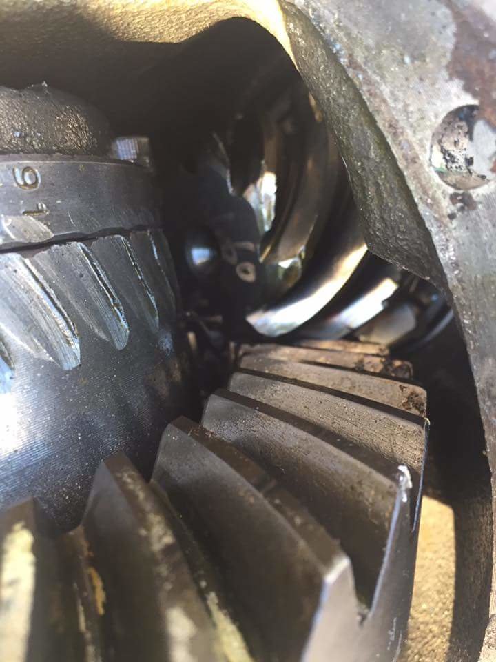

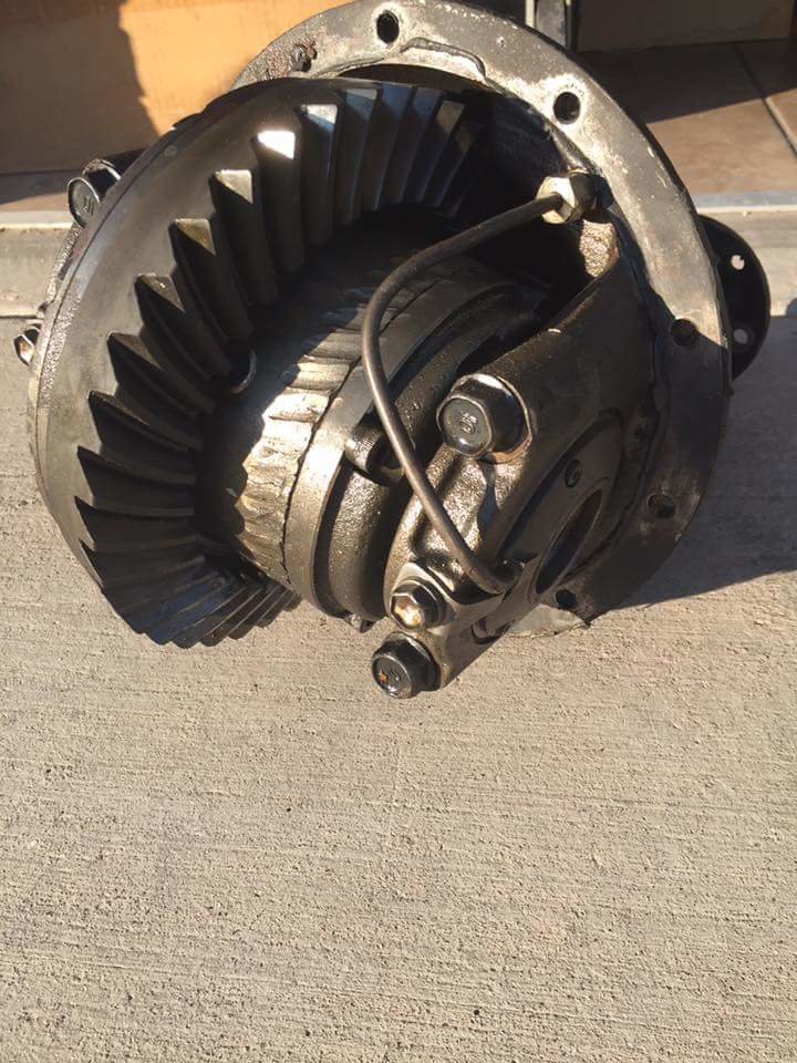

    Anybody ever seen this happen and know if it's bad enough to affect the arb? Guy said the gears went bad and pinion marked up the arb. May be able to trade a guy my 2 3rd members for it.

    @malburg114 I bought an ARB that the pinion got into, it was the new style case (rd132 I think) the grooves in mine were not quite as deep, but when i took it to yotamasters they said its fairly common for guys that are running crush sleeves instead of a solid pinion spacers. They said I would have no problem running it. If it really bothers you arb sells individual parts and you can buy just the case. Not sure if they have discontinued support for the old style though. Taking it to a machine shop and having them chuck it up in a lathe and turning it even again is also an option but im sure removing material will make it weaker. You could have the ring gear face trued while they are at it, (ARB has quite a bit of runout on this, having measured 3 different models)
    malburg114 likes this.

    never seen that before. Those are some serious grooves :eek:
    But it seems like it is just external. I would look for cracks on the case. If there are none I would certainly use it. Those things are really super strong.

    2 3rds for one kind of messed up ARB seems like a bad deal. Offer him 100bucks for it and if not move on, that's my .02

    we don't know if the ARB is really messed up :D
    But yea...good point about the the deal. 100 bux sound good considering the carnage to the case of the locker.
