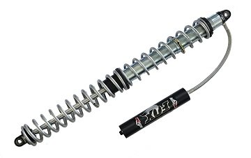

    Next week ordering 5.38’s, front grizzly locker and 14” fox coilovers from accutune.
