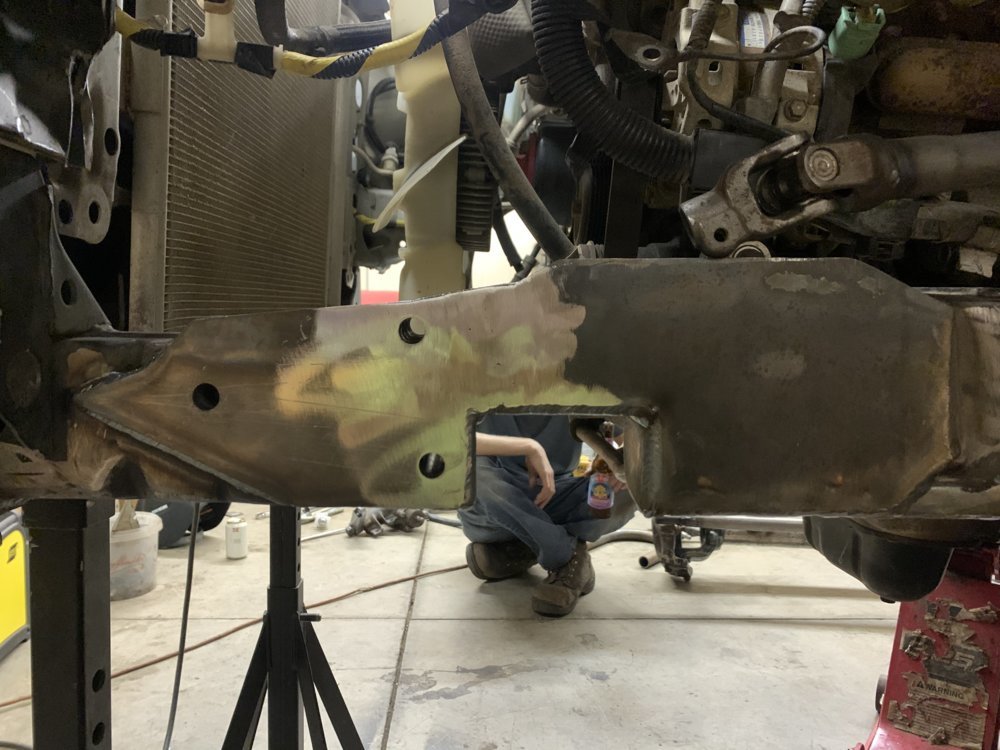

    Question for all you folks that have a greater depth of understanding on the subject of SAS for a 2nd gen. Everyone seems to use a ifs steering box with the pitman arm facing the rear. It looks like a struggle to push the box as far forward to gain clearance without getting into the core support.

    I had poked around at this for a minute and it does work. Assuming links, you just have to be conscious of your panhard and coilover mount/packaging instead of he body mount packaging with a forward swing box. Take a look at Saginaw boxes for forward swing too

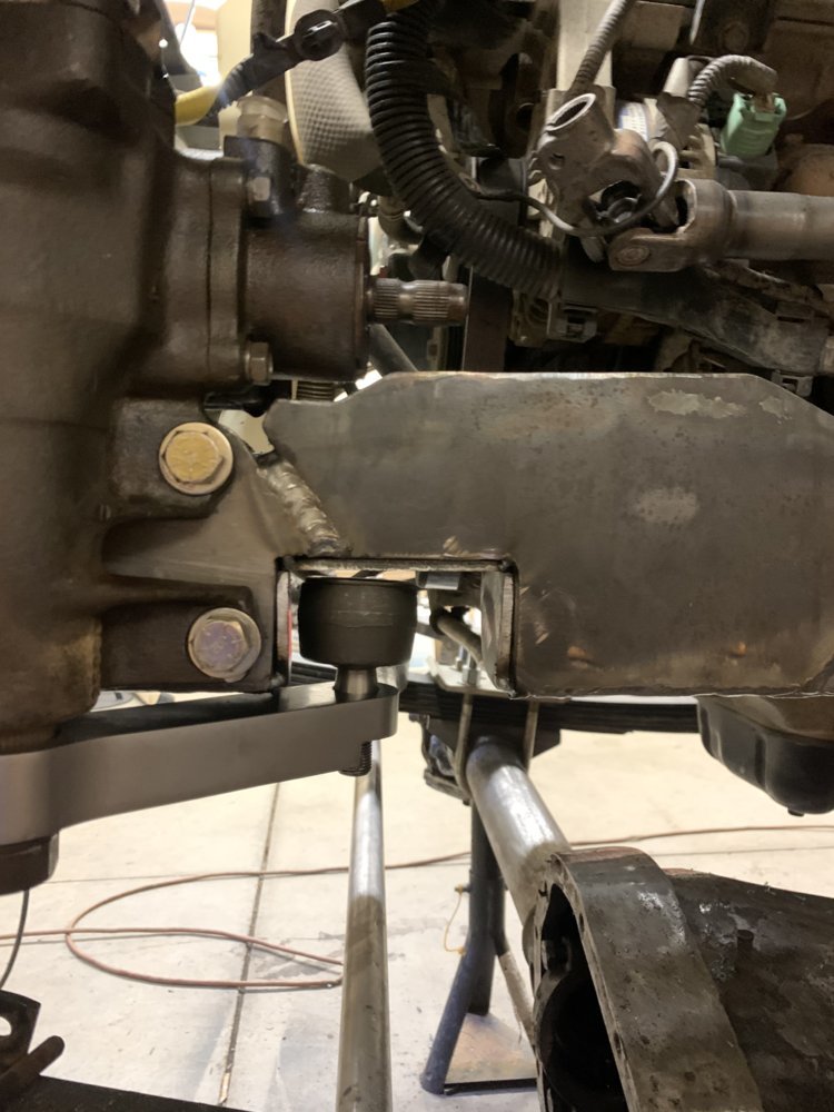

    I have a forward swing box out of a ford truck on mine and like anything it has its pros and cons. Pros are like you identified you can push it further forward without hacking apart the core support. The negative is the box is almost right in the way of evreything, shock hoops bump stops, tie rod and drag link etc.

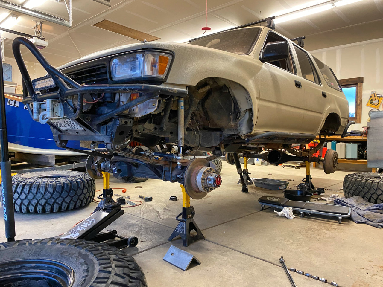

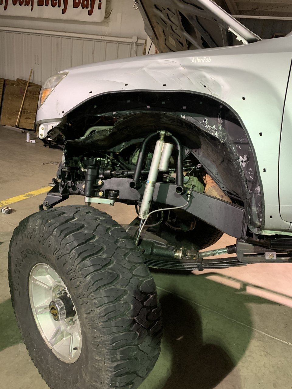

    For me it was hard to find a reasonably priced 60 box. Got the ifs box for $30 and a rebuild kit from rock auto for cheap. Haven’t had an issue. Mine is as far forward as I could get it and I did have some issues with drag link clearing the motor, but I was keeping it as low as possible on leafs. Flipped pitman arm made the drag link higher too.

    Hows that tie rod end do at max drop? Would think it would run out of angle before the axle droooped all the way down but never thought of doing it that way

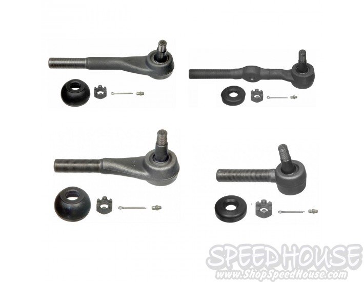

    I tried TRE’s and they bound up. I ended up using GM drag link ends. They take more angle. It surprised me how much of an angle they will take. They don’t bind with my 14in shocks maxed out.
    Check this picture out. They are made different than a TRE. Drag link left. TRE bottom right.
