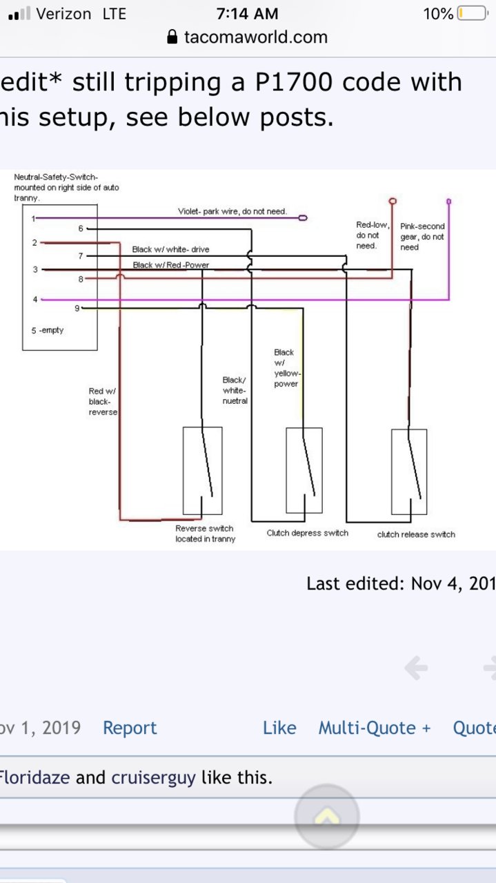

    I followed this diagram and wired into my clutch depress switch, running good this way for 3 yrs
    malburg114[QUOTED] likes this.

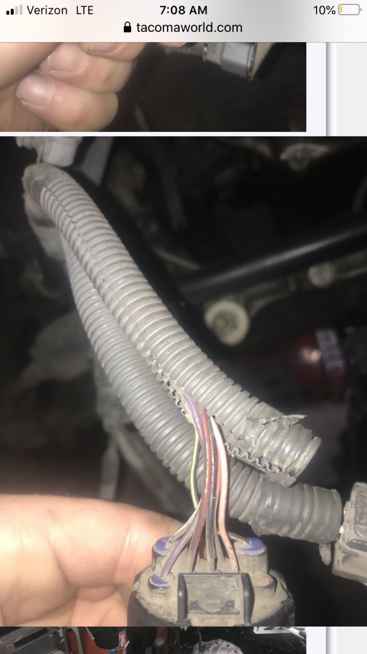

    After lots of research and trial and error I found the plug and diagram for the neutral safety switch from the automatic. Got it wired up to think it’s on neutral and been driving well

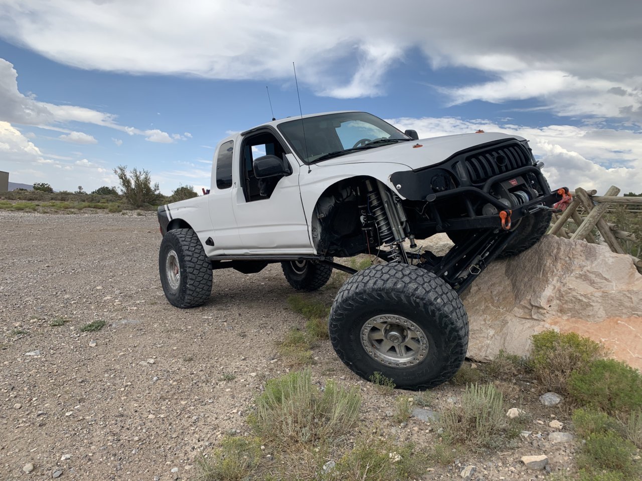

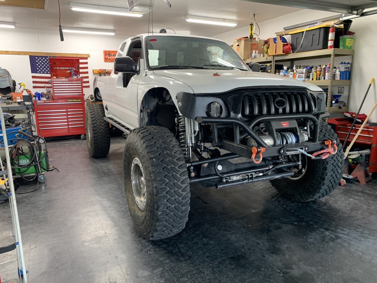

    New tires, 3.4/5vz to th350 and atlas. All the weak points should be gone now48034598-0239-48D1-AD34-E8423E4BDBF7.jpg38149D1C-ED02-41FD-8299-43FBAA08AE91.jpgA0AC8A91-E105-4BA2-9EF4-2CC3CABEB77B.jpg

    how do you like the atlas so far?

    Only been cruising around the stuff near the house. It’s nice. Gearing is decent. Wish it was a 4.3 vs the 3.8 but will see how it is on the rubicon. Sometimes it’s easy to shift. Other times I can’t get it. Very temperamental. But way more confident with the atlas vs the duals I had
    jubei, slander and sparkystaco like this.

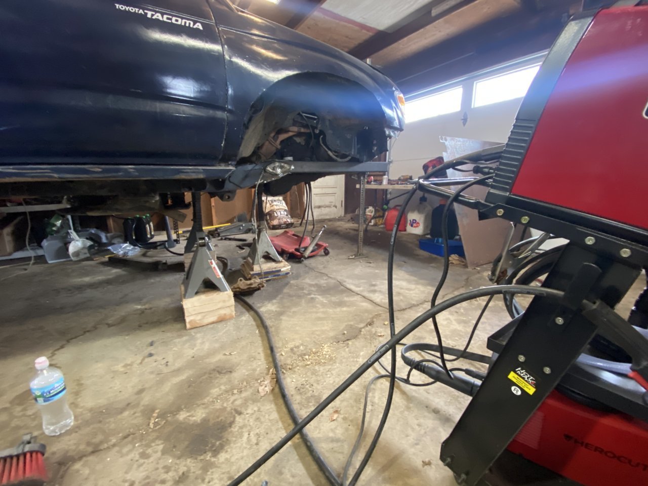

    Question for those that have cut and re-tubed their frames on a 1st-gen Tacoma / 3rd-gen 4Runner. What is the best (cheap) way to hold up the engine while modifying the frame rails? Harbor freight does sell these engine support bars, but placing all that weight on the side fenders has me a little concerned. Anyone have experience with these or have a better idea?

    I put a jackstand under the bell housing
    Team_Jake and bhigbee like this.

    Jackstand on the bellhousing works perfect
    Team_Jake[QUOTED] likes this.

    Took a 2x3 tube and welded some braces to it. Welded a drop off of round tube to the center and suspended it with a ratchet strap. Used vice grips to clamp it to the fender lip
