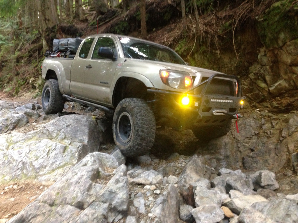

    2005 Prerunner, converted to IFS 4wd and now running 1 Ton axles on 40's. Rock Crawling, camping/expedition and snow wheeling in BC. @VanCity4x on IG for current :canada:

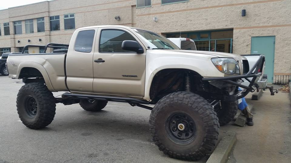

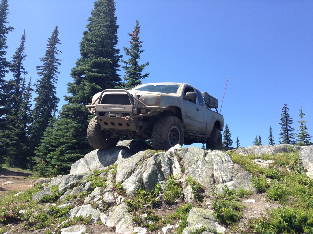

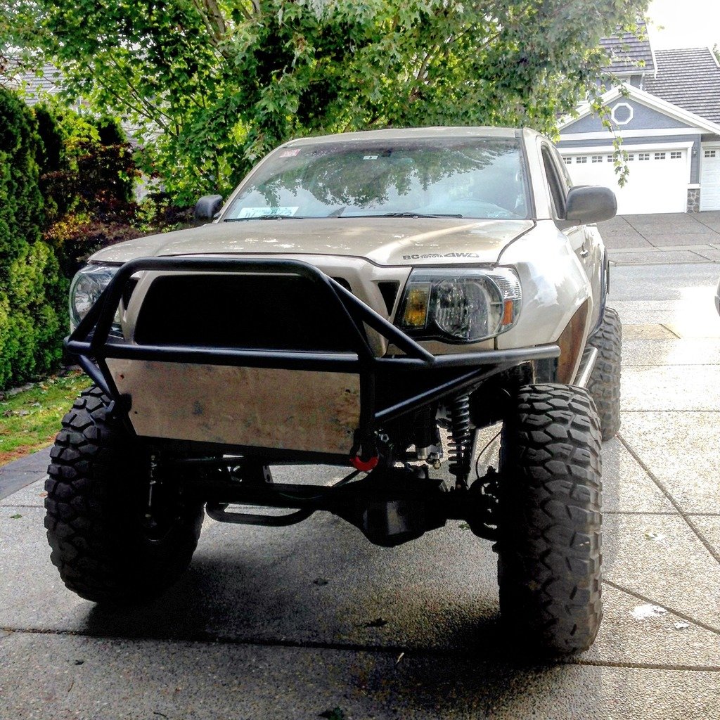

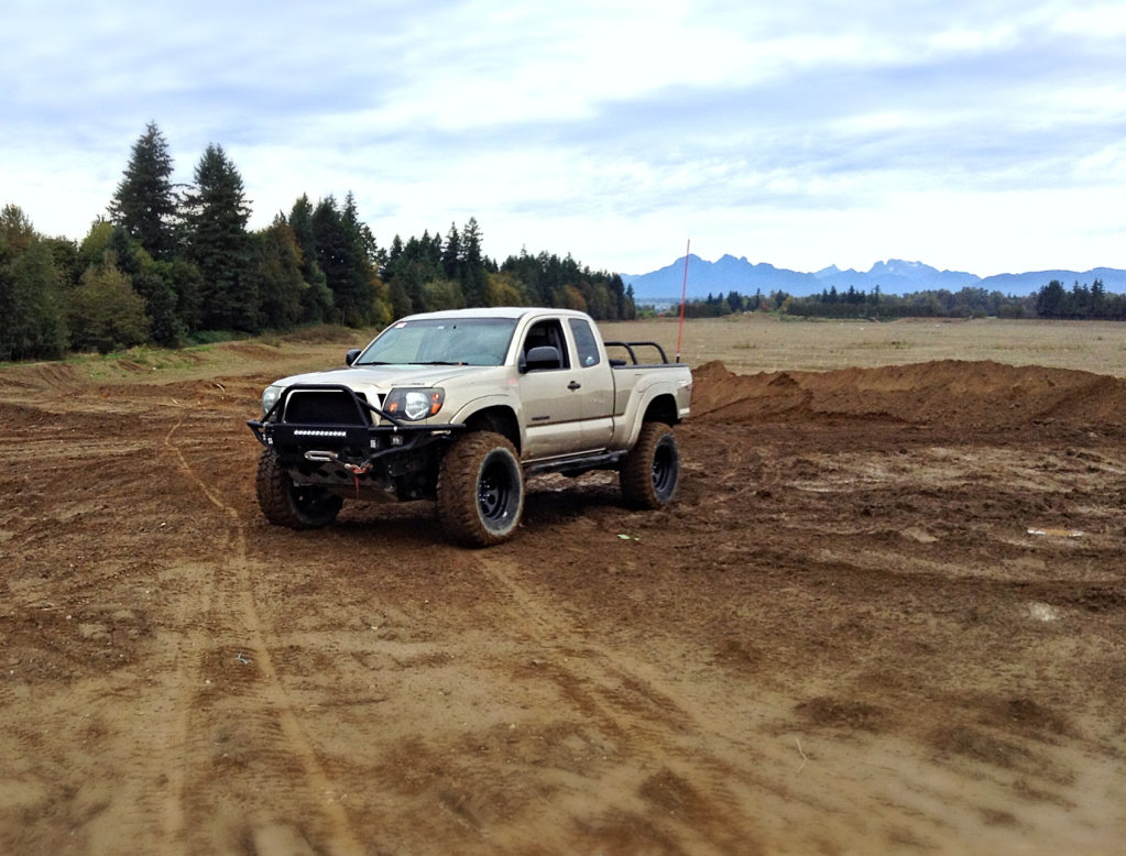

    Here's how she currently sits,

    Drivetrain:
    04 Ford SD D60 Front
    -Ballistic cover
    -Histeer Arms keyed 6 stud ARP
    -35sp units/stubs
    -Warn hubs
    -JK callipers
    FF 14 Bolt Rear
    -Ballistic shave
    -Eldorado custom disk setup
    Front/Rear ARB lockers
    5.13 Yukon gears
    6x5.5 hubs, ARP Studs, Mcguard lugs
    FJC xfer Front Range twin sticks
    Spicer built driveshaft
    Intake in cab
    Kicks:
    42” Iroks on diy beadlocks
    40” MTR Rock spiders
    Armor:
    Custom Front/rear tube bumpers
    Sliders
    Suspension:
    3 link front w/ Ballistic joints
    14" 2.0 Radflo coilovers
    F911 Hardware
    Chevy 63's rear
    14" Bilsteins custom mounts
    Ballistic Frenched hanger
    1’’ 4crawler Body Lift
    Offroad Recovery/Camping Gear
    Engo 10k winch
    HiLift 60"
    ARB CKMA12
    Tepui RTT on custom rack
    Trasharoo
    Exterior:
    Trailer products Fiberglass
    HomerTaco Satoshi Grill
    Rubber bed mat
    Kobalt tool box –Line-x coated
    Lighting
    Hella 4000i xenon Hid’s
    Hella Supertone horns
    Interior:
    Wet Okole covers
    Weather techs
    Cluster/Int LED Swap
    Fat Mat Sound Deadnd
    Scanguage
    RAM IPAD mount
    Audio/Coms:
    Kenwood dd head
    Alpine sps-600 series front/rear speakers
    Alpine V60 5channel amp
    JL 10'' sub w/custom box
    Cobra 18 cb radio w/ 4' Firestick
    2 Baofeng 5W VHF Radios
    Gamin Glo w/ BC Backroad maps on Ipad
    Progress
    KOH/AZ Rocks/Moab Spring prep
    Rock/rear lighting and fuse box
    50W VHF
    Fiberglass boxsides/rear bumper build
    Softtopper
    Trac bar
    Tundra 2uz V8 build/swap

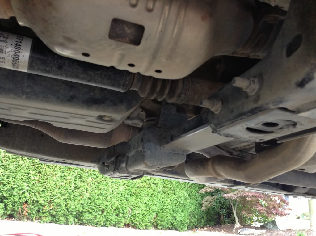

    Details of swap as outlined by the mastermind - http://www.rocksolidtoys.com/forum/showthread.php?t=396
    So to make a conversion of a 2nd gen prerunner possible will need to find all the parts,
    A750F 4x4 Transmission
    VF2A FJ Crusier (Automatic) Transfer Case
    Tacoma Front Diff w/ mounting hardware
    CV axels
    4x4 hubs/bearings
    CV nut/seals
    Front drive shaft
    ADD Harness - replaces ecu
    Custom tranny crossmember
    Modified rear drive shaft
    modified y-pipe exhaust
    +large assortment of mounting bolts, seals and misc parts
    The swap for me was around $3500 in parts not including the ARB or gears. If pieced together properly it can be done for cheaper. Most of my ability and knowledge came from a lot of research and the factory service manual which details all the parts on the truck.

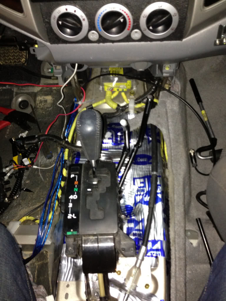

    New Tranny and TCase

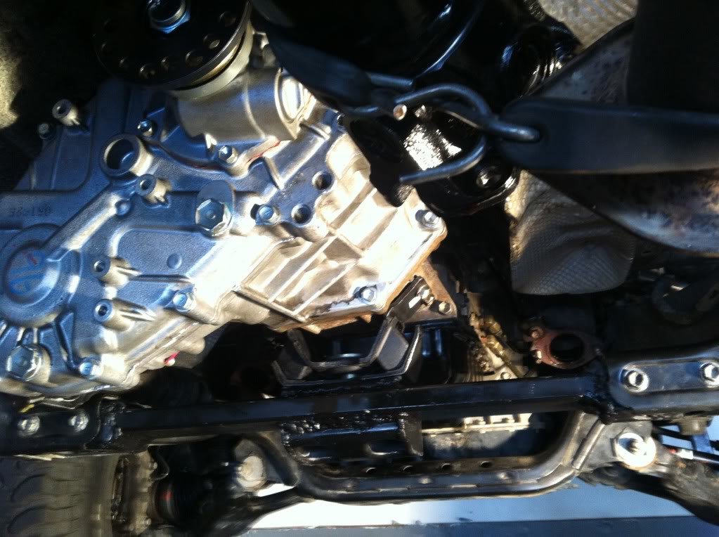

    6EFB88AC-D8B6-4998-AF11-021D0462D52C-824_936674f404db48f14626ca00f0a6963f8da2f82f.jpg

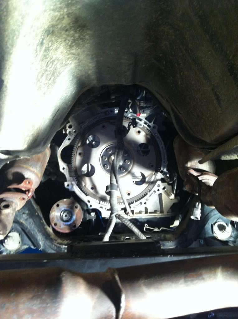

    First off I took out the tranny. The connectors, fluid lines, shifter leaver came off then took out the starter to access the TC to Flexplate bolts. Then unbolted the bellhousing from the engine to pull the tranny out.
    A81ED30F-F9FF-42DF-8510-4CBC97B2218B-824_e5e441ea43b7618a7290227dc985ce65d02f1062.jpg

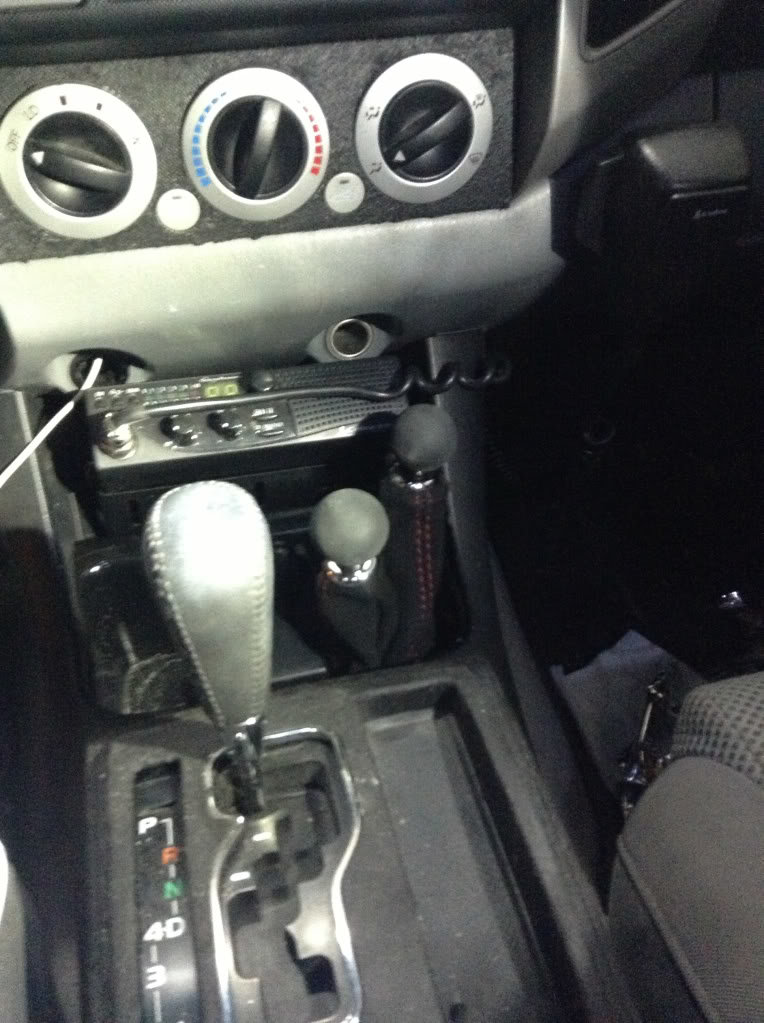

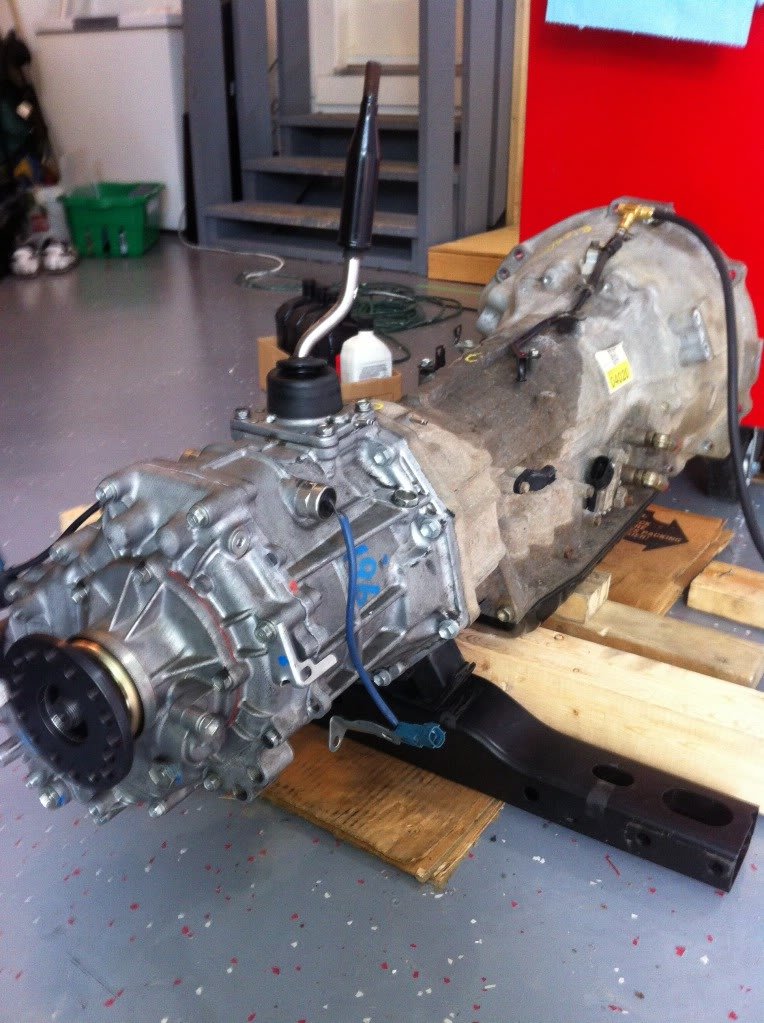

    Installed the new Transmission then cut the hole and sent my FJ Tcase home
    2754045E-2249-43EA-92C7-EA5AB18A23ED-824_dfa8fffe48d4bf1676fe71bce09fcf2202ef0ec5.jpg
    Have Twinsticks used for selecting the drive, left of for high, neutral and low and right for 2wd and 4wd. This also lets me utilize 2low for certain situations.
    bf65759e1a5eae0514299d1f2d82113f_zpsb9dd_c344dc45868479b1b9b15c19092570731d394ba9.jpg
    2737a4d44ea096f89a2717a0dd16870a_zps919e_3a0f4389c8945f7dc77fee101805c1884d5eb702.jpg

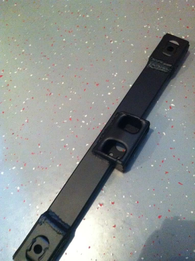

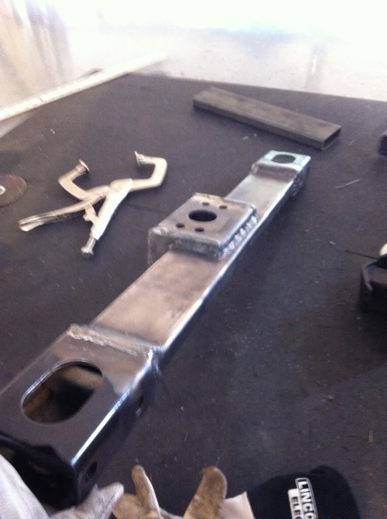

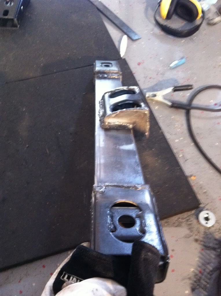

    The prerunner frame is different then the 4x4 so a custom crossmember is needed. The measurements were not the easiest to get. I used 1x3 steel tube, cut the ends off a 4x4 crossmember and welded them to the new. Then cut out the center section and added them mount. [​IMG]
    E6DCD80E-0DF7-4D43-B03E-F3A41F2400A3-824_2df9e2d906d7726881441e5c640b7836529b97c0.jpg
    E68840F1-B698-4286-BF37-36C954C62C64-824_6273213f59d310911ec8aa8f7a21ccd005f0e094.jpg
    7D141751-731C-41D8-BE09-8F220C55605F-824_fc4acef3707b69648daaf95517362743a2156ab0.jpg

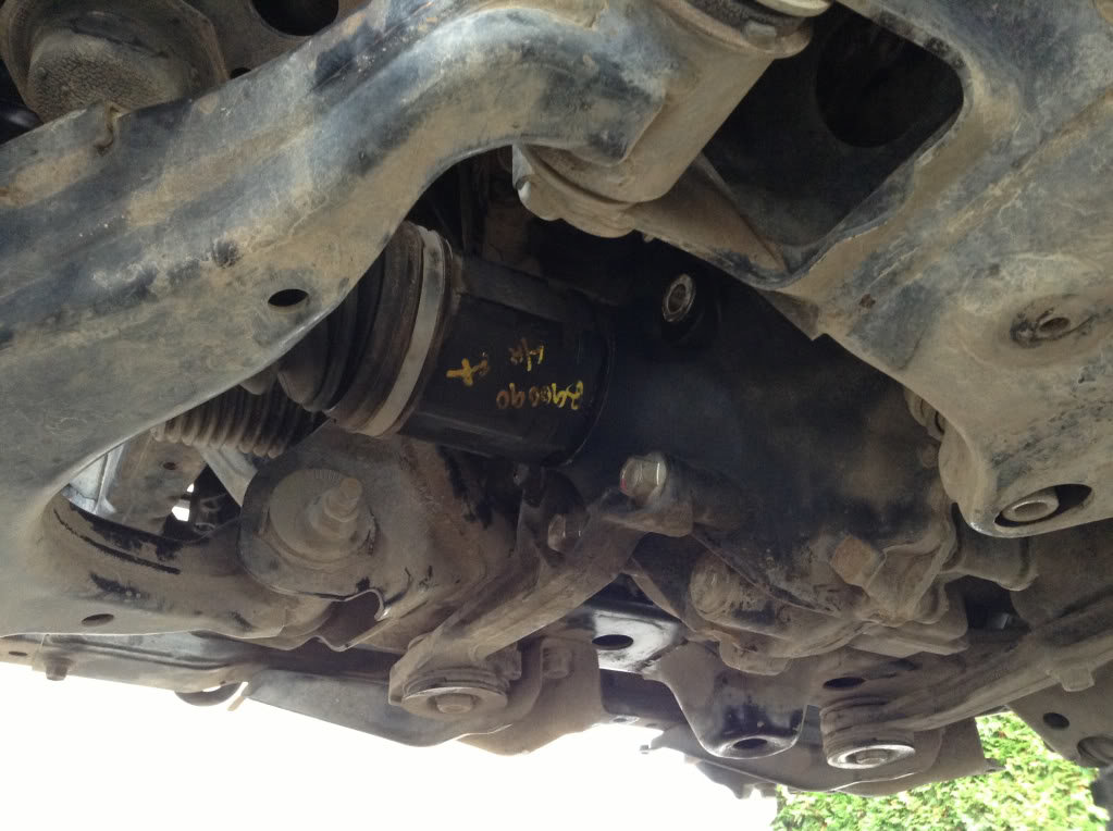

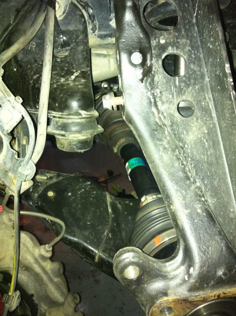

    The IFS stuff is pretty simple, front diff bolts to factory holes, no crawl box meant factory front drive shaft would fit. Gusseted the spindles, through in the cv's and hubs with seals. Wired up the ADD Harness, works great. Allows the front diff to function without the use of the ecu. Before switching into 4wd the switch gets turned on activating the front diff, then the tcase can be shifted into 4.
    6fc07230aaa4f944f9d2af3ea07b4677_zps84d0_3b8d88ea80824b0a1bfbcfcef2a1fe3243f22dd8.jpg
    226FBE5F-476A-4106-8EBE-33428F5DEB9A-824_f8c80123592ad5b0f1ffb712709f351d650ea981.jpg
    11C2E892-8F49-45B7-AB10-FDA0ADE65128-824_487d9e0c3e15b3f2cb6a507586a5f834ac60e12b.jpg

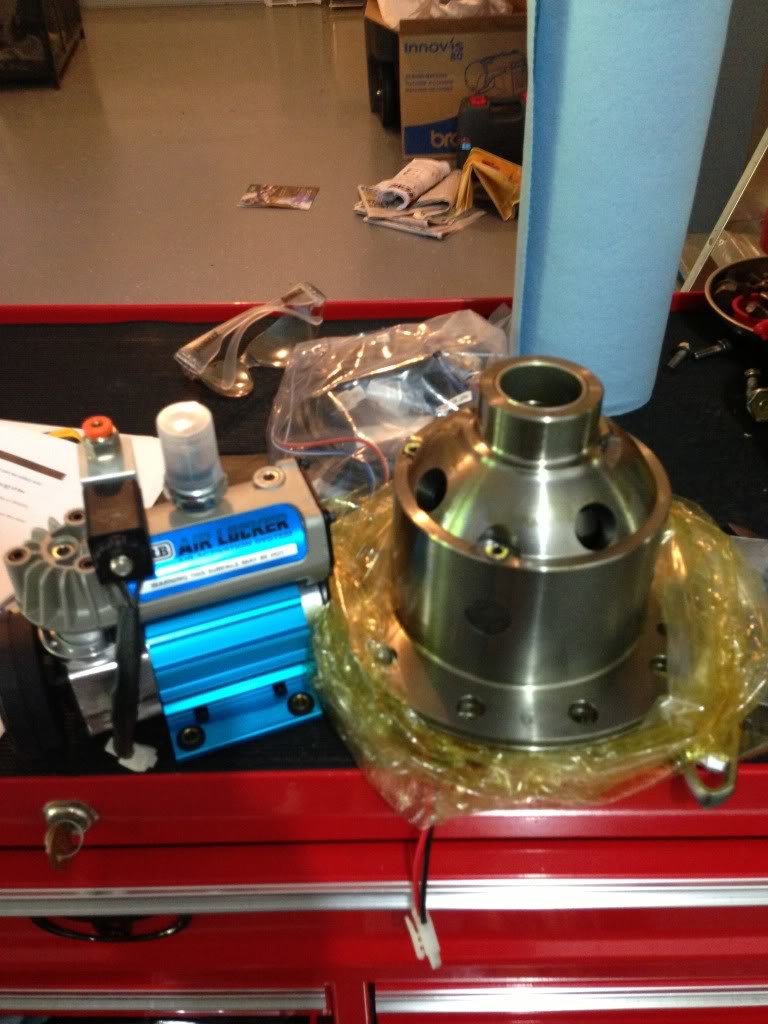

    At the same time as the swap I had my front and rear diff regeared to 4.56 and front locker installed. [​IMG]
    DF3083C6-582A-4090-ADCA-C3BAA14F13F4-824_674101591a54a59284750e05098fbb0c19af2963.jpg

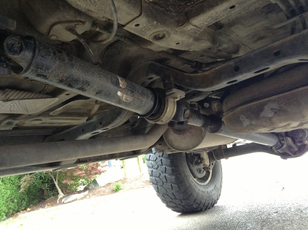

    For the rear drive shaft instead of buying a 4x4 shaft I was able to get my prerunner shaft cut down and a yoke and slip joint added. Cut the cost down rather than buying a new shaft and having to change the carrier bearing position, they are different on 4x4 frames.
    b8496a9477fb732a7a97e4da7ee22c32_zps17b5_c67e263bf0fcc4443b221d3978001d04be8f9911.jpg
    The last thing I got done was getting the exhaust relocated as It doesn't fit around the new tcase. You can see it in the bottom of the picture here, it is in the stock location now. I got it done by a shop. I will def be redoing it soon as it already has rock scars on it. [​IMG]

    how sketchy was it welding up that new cross member? i might be getting an FJ T case for $150...and now that i've found the ADD system to trick the actuator i'd actually be tempted to try to convert. the only thing that scares me is rewelding a new cross member like that
  12. Aug 3, 2013 at 8:40 PM
    VanCity4x
    VanCity4x [OP] The shit show
    Aug 1, 2011
    #60970
    1,408
    DJ
    BC
    05 Prerunner SAS
    3link 1tons on 40's and sum stuff
    Thanks man, put a lot of work into it.
    It was difficult to measure out the spacing for crossmember and I was still a little bit off. I spend at least 10 hours cutting and welding it. My advice, buy the 4x4 tail housing and inchworm adapter, would make it a lot easier.
    The FJ tcase is also very difficult to install on a automatic, the shifter comes up right underneath the transmission shifter. I'm working on fitting my twin sticks, another very difficult process, have gone through 3 different figments for sticks and still doesn't fit right, will prob take a few days more. :annoyed:

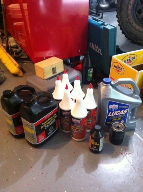

    Changed coolant, front/rear diff fluid, changed tcase to synth, engine oil, bled brakes and added tranny fluid, was a bit low.
