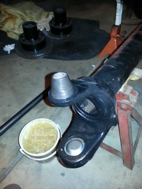

    Thats the only thing I am bummed about. If I hadn't just bought brand new 37" KM2's last year I could buy whatever tires I wanted. I am keeping my eye out for a good deal but its hard to sell your tires at the drop of a dime when a deal pops up.
    Both those king pins are toast. Any pitting is bad and look for wear too. Those look like they were dry at one point and began to rust.
    They're not really that bad to get out, I just did mine when I tore my axle apart a month ago.
    Heres a shot of my a new one for comparison, its covered in grease but the surface is a pretty good one. Not mschined but perfectly smoth.
